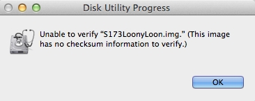

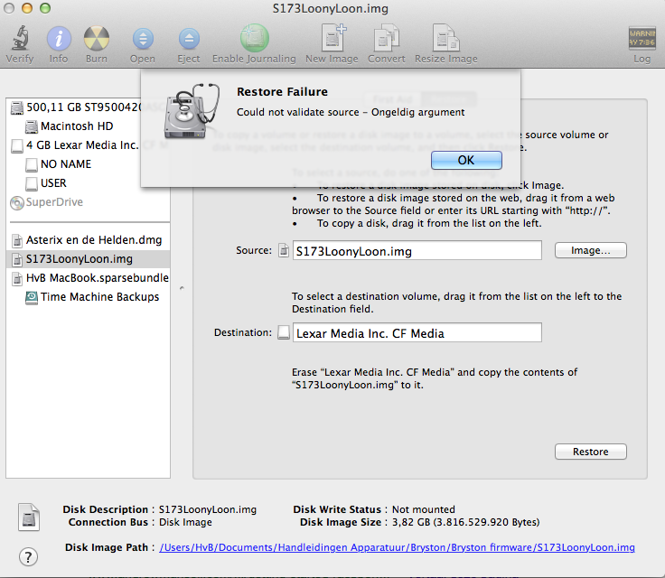

Wim, did you load the latest beta firmware? the one that corrupted to error 09 in the first place, or is there a newer version already?
And then: the corrupted CF card has 2 partitions: No Name and User. Where to write the new image to? Disk Utility on the Mac is somewhat different from what Chris describes in his manual with win 32 disk imager.
Diskutiliy gives this unfortunately:
because of this:

Hi Marius,
I have posted another document explaining how to use a command line tool to restore the image.  Let me know if it isn't clear.
Chris

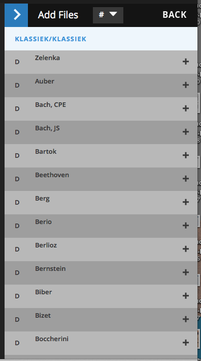

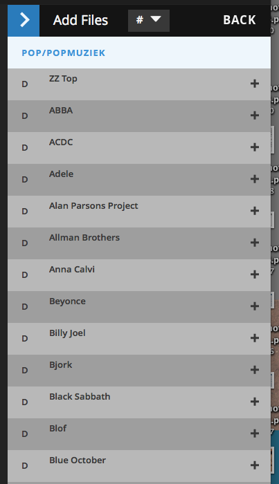

« Reply #138 on: 15 Dec 2013, 05:21 pm »
HI Chris,
Playing through Manic Moose is not as easy as through Mpod yet, but what's most remarkable is that every Media-listing on the right side browser has the last entry first.. :scratch:
or
not so on mpod/mpad...
Marius
