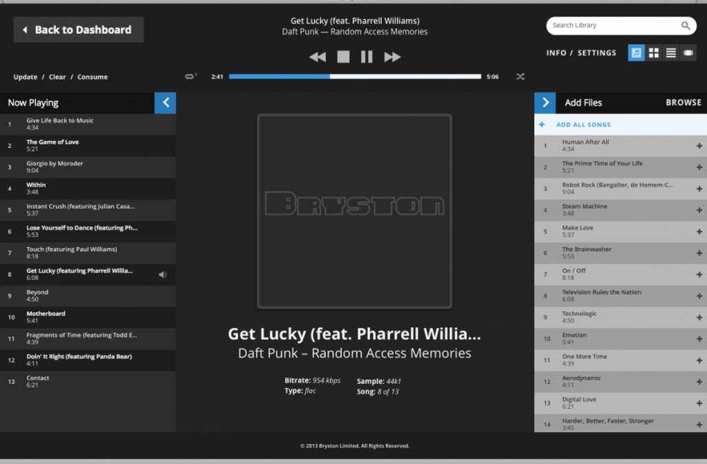

Is this what you mean with the 'personal information left in the cache'?
Keeps popping up in my Manic Moose:
Never heard of Daft Punk.... my loss or not.
Anyhow, Chris, please why is this showing? Could you clear it up?
Marius
A couple of minor things with the upgrade
* 12V trigger effectively disables the front power on/off button.   I would update the text to reflect that...
* When you want the user to restart the BDP, I would just display "please reboot now" or something like that.  I didn't know if the BDP was about to restart or if should have restarted it. I gave it some time before i powered it off.
* There's a lot of your (not mine) personal information left in the cache.   You should clean up the album art, NAS, drives etc.  Disable DLNA, etc, etc... even for a beta.
* Also it might be useful to provide a way to purge the browser cache after a reboot.   Some sites allow you to append the ?action=purge at the end of URL to do that.   It took a while for versions to update.
And some more notes:
*thanks for providing 'less'... now only if we can push you towards vi as a default editor (emacs is my preference but like nano, unnecessary consumes diskspace)
*The web interface seems frozen in time a lot, not unresponsive, just not updating correctly . the cancel and save are in odd spots too, not sure if it's related to the song/playlist or to the setting operations at hand with the update/browse buttons
**The media view is still showing the daft punk.. is this expected or just need to wait for mpd to finish updating?
*What is launch alert, application updates 1,2,3 ?
*The .albumdb folder might be better as a hash/md5sum.. which would also save on diskspace... (might model git here).
The interface seems much faster and can't wait to see the kinks worked out, so kudos there.

Please implement the keep alive function asap. the BDP keeps getting back to the DaftPunk page after a longer period of inactivity, and a reboot (which is only possible through the bdp itself, not the software) is the sole relief.
While your at that: the login for lat/fm seems crippled yet. is that correct? It now logs in as bryston, which seems a bit unsatisfactory in the privacy-department. I don't want any activity to be logged at all.... not even as bryston ;-)
in a very short view, I saw a button on the initial page 'Play' with one of the attached drives' name. it disappeared again toe be replaced with the for placeholders for Launch alert model and application update 1-3. it did work. Confused the interface through Manic Moose (Daft Punk back again), but on my Mpod saw all tracks of this 2 TB harddrive...... Better build in some warning.
Is this expected behaviour for now?

The Play <drive name> is a intended addition, the idea is your buddy comes by, you plug in the thumb drive, wait for it to update the database, click the button, it adds the contents to the playlist and starts playing the first song.  The downside is if you have more then a few hundred songs on the drive; the playlist is to large for most devices to handle the large playlist that gets created.
