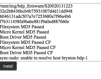

tried it 4 more times. latest iteration gives:
What it the wise thing to do...
Marius
that should be a successful installation of the firmware,
the first line is the location of the upgrade with a full valid path
the next three lines are the three md5 values for the firmware and boot files
the next six lines is the md5 checksum before installing to the cf card and then after installing to the cf card
At which point the bdp should reboot on its own, usually within a minute or two.
Chris

Marius
Re: Manic Moose (S2) - BDP's third major firmware release
« Reply #173 on: 31 Dec 2013, 03:16 pm »
Check,
update succeeded.
What about the last line though? Just curious to know what it means.
Marius

Check,
update succeeded.
Marius
Hi Marius,
the last line is produced by the sync command, it ensures that all writes to the cf card are final before doing a filesystem check, if something is found in the filesystem check it would be printed after the sync the command.
Chris
