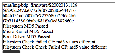

updating to firmware 26 give this, it won't install:
What to do? Tried dl'ing it again, to no avail. There's no vmlinuz in this download? the progress bar stays empty on it.

Hi Marius,
Log in via ssh and enter the following commands:
fsck.vfat -r /dev/sda1
reboot
If you could email or post the results of fsck, that would be fantastic.
Cheers
Chris

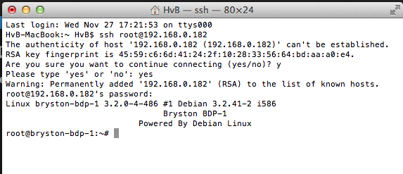

mail sent, with all kinds of ip-spoof warnings.....
please help!

that was the trick, i forgot to ssh as root...
here goes:
[email protected]'s password:
Linux bryston-bdp-1 3.2.0-4-486 #1 Debian 3.2.41-2 i586
                                Bryston BDP-1
                           Powered By Debian Linux
root@bryston-bdp-1:~# fsck.vfat -r /dev/sda1
fsck.fat 3.0.23 (2013-10-15)
Reclaimed 215938 unused clusters (884482048 bytes).
Free cluster summary wrong (0 vs. really 215938)
Perform changes ? (y/n) y
/dev/sda1: 52 files, 283281/499219 clusters
root@bryston-bdp-1:~# reboot
cheers,
Marius

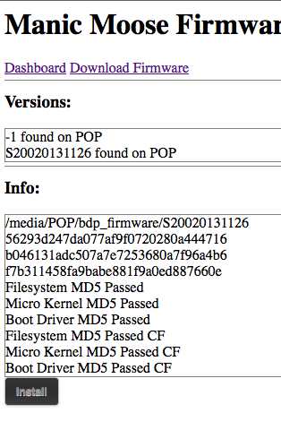

I was able yes, it worked (took me a while to realise the updating had finished, cause there's nog progress indicator....) even pressed the install button again, no warning issued ..
Still, im not able to browse the bdp in Mac Finder anymore, and ssh 'ing  gives me the extreme warnings i mailed you before, when using [email protected] , and gives this, when using the [email protected]

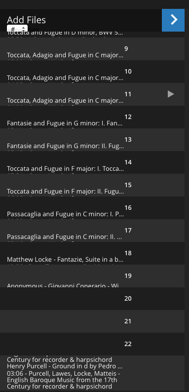

When you get to it, check the way Manic Moose displays the playlist please?

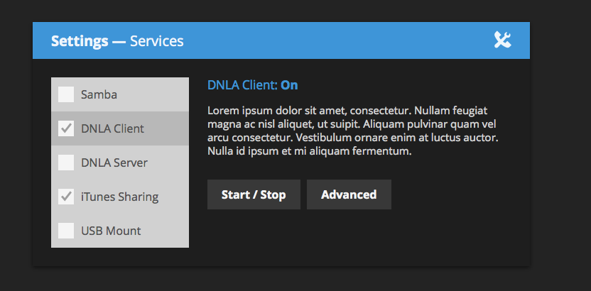

Things are getting better and better. On the MPD page you said settings are done now, but when i select MPD Watch and Apply, Im thrown back to MPD version 15.2 and bryston appears again on the last.fm login page...? Those login credentials still don't stick btw. Something's not right.
And, Shairplay: I seem to be able to select it on clients machines, but, nothing happens on the BDP side, and, sometimes i have to disable shairply altogether to be able to play anything again. That is to say, have the bdp make any sound. It seems to play alright, all progress bars are moving, but no music is played. Unselecting shairply then makes it work again.
