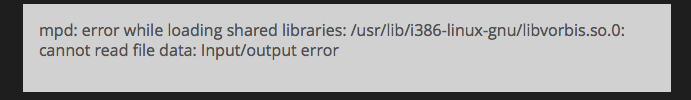

And then this happened, What to do?

The NAS setup interface is still in early development and has yet to be settled.  One of the current problems in loony loon is that it's unable to interpret the list of shares returned from some NAS devices.  The idea of having the text boxes for each piece of information is to allow the end user to enter and change any variable before the share is added.  Finally the password is kept in the clear to prevent accidental incorrect passwords from causing problems.
I'm not sure why your getting that error message, I'll have to take a look at it when I get back to work next week.  The new method for identifying the scratch drive is a file on the drive with the file name .bdp_scratch.  This may change as I have yet to test how reliable this method will be.

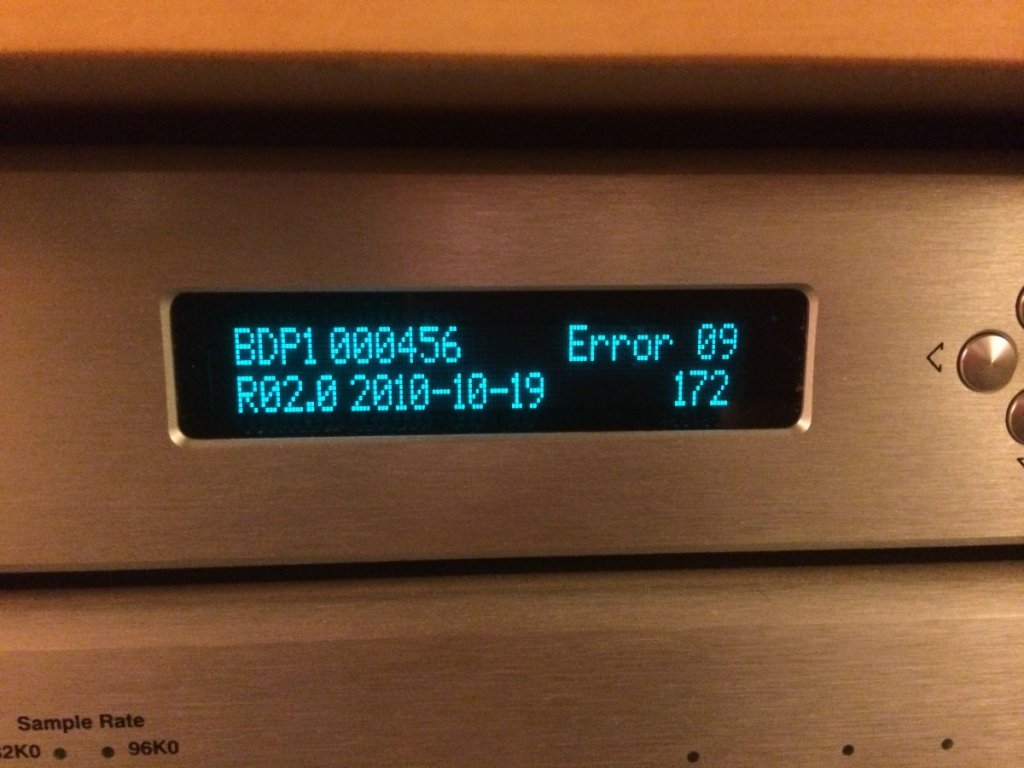

H chris,
after updating to the latest version, this is what I get on the BDP's display:
My BDp won't move, or play, hard and soft reboot. Plug and unplug.....
checked again, rebooted by unplugging, with and without drives attached. No response, To buttons and/or Mpod/Mpad. Nothing in Mac's finder. The update sure broke things this time  :cry: :cry: :cry:
Chris, please, what to do?
Marius

Hi Marius,
Does the BDA lock about thirty seconds before the error 09 message and then loses lock?  Or no lock from power on to error 09?
Either way you'll need to reflash the cf card using the instructions in the PDF file posted under how to get manic moose.

Hi Chris ,
It boots, displays Initializing, with the accompanying progress dots, and then
 locks. I tried pushing buttons, no effect.
Could I also try an older flashcard I have in an other Bdp motherboard?
I am on a Mac, instructions are Windows only.... Any suggestions to a good Mac app? Maybe diskutily can do this too?
Important: What caused this error 09, and even more so; what will prevent this from happening again, when upgrading the firmware again?

I'm having exactly the same problem !!!  Also after the latest firmware update .....1204
Error 09
UPDATE: I reloaded the  LoonyLoon but it gives me the same error 09 !
Looks like the update bricked my BDP1,....   :nono:
UPDATE 2 : I repeated the whole procedure and hey it's working again (on LoonyLoon)  :scratch:
UPDATE 3: the moment I load ManicMoose again (folowing the procedures) It gives me 'error 09' again.  :duh:
