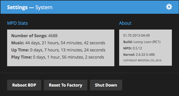

« Reply #209 on: 18 Jan 2014, 08:54 pm »
Chris,
on updating to version .17, MM shows version 2013.04.09 again..... :scratch:
Is it the update that went wrong, or a version mistake in the latest firmware ? Process report was al checked in order.

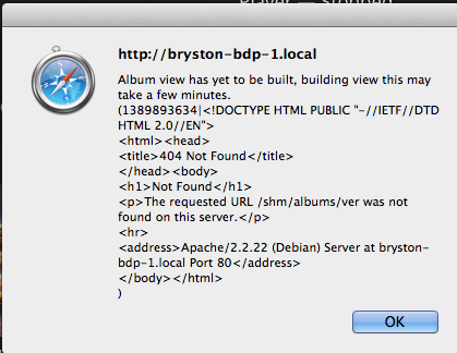

clicking Albumview gives this every time:
last time it went to 17% building creating Albums, then it hung again. Had to reboot, and start all over...
removed one of my harddrives, to see if that might help. Strange thing is the removed drive still is shown in MM, and i can select tracks  :scratch: :scratch:
not finished yet im afraid.

« Reply #211 on: 18 Jan 2014, 10:02 pm »
yesterday I clicked AlbumView, and it started the sequence you described. Only to hang on 6% adding albums to BDP. Had to restart to get my BDP back to respond to anything, restarted the Album building and it still hangs, and is not available to anything on the network. Finder, MPOD, Manic Moose, nothing loads. Have to reboot again i guess.
Could this have to do with a rather large library, and the fact BDP1 only has a limited amount of memory? Diskspace is in available in abundance...
M
Hi Marius,
Could be the number of files, but unlikely due to how the "database" and files are generated; however I will test it with the larger 38,000 song database at work as it seems to work with my database at home (4,000 songs) with my BDP-1.  One thing I have noticed with the BDP-2 processing my work database is a few times on the second half it pauses for 15 or 20 seconds.
Perhaps if you ran the command manual after making some minor edits to the program, the BDP should be sharing its filesystem from the root as a share labeled "ROOT".  open the file found at /var/www/mpd/albums.php; line 143 should be empty  and will be just after
Code: [Select]
logDone('Sorting music into Bryston DB:'.round($songsDone/$songCount*100).'%<br>'.$file);
add
Code: [Select]
echo $file."\n";
on line 143 just below the logDone line
then go down to line 242 which i think is also empty and again should be just after a logDone call and add
Code: [Select]
echo $album."\n";
This should tell us where it crashes if its something in the database causing it, then hopefully we can fix.
Once done editing the file open two terminal windows and ssh into the BDP from both of them.  In the first one run the "top" command, you'll use this to monitor resource usage while the albums.php program runs.  in the other terminal window issue "php -f /var/www/albums.php" and your scree should fill up with output and display that last thing it was working on and how much of the memory was being used when it crashes.
Alternatively to all this you can place the BDP into service mode and i can take a look at.
Chris

The date is programmed in by the build script that generates the squashfs file, so human error is no longer an issue.  If an older date is showing it means one of two things, the update failed or the browser is grabbing the date from cache.  I forgot to ask in my last post, how big is your database? as it sounds more like a resource issue then a content issue.
Chris

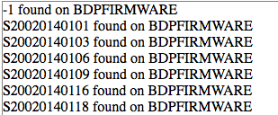

« Reply #214 on: 18 Jan 2014, 10:57 pm »
Nope, not a cache problem, i always clear that before and after upgrading.
Updating shows the correct feedback, with only the last line reporting an error, like i posted before.

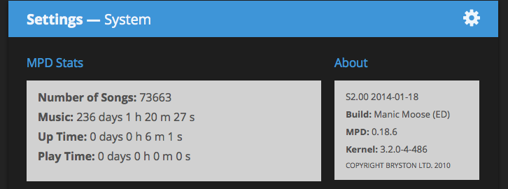

maybe this gives a clue on the Album DB issue ?
weird thing is, Ive upgraded to .18 version successfully so it seems. and MPD is at the latest version 18.6
But when i click any command that has to do with the album db or views, im thrown back at
and MPd 5.12, and all default fillers are shown, including the wonderful Daft Punk all over the place  :D

« Reply #219 on: 19 Jan 2014, 04:14 am »
the above is expected, its the message that will be normally displayed followed by the contents of two variables that are compared.  The content of the two variables will not show in the final version.... assuming I remember to remove them that is.
if your getting the above it simply means the main javascript has crashed, you should check the developer console for error messages.
Marius
by resource issue i was referring to the BDP running out of memory, processing power or disk space.
Chris
