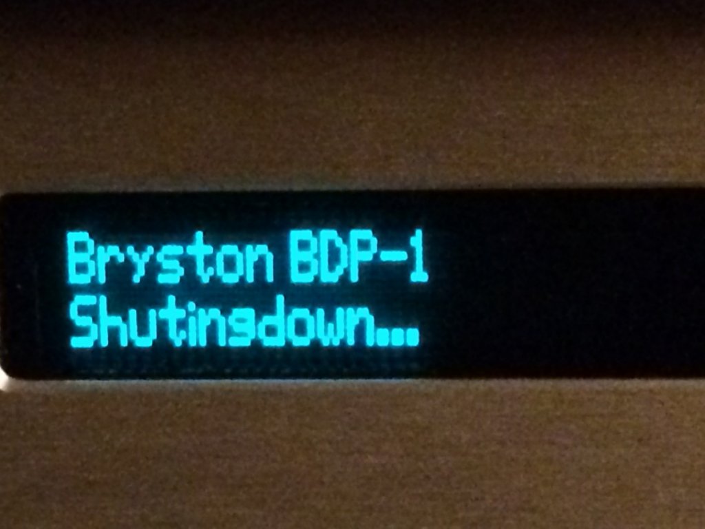

a lot of network issues later, I've got things up and running again. Still, manic moose does seem to interfere with the network functionality somehow, never experienced this before. Had to hard-reboot the Synology Nas for it to be released and read again by the network.
Thought to power down the BDP via the Manic Moose button. After a while went to my auditorium where it's situated and this was on it's frontpanel display:
Shuting down.... a manual (button) power down was still necessary, thus making the software power down in system settings futile i guess. At least on the bdp1.

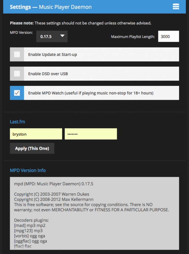

You might also want to check why BDP/ManicMoose lists my Synology Nas on Mpod, without any files on it, doesn't show it in the Nas section of Manic Moose (thus making it impossible to unshare...), and kills all interaction with it in Mac finder....
Please...?
Marius
Regarding the NAS ycould you double heck what version of MPD is being used?
Cheers
Chris

Sure,
this is what it shows, don't know if its fake or not of course, maybe ssh (you'd have to tell me the command please..) and be sure?:
Cheers
Chris

« Reply #154 on: 20 Dec 2013, 10:24 am »
Same here; Running mpd 0.17.5, and also problems with web interface becoming unresponsive and not showing correct info. A problem that I have seen in every Manic Moose release, incluiding the latest. I was hoping the rewritten web-interface would solve this  but this is not the case.
