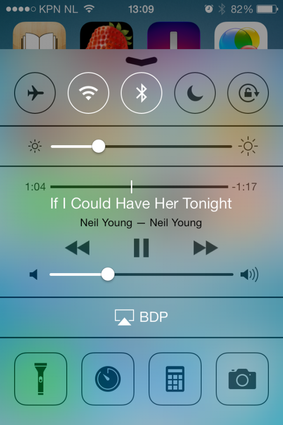

HI Chris, all,
2 more for the weekend:
-latest build changed my Last.fm login to bryston. Not able to change it.
- I accidentally found out airplay found the bdp  :thumb:
But how to make it play on the BDP?
Cheers!
Marius

Hi Marius,
Ok I see now, those files are created during the repartitioning of the internal compact flash drive and are no longer needed once the BDP is up and running with Manic Moose.  Firmware that is downloaded using manic mooses web interface after the fact will go into a folder labeled "bdp_firmware".
Although you can't restart samba or change the password, it is enabled by default.  DSD over USB is automated however it's likely that you dac isn't in the list of known dsd capable dac list which consists of any dac with the letters "dsd" in it's name and the one other listed in the README.  If you send me a copy of your mpd config file (mount the root samba share, /etc/mpd.conf) or place the BDP into service mode and send me the service number I can log into it and get the detected name.  Once I have the name I can add it to the list, or you can wait until I get that far with the development of the web interface.
I havn't gotten to development of the playlist page yet, your existing playlists should be safe though and appear once we have gotten that far in the development.
AirPlay still needs quite a bit of work, it's based on shairplay, however because we have multiple playback program running they tend to interfere with each other.  So a script is going to need to be created to monitor whether or not shairplay can open the sound device, if not to then free up said output device.
Chris
Ok, again, will wait for you to be ready. Just wanted to let you know it shows in the IOS interface.
