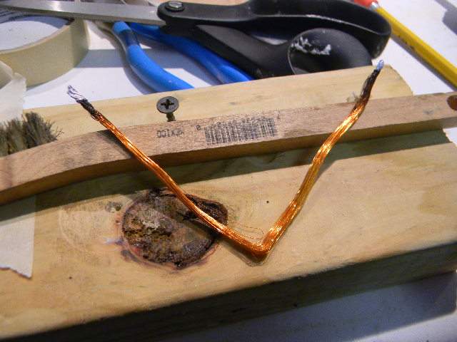

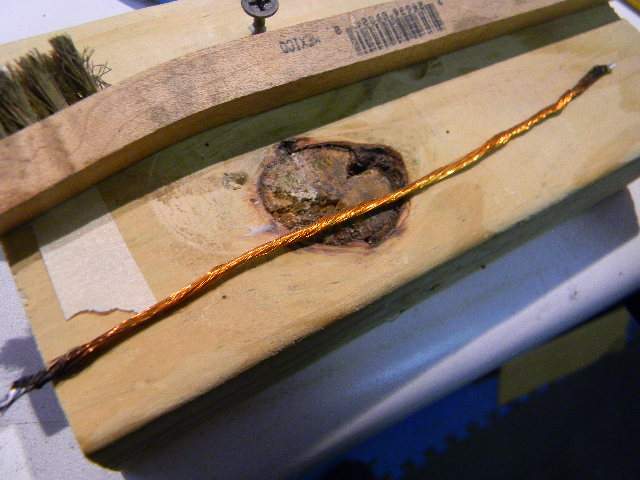

I would use the #36 AWG wire, especially if the label refers to it as #36 SN, or single coated insulation. You will need 88 strands and six inches to come close to what I use. There will be a slight increase in RAC but not enough to have to make big changes to accommodate.
Stick two smooth nails, 3 inches apart,  into a block of wood and cut the heads off. Tape the end of the coil wire next to one nail, to one side and a little beyond the actual nail and wrap the thing around both nails 88 times. Then place a 1/8 inch wide strip of crepe paper masking tape over all of the wires on one side of the post where you taped your start wire down, just to the inside of the nail. Then gather up the start wire and tape it and all of the other side wires together on the other side of the nail, just to the inside of the nail, away from the actual loop curves. These should be a fairly tight bundles and both at the same end where the start wire and end wire ended up.
Here is the solder pot:
$30 from MCM
Kinda skanky, the dross on top:
Yes, there is solder in there:
Set-up at 3 inches using drywall screws:
88 wraps of number 36 magnet wire:
Remove the loop of wire and cut it between the two, relatively close together tape wraps. You should now have a 6 inch plus length of cable . You cannot emulate a Litz type 1 twist, but that should not present a problem. Tin the open ends of this cable. Use a liquid flux if you have one and cut it with 99.99% pure isopropyl alcohol from your local drug store until it resembles weak tea in color. This mixture will ablate the wire insulation and tin the wires very quickly. Dip it past the tape and when the brown goop stops rising, remove the wire and wipe it in a double folded cotton shop towel from just above the solder to the cable end. This will squeeze the excess solder and burnt insulation out, leaving an ugly spot on the rag.
Do this to both ends of the cable.
Here is my concoction of acid flux and methanol - all I had handy:
Taped and cut and ready for dipping:
There's the ugliness after burning off the coating and partially soldering the ends.  I re-dipped these again after some paste flux:

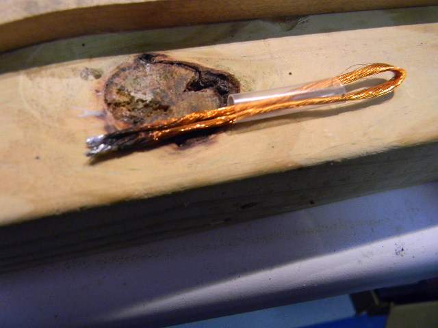

Twist the length of cable at least two full turns down it's length and try to keep it from untwisting (not easy). Now take an appropriate size of shrink tube and cut a 0.9 inch piece off, fold the cable in the middle and slip the tube over the two parts. Then solder the two dipped ends together and attach them to a short piece of tinned copper wire, either solid or stranded and go hook it up to your speaker ground lug. Make two of these of course.
Here is the before and after twist:
And a clear piece of shrink tubing prior to shrinking:

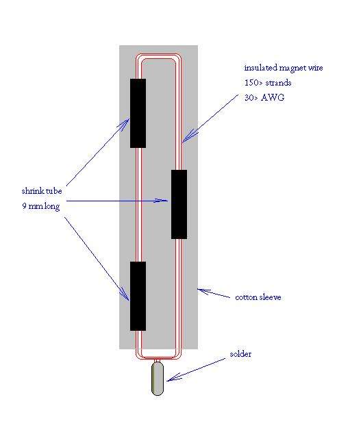

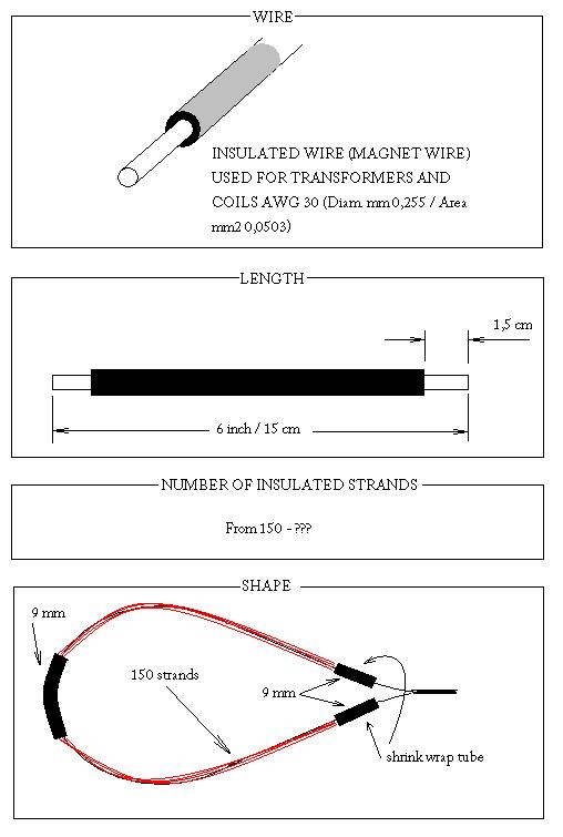

Pete,
I think you're going to be reworking that shrink tubing.  As far as I understand it, it should be as this image from DIYAudio:
http://www.diyaudio.com/forums/parts/102180-groundside-electrons-22.html#post1753094
BudP
  • Posts: 77
Re: The BudP DIY Speaker Ground Tweak
« Reply #182 on: 27 Nov 2010, 01:47 am »
You can use the simple shrink tube. The multiple pieces do allow more finesse.
Wire looks fine. The ugly will go away when you get some liquid flux and 99.99% pure alcohol. You might try getting a sample amount from Kester.
Bud
TooManyToys
« Reply #183 on: 27 Nov 2010, 03:12 am »
It looked from DIYAudio like it was trying to be kept in a loop, or at least the two lengths separated.
Big Red Machine
« Reply #184 on: 27 Nov 2010, 03:28 am »
The instructions say to wrap it around both parts.  Essentially you have a loop.  And then they look like the retail part.
Big Red Machine
« Reply #185 on: 27 Nov 2010, 03:43 am »
If you read a little further into that thread:

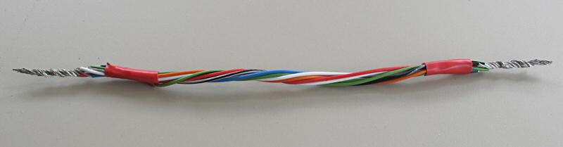

Here is my DIY version for one channel. It consists of 12 twisted pairs of Belden Datatwist 1577A
formed into a 6in. loop and the stripped ends,all 48 of them stuffed into a spade-lug with a gas tight crimp. I have to make another one for the left channel and then do some serious listening.
 Preliminary impressions are that the right channel may render decay and the size of the acoustic space the sounds originate in a little better,no night and day stuff yet and zero brightness problems.
Scotty

« Reply #187 on: 27 Nov 2010, 11:45 am »
Pete, I still consider that second one a loop.  I did see that and that's why I wrote "or at least the two lengths separated.".
The image later in the thread shows the shrink wrap skipped, but still insulating the conductors.  My main concern of your first pic with the shrink wrap was you were going to have both conductors shrunk together touching.

« Reply #191 on: 27 Nov 2010, 06:37 pm »
For insulated wire you can collapse the loop. You can use one piece of extra insulation or three. The only other thing to be aware of here is that without a true Litz lay up you do have an antenna. The twist helps a bit but you may still get some RFI from the diy loops. However, to date no one has advised me of any problems with RFI reception.

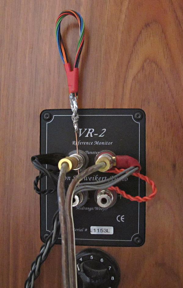

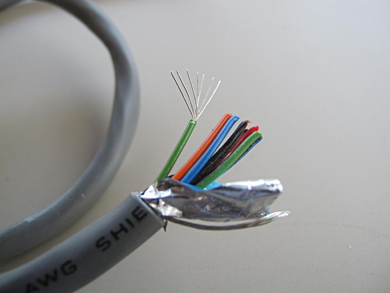

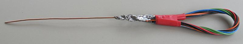

For my quick and dirty test I used 2 - 6" lengths of JSC Wire & Cable #6669, 12 conductor, 22 (7/30) AWG wire.
Bud's proof of concept test is 2 ft. of #16 AWG lamp cord, in a previous post Bud suggests using 88 turns of #36 AWG magnet wire which is close to the area of 16 guage. I split the difference and used 8 out of the 12 conductors which calculated out to 1 ft. of 16 AWG wire based on the American wire gauge chart (below). The bundled wires were soldered to a straight length of 18 AWG copper.
I will listen for a few weeks then remove the ground enhancers. Right now I may be hearing more low level info and depth but time will tell if my brain is playing tricks on me again.

WGH,
When next you make a loop, use a bit less dielectric material and probably something unshielded too. That's a lot of plastic you have there and it does turn out to be a combination of surface area and dielectric constant / dielectric absorption. You want some really low value plastics in these things.

« Reply #197 on: 28 Nov 2010, 10:06 pm »
For my version #2 I removed all the extra stuff. The wire is still 8 strands of 22 (7/30) AWG JSC Wire #6669.
Back to listening.
