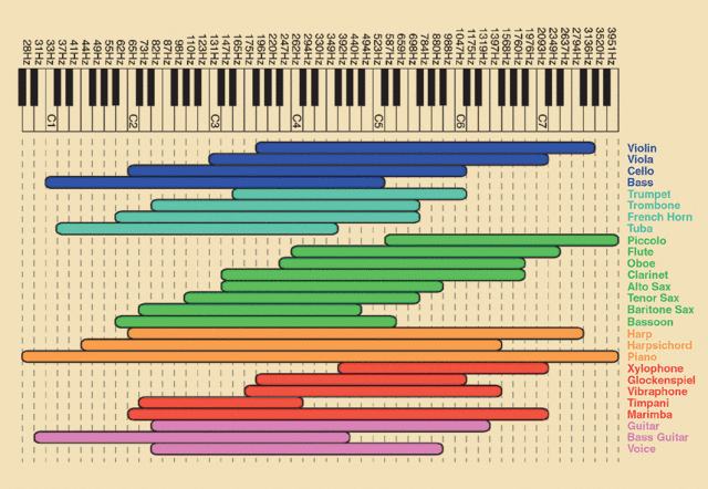

Here is another chart that shows down to 25Hz
