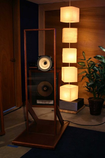

Quote from: JoshK on 2 Jan 2009, 02:31 pmThat is going to be a bit difficult to do with hi-eff. Its an outgrowth of Hoffman's iron law that small size (in this case driver size), hi-efficiency and low extention (100hz) can't all be achieved at the same time.Josh, I have to respectfully disagree with your theory. In real life, I'm crossing my Lowther PM2As at 125 and getting mid-bass a plenty. picture: http://www.audiocircle.com/image.php?id=16556 Poll any of the GAS guys that have been by since I finished the OBs and they'll let you know they work. In fact, MeRev (Chris) is building an identical pair he likes the sound so much.Kyrill, if you want real HiE, think about the Lowther PM2A or the PM6A. Not only will you get to 2K, you'll get out to almost 14k. Of all the Lowthers I've listened to over the years, these two models are their best offerings . No 'honk', no 'shout', plenty of detail and extension. When mounted in a baffle like I've constructed and in a room where they can breathe, they throw a monstrous soundstage. Not to mention, you can drive them with any amp you choose to buy from SE 45's on up. Be prepared though, these things aren't cheap nor are they fun to listen to until they get fully broken in (500 hours as a bare minimum and 2K hours they loose the last of their bite).
