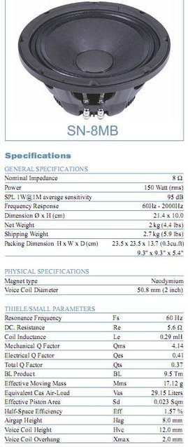

SO what now?
Danny from Gr-Research is very enthusiastic for the Paudio BM12-CXA.( http://www.audiocircle.com/index.php?topic=61023.0)  But i hesitate for such a big speaker to do the mid range. I really like drivers which stop when the music signal stop. the lighter  the driver the more this happens ( with a good strong magnet) So this explains my wish for an 8 inch driver
Shall i go for the SN-8MB from Paudio's new SN II series? http://www.paudiothailand.com/
I cannot listen beforehand.
