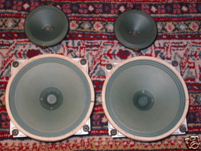

i have bought on Ebay the following drivers:
SABA 20 cm greencone "OB" drivers
I didn't really need the tweeters but they were one buy. The Alnico magnet tweeters though, do fire backwards, so for OB , interesting...
I got the tip from a website to use them but helas  :oops:,  i forgot to bookmark it.
If these will not sound satisfactory i will "jump" to Danny's ( Gr-Research) Paudio OB "discovery"

What about the good ol' Visaton B200's?

The 13cm greencone tweeter rolls off quickly at 16kHz, it has a very uneven frequency response and it distorts quite a lot. I would rather recommend a nice 1" compression driver with a horn/waveguide if you need a tweeter. Even if it's not a dipole like the saba.

I only want to use the 20 cm SABA between 100 hz and 2 khz  and no use (yet) for the tweeters

Hi Kyrill  Nice looking drivers!
Go to the Lampizator site for tips on how to use them.  It's easy.
http://www.lampizator.eu/SPEAKERS/PROJECTS/P17/Endorphine%20from%20Kingston%20Kitchen.html
http://www.lampizator.eu/NIRVANA/nirvana.html
Please let us know how it works out. =)

Panomainiac "found" my lost web site, yes that is the one I read
but i see a warning
the Saba greencone must be an alnico midbass, the ones i just bought didn't mention the alnico..
So i wonder if 20cm Saba greencone NON alnico do exist..?
Ah another name for Tigges + Alnico is Permadyne, (?) and I bought  the Permadyne variant..

I like the  Sabas. I bought a pair some years ago, and never listened to my Lowthers PM6a since.
There are different kinds of Saba, and off course they are not everybodys taste.
http://home.arcor.de/pfaue/klangkue/gruenwunder/galerie/galerie.htm

i asked my E seller if the greencones i bought were Alnico and he reponded
"Helo Kyrill,
the greencones from the '50 years are always with  alnico magnetics, the
Tigges Factory was famous....
regards
Wolfgang"

Hmm, not quite. Around 1957 they made a switch to ferrit magnets. If you have the Tigges version it is probably from around 1953 to 1955. Later there where no name on the magnet maker, but still a alnico version.
