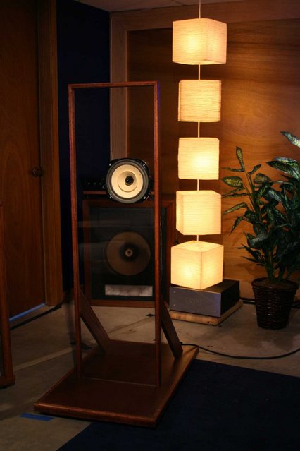

Josh, I have to respectfully disagree with your theory. In real life, I'm crossing my Lowther PM2As at 125 and getting mid-bass a plenty.
picture: http://www.audiocircle.com/image.php?id=16556
Poll any of the GAS guys that have been by since I finished the OBs and they'll let you know they work. In fact, MeRev (Chris) is building an identical pair he likes the sound so much.
