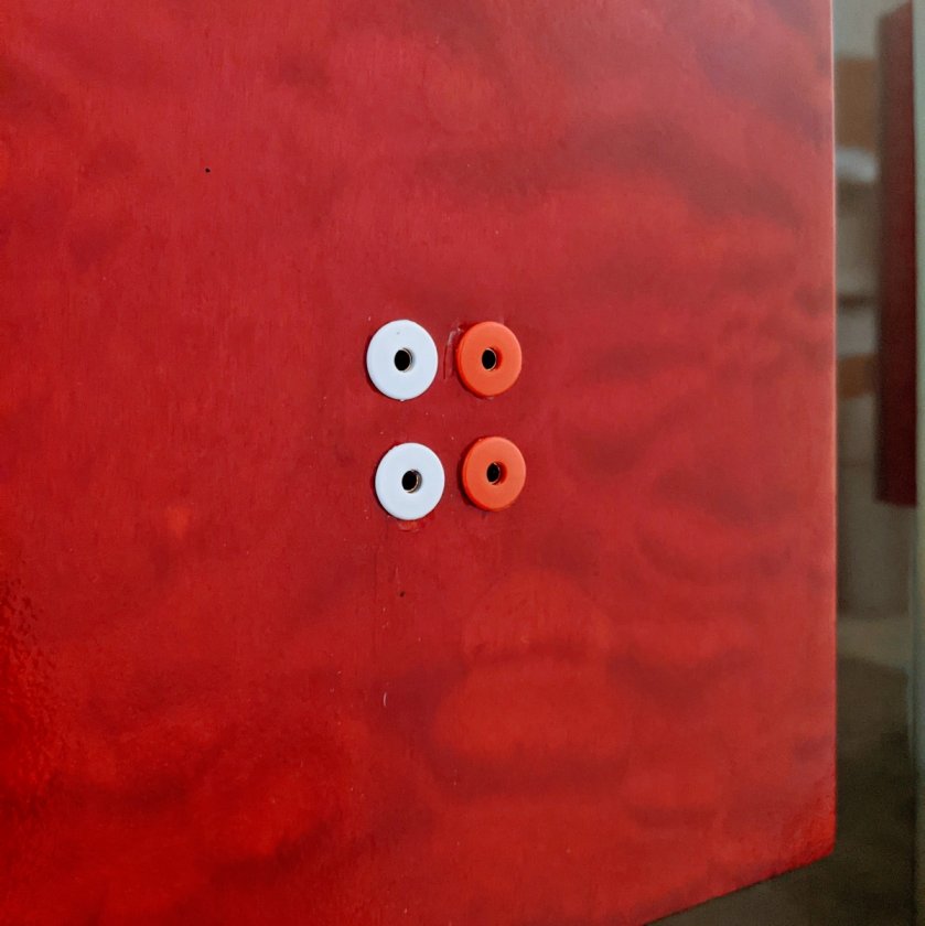

Excuse you, it's bi-wiring AND bi-amping :wink:
Oh don't worry, this whole setup uses a whopping 5 sets of tube connectors. 3 for the crossovers and 2 sets for the speakers...
I could have made it 3 sets, but I wanted the ability to swap the lengths in the future as needed. Plus I can test out different crossovers which I plan to do with my "el-cheepo" pair that are 5% roughly the cost of my "Overkill" crossover... lol
Small gauge wire, steel banana plugs, tiny 22 gauge zipcord...
All the things i shouldn't do  8)

It was essentially as follows:
Foil inductor upgrade
600V KPCU01 Miflex cap & 0.1uF Miflex bypass
Path Audio resistors
Miflex 0.1uF cap bypassing the cap in the woofer circuit,
The only thing stock about them is the sonicap in the woofer circuit.
I didn't really do anything different with the crossover or cabinet other than making it so I can change the length of the wires and swap out the crossover.
If i were to do it again, i would go with the smaller 250V KPCU03 version thats roughly half the size & a single path resistor that is "close enough" rather than doubling up half values to get the exact value so I could still fit it inside the cabinet.
Oh an probably use paper backed veneer instead of RAW veneer.. lol
