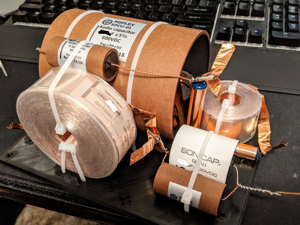

Thanks! I actually just finished printing my crossover boards today and assembled both of them!  :thumb:
They weigh a little over 7lbs each...
Sadly tho, I snapped one of the leads of my Path Resistors when the main inductor tipped over... :duh: So I gotta wait for a replacement...

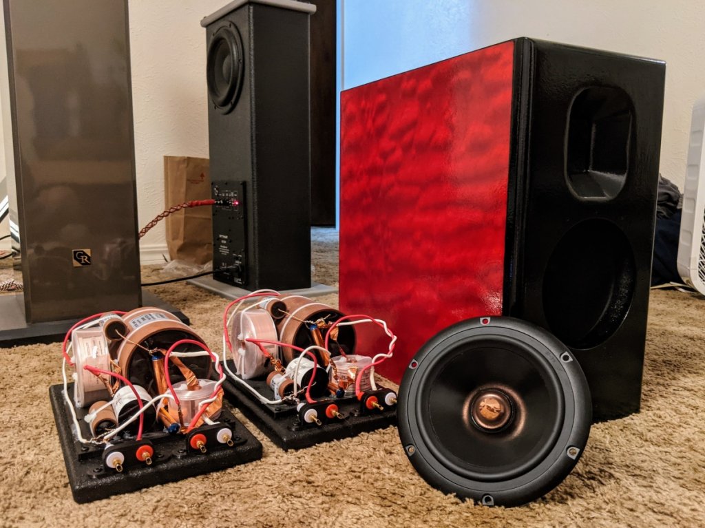

Small update!
First external crossover board is complete!  :thumb:

That is a thing of beauty!

Hobbsmeerkat that is very well done. BTW when I posted the other over the top crossovers on this thread's previous page it was not apparent just how big those coils &  caps are. Awhile later Danny held them up in a GR YouTube video and I had a  :cyclops: moment, followed by  :drool:.  I suggest for the next picture show this bad boy next to something like a woofer or the NX-Studio it will serve to better show the scale.

Hobbs, I got my Path Audio resisters you recommended yesterday and I thought they were beefy... then I saw that cap.... now that is what I call beefy. lol.

Hobbs that is still the 800lb gorilla of a crossover. And I like the way it looks and would want to showcase it to be seen.

Looks like a BIG update to me lol
I was originally gunna build boxes for them, but I scrapped that idea and went with this instead. My wiring/soldering skills aren't the best, but I'm happy with them, considering
I just finished the 2nd one last night to boot!
I knew they were going to be big, but I didn't expect soup can size caps. I would recommend anyone else go with the 250V KPCU03 versions since they're about 1/2 the size of these monsters.. lol
I think they weigh about 8.8lbs now.. or a gallon of milk/water.
Sure, here ya go!
Next is to finish up the changes to the cabinet.
Namely, drilling another set of holes for the tube connectors, holes for the tweeter wire, and a few more clear coats and lots of wet sanding.
Then finally installing No Rez, wires and the drivers.
Getting close! :green:

They're 99% finished!  :D
I just need to paint the screws for the woofers, and make some cables to connect them to the external crossovers. (on floor)
It's been a long journey and a learning process for sure!
But I'm excited to finally be getting these babies finished!  :thumb:
