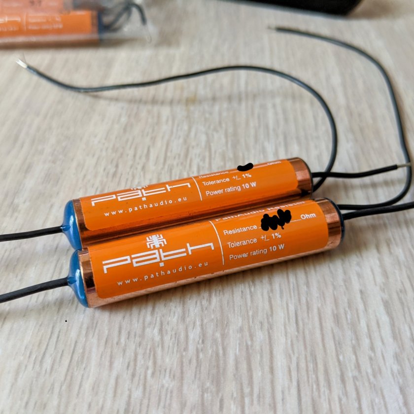

Got my Path Audio resistors in today!  :thumb:
They don't make the values i need, but they have values that can be doubled up to reach the values I need. So 4 of each value it is! :P

« Reply #186 on: 7 Apr 2021, 06:49 pm »
Just remember to put them in series for summing their resistance.  Unless you're paralleling them which lowers the resistance.
Hobbsmeerkat
  • Posts: 2741
Re: Hobbs NX-Studio Build
« Reply #187 on: 7 Apr 2021, 06:57 pm »
Yup! They'll be running in series, so no worries there!  :thumb:

IME, the drain wire on the Path Audio resistors had absolutely no effect on the sound.  I ended up just clipping mine off to make my crossover a little neater.
Argoncat
  • Posts: 73
« Reply #193 on: 7 Apr 2021, 10:57 pm »
I did the same with my Path Resistors; trimmed the wire shorter, folded it over and heat-shrink over the folded end to ensure it's protected.
Hobbsmeerkat
  • Posts: 2741
« Reply #194 on: 7 Apr 2021, 11:12 pm »
Yeah I was just planning to snip it off, but take the remainder and use electrical tape to keep it isolated & out of the way.
Just to confirm, the drain is the really long wire, correct?
Did you find them to be better than the Mills resistors?
