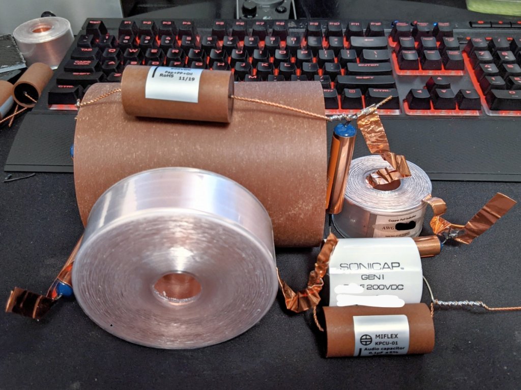

You trying to compensate for something with that Miflex cap?  :lol:
I’m curious about the foil conductors you’re using there. What brand and who sells them?
Looking forward to seeing these finished and your impressions.

Trust me, if Soniccraft sold the smaller 250V versions, that's the route I would have gone. Partsconnexion does sell them, but doesn't offer matched pairs.. (at least to my knowledge)
So 600V monster cap it is.. :P
But yeah, I totally understand.. its a whole lot of beautiful copper parts to oogle over~ 8)
I forgot to answer Tomy's question about the foil inductors,
They're mafe by Bridgeport Magnetics. Its the brand that Danny currently stocks for the NX line. We just got the foil inductor for the Studios in last week, abd will be an upgrade available on the site soon once we get out from under the backlog of current orders, and parts shortages that are really holding us back.

Is that inductor upgrade a ‘must-have’? I just placed my order for the Studios today, and waffed on the upgrade. My sensibility says that in my untreated family room, I’d likely not even notice. But I don’t want this to haunt me! Is the upgrade strictly for the audiophile who might appreciate such minutia?
mlundy57
  • Posts: 3643
Re: Hobbs NX-Studio Build
« Reply #224 on: 24 Jun 2021, 07:30 pm »
None of Danny's kits need an upgrade. His base kit is far superior to what you find in most commercial speakers. The upgrades are beneficial but how much you will realize depends on the capability of your electronics. If you have a budget level system you won't notice as much of an improvement as you would with a mid-fi system. High end systems give even better performance.
On the one hand, fully upgrading the crossover components will give you a speaker you will never outgrow no matter how good the rest of your system gets. On the other hand, if you start with the base crossover components then later on upgrade the rest of your system to a much higher level you can always build another pair of crossovers with better parts.

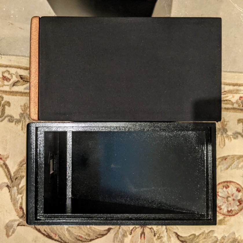

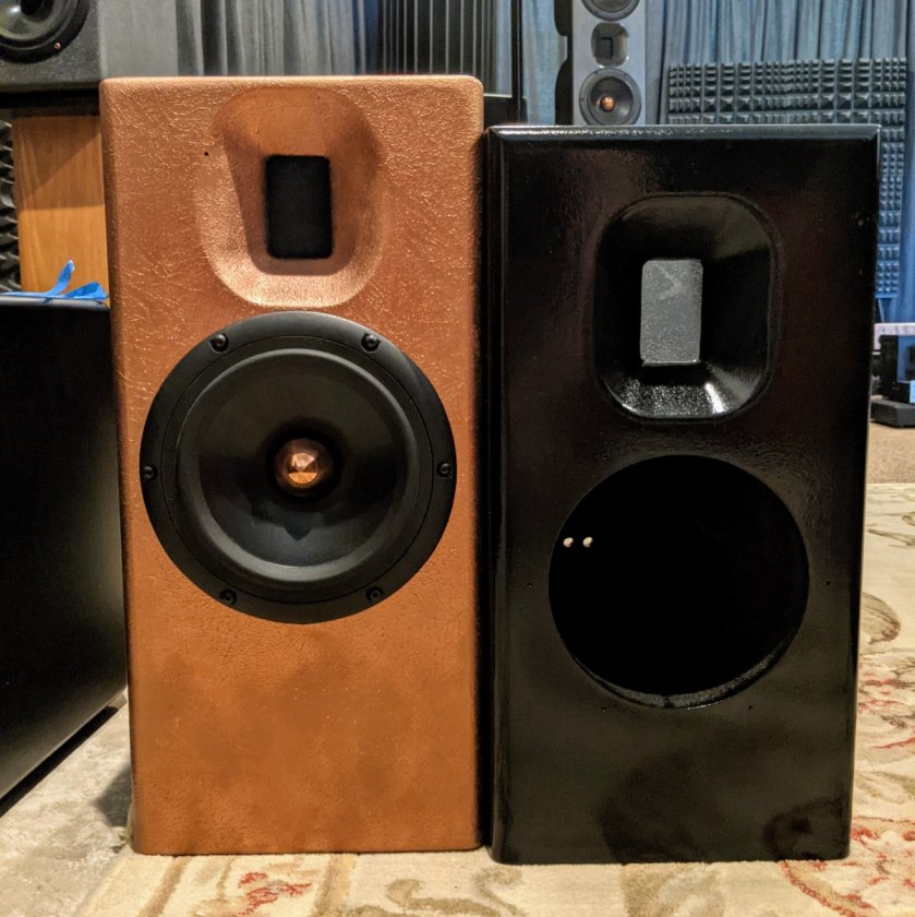

For anyone curious about the difference between the original NX studio Danny built vs the first production run by Jay/Captainhemo,
Here's a quick side-by-side comparison of Danny's build vs my own.
Danny said the differences in design dont make much difference to performance, but the current production runs should be a little more similar to the original design, mainly raising the tweeter and woofer about an inch or so it's further from a desk or console it may be sitting on.
I still haven't had a chance to purchase my own kit yet, but I have the parts I need set aside once we get caught up on the current backlog of orders as best we can. Gunna spend the weekend pre-packing a ton of orders and making invoices so that come Monday & Tuesday, We can get a good chunk of them out the door while we have 4 people in-house.
But I'll be sure to update you all once I get my kit and start assembling my crossover and planning out the building/veneering of it's box.  :thumb:

Yeah,  I actually did both designs  of the Studio's .  When we donated that pair to Peter so  a build could be done to present to Danny,  he (Danny ), measured them   and they measure  fine, basically  the same  as  thebaffles   only   he had  cut.
After   a number  of  folks asked aboiut it and most   said they felt   the  higher tweeter/woofer  looked better  (guess my taste  sucks !),   we've  done a n alteration  and  are now  shipping,  I guess youi could say,  the MKII.
Tweeter/woofer have been rraised and we're  adding roiundovers to all external edges of the   grill frame.  I"m still debating onadding  a  7/32  wire pass through hole  to the  plate right below the tweeeter.... problem is if I put it in the center ,  there will be folks  who  want it on the  side.... and the opposite applies as well.  May just  leave as  with no wire pass through and folks drill one  where they  want  it.
Will try and get  some  pics posted in the flat pack thread later  today...

I'm still really happy with how mine looks and how it has turned out so far. Plus I dig how it looks, despite my own lack of skill and knowledge.
But I'm excited to see the changes you've made between the original and updated kits! :thumb:

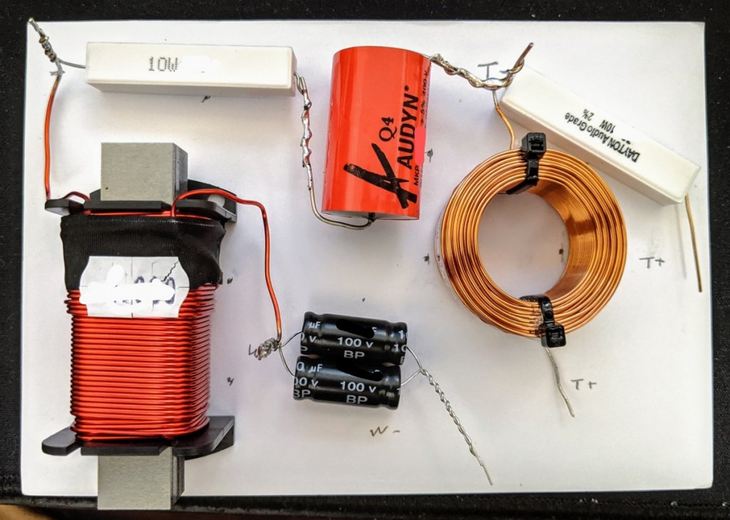

I went and found the cheapest available parts I could find on Parts express that will work for the NX studio crossover.
(I could have gone cheaper for a few parts like the iron inductor, main cap, and shunt resistor, but I'd be waiting a few more weeks to save like $15)
I did get a Dayton bypass cap, but I'm gunna wait to install it later.
I also snagged some super-cheap brass/nickel banana binding posts with an steel nut, and some 24-gauge zip-cord wire to act like your typical internal speaker wire..
Just having a little fun~

Well that one sand cast resistor says audio grade, so you should be good!  Don't be surprised if your boss calls you into his office for a talk tomorrow.

It's shunting to ground so it's not really going to be the issue that the cheaper one is at the input.
Oh, dont worry, I've already told him my about cheesey plans..  :wink:

Hobbs, I looked at my old crossover from a Klipsch center channel.  I can get you 16.2 uF of capacitance.  So then you can have a splash of cheesy yellow in your network.  Maybe we can crowd source this and get you a Frankenstein crossover.

Been a while, but things are finally moving again...  :thumb:
Next will be to design a crossover board to mount everything onto, then build a box to go around it. :D
