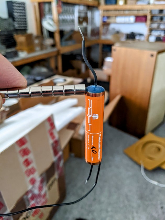

Hobbs I respect you very much, but When I was building my crossovers I tested everything including the Path resistors with a super strong magnet and found nothing. And when my NX's were down do to a dead tweeter, I retested and again found nothing sticking on mine. Maybe this was a change made after mine were produced.

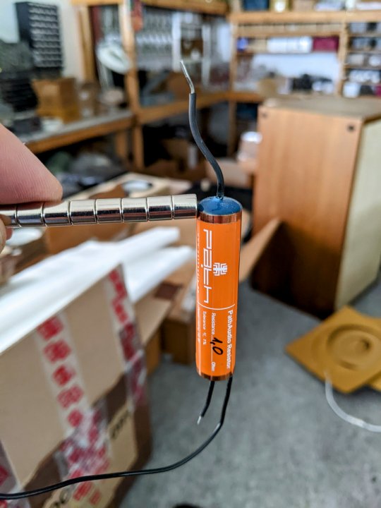

It's something I've noted before, and checking mine in the past all show a faint magnetism near the caps, and including this one and a few others that have come through.
Here's a picture I took of one some months ago:
The magnetism is pretty weak through the casing, and
While it is possible that yours are magnetism free, the ones I've handled in the past year have been magnetic, which is a disappointment considering their marketing and price.
For all I know, it may have come down to availability during the time i baught them, but it's still disappointing.

I remember when you made that post, that's why I retested mine.
