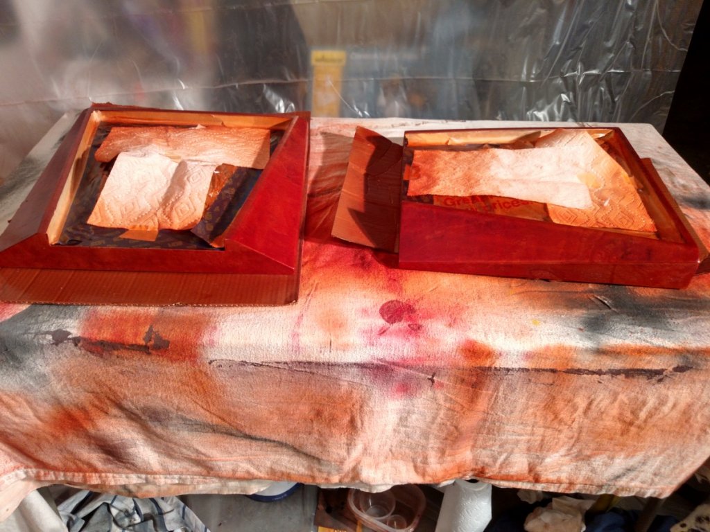

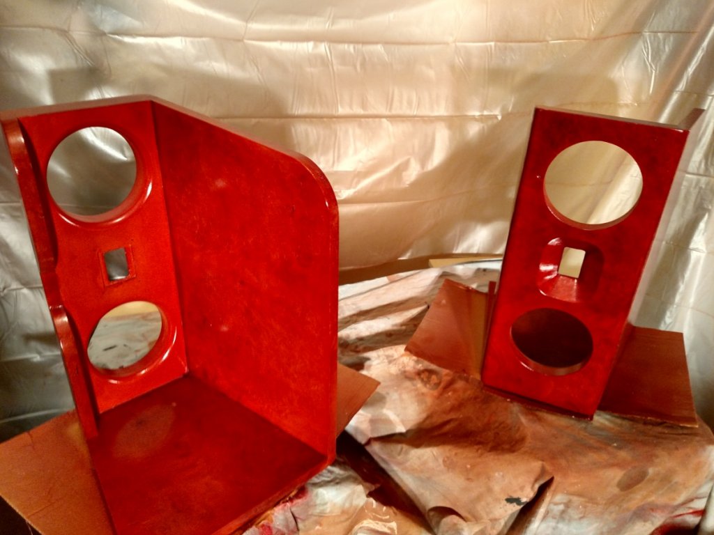

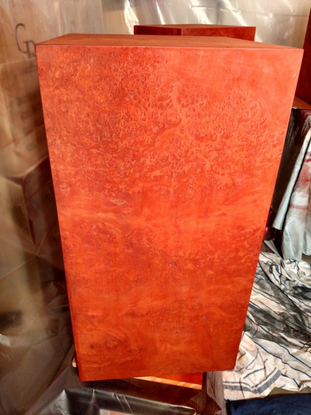

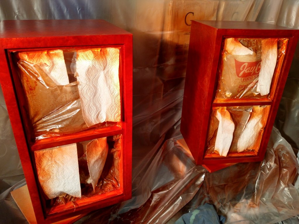

Since my last post to this thread little progress has been made until today.  The time I have had to work on this build has been spent trying different finishes and tints.  Looking further into clear coats I decided on a water borne lacquer, the Target Finishes EM6000.  I had never worked with the solvent based lacquers so I decided to go straight to something that will be readily available into the future, that and the low odor were the primary considerations.
I wasn't really getting the result I wanted with the red tint so after reviewing the color of the veneer in the first post, I realized that it was closer to orange than it was red.  I picked up some orange tint, that with a few drops of red turned out to be where I ended up.  I will follow with two coats of the sealcoat and denatured alcohol.  I will follow that with multiple coats of the EM6000 waiting a week before applying.
For those still playing along, a couple of pics:
Tomorrow, shellac.
Best,
Ed
« Last Edit: 26 Feb 2017, 04:08 pm by ebag4 »

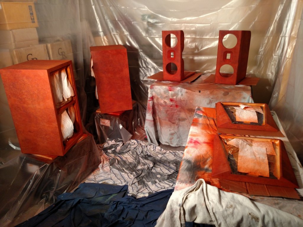

Thanks Jay, I am happy with the way it is turning out.  According to the documentation, this topcoat is fully cured at 120hrs, the samples I sprayed were easily handled in far less time.  I am hoping we continue to have mild weather here, but I am able to keep the area warm.

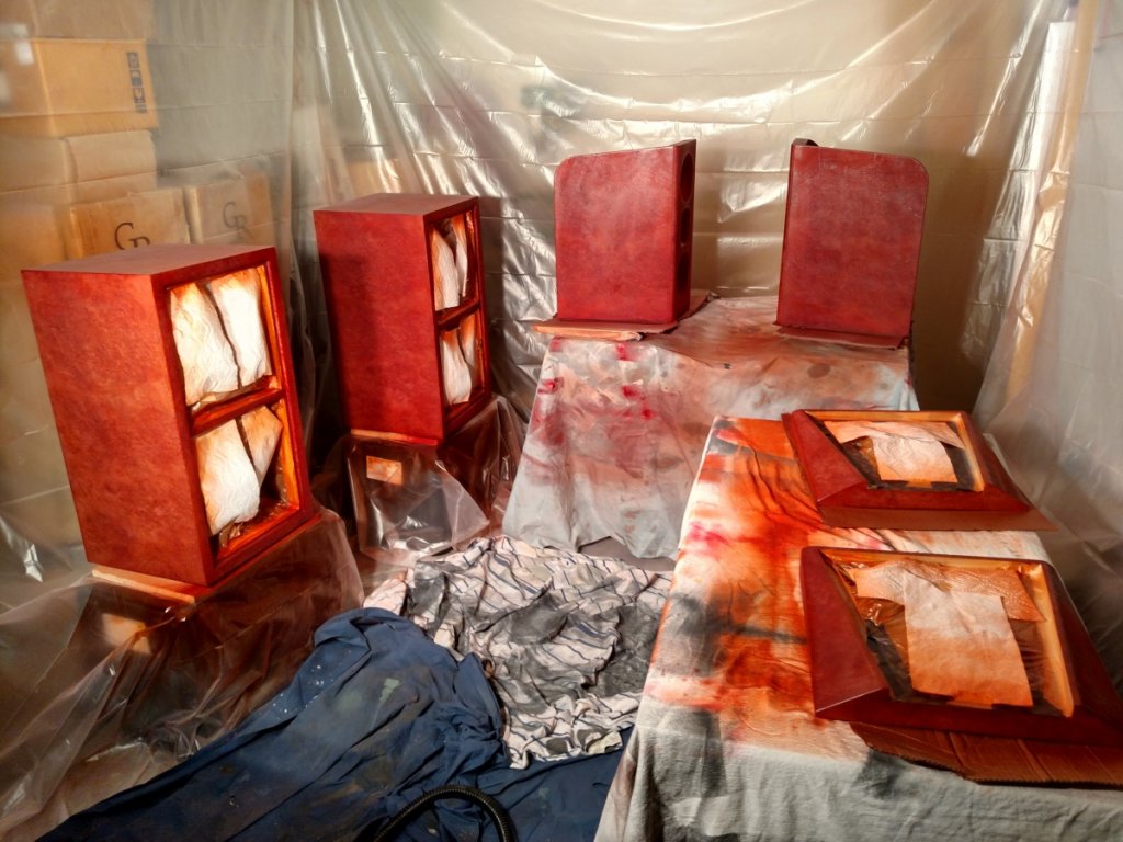

After spraying shellac today I can see that I am going to have to spread out my painting area, I am getting some overspray in the back.
Here they are with shellac, next weekend topcoat.
Best,
Ed

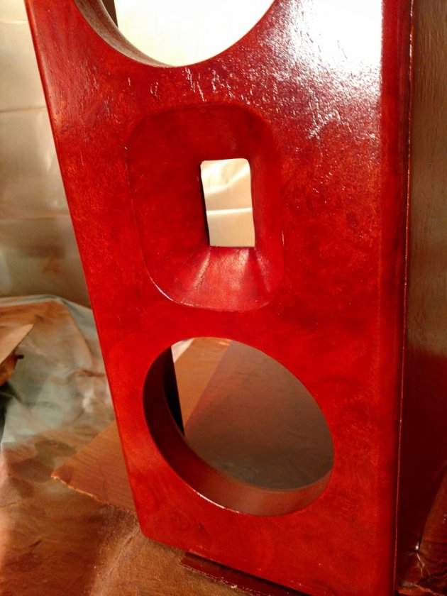

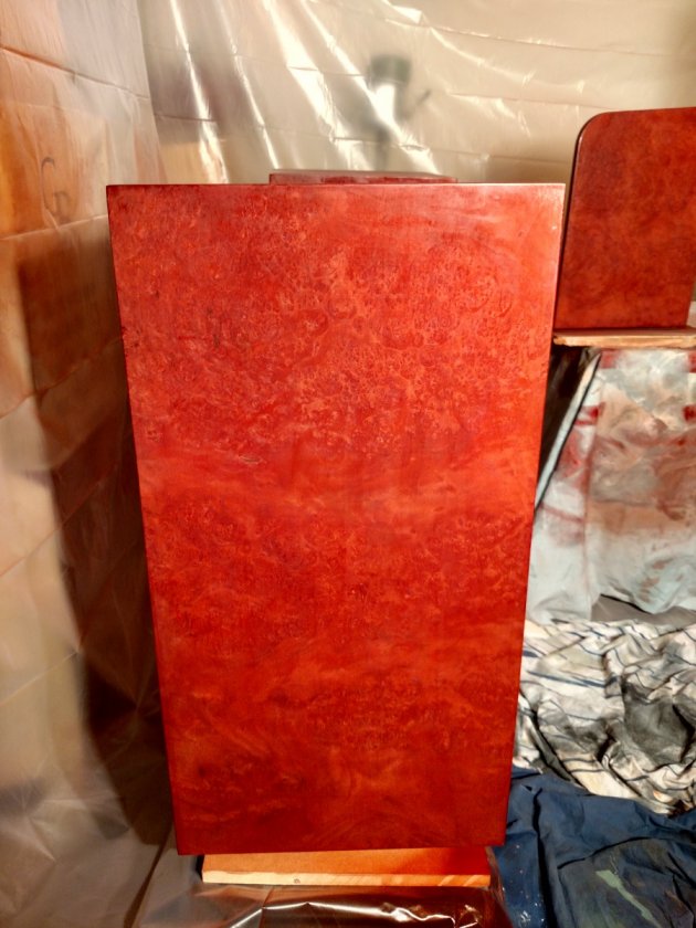

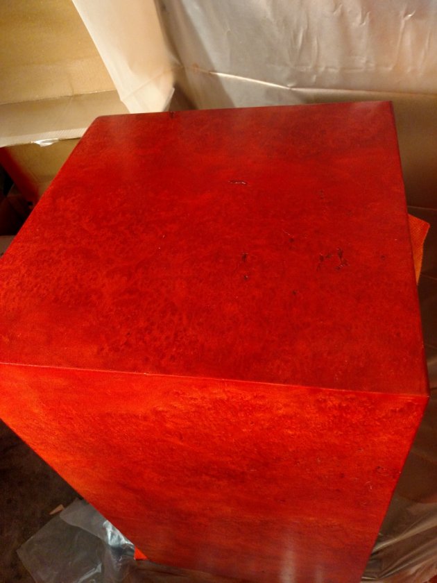

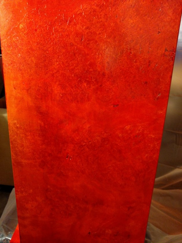

After 10 topcoats:
They are turning out pretty well.  I have learned a lot and wish I had done a couple of things differently.  I was very cautious with the amount of shellac I applied as a sealer on top of the tint.  The instructions per Target Coatings was to cut the Zinsser seal coat with an equal amount of denatured alcohol and apply 2 coats.  I applied 3, however where I narrowed the spray for the front and rear of the bass cabs (resulting in additional product being applied), the finish came out with a greater glow compared to the rest of the build.  Next time I will probably make shellac from flakes so I can cover completely and not worry about crazing, which is the problem with the Zinnser under the em6000 when the Zinnser is applied too thickly.
Overall I am happy with the finish.   Am considering buffing it out, but because I did not fill the pores prior to finishing there will be imperfections, I am not certain how that will look with a highly buffed finish.
Best,
Ed

« Reply #138 on: 6 Mar 2017, 02:28 pm »
You're getting there, Ed.
Did you sand flat between some of those ten coats?
You can cut and buff even without grain filling, I've done it many times with solvent based finishes.  What does Target say about it with their product? Many water borne finishes cure by coalescing on top of prior coat so you get halos where you sand into all but the top coat. It's not always a good idea, I've fought similar with polyurethane.

Thanks Peter.  They actually look better than my poor photography shows.
The EM6000 is supposed to have full burn in like Nitro, so no witness lines, although I have read where some have had an issue with with witness lines using this product.
One gentleman has a youtube video of him buffing out the EM6000 on a guitar.  He starts "leveling" with 800 grit dry, then moves onto 1500 grit wet, followed by 2000 grit wet, then buffs it out on a buffing wheel, my plan was to do something similar now.  However, as you mentioned I should have doe a sanding at an intermediate level, probably 5 coats, then finished with the 5 additional coats, the gentleman with the guitar did at 6 coats.  I think I will sand on these a bit, testing on one section before doing it on the entire build.
