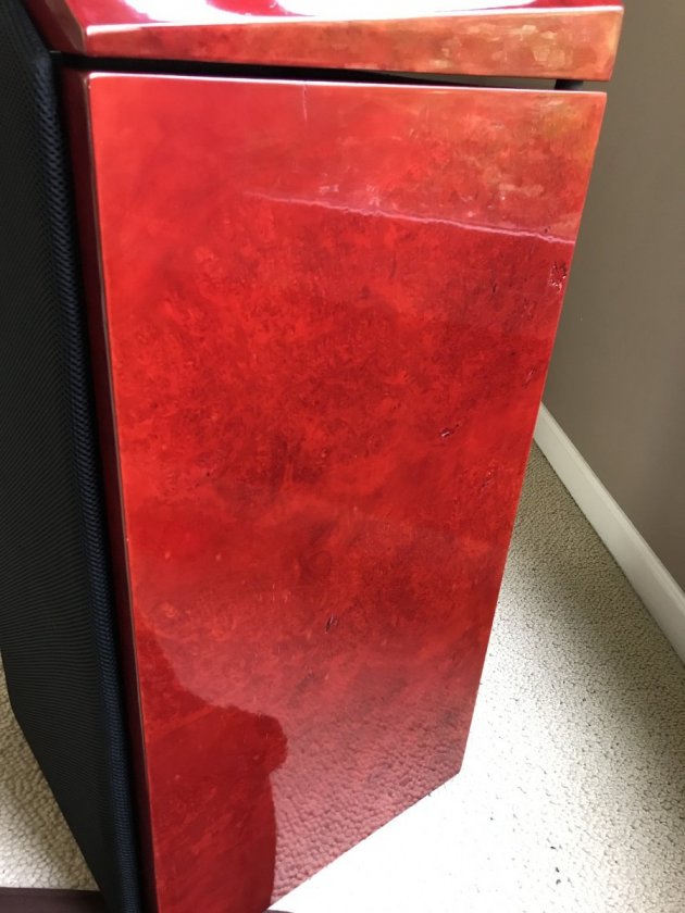

Thanks Lacro, I decided to proceed with the ultimate wax.
I haven't made any progress but the wax arrived so I made time to wax the MTM and the middle section.  I mounted the drivers, this is what they will look like finished.
Best,
Ed

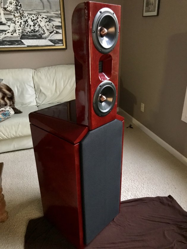

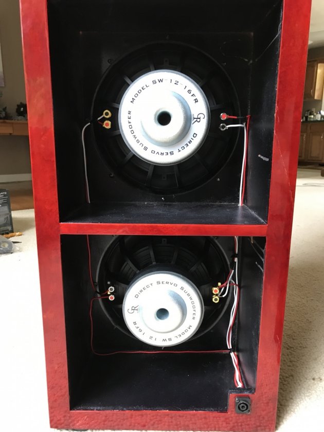

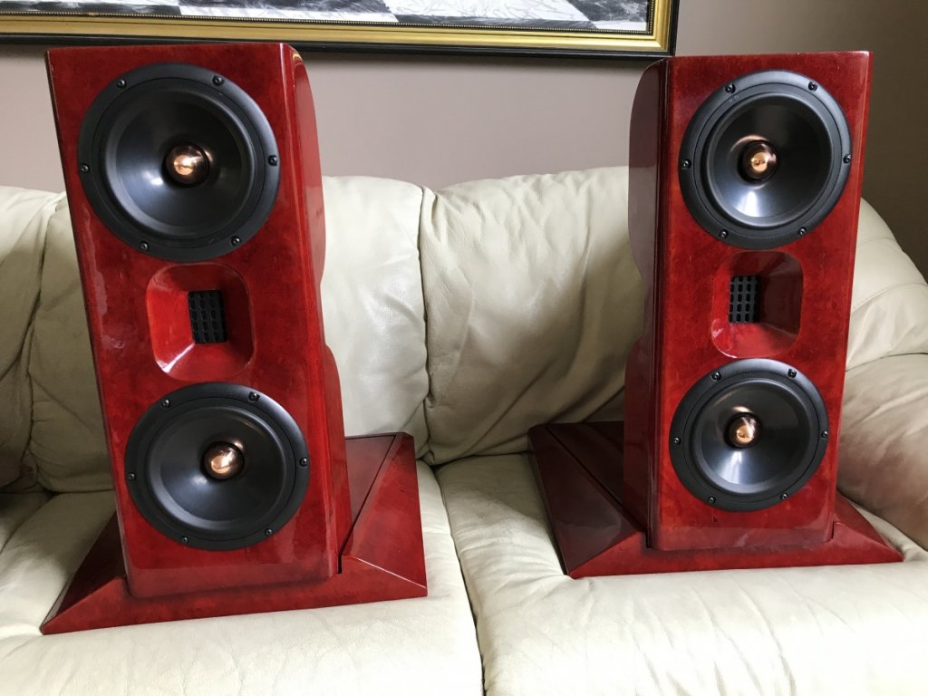

They are complete minus NoRez.  I just realized this morning I have less than half of what I need, I will do that when I can start and finish it.
I wanted to thank everyone who participated in this thread for sharing your experience and know how.  The support offered in this thread and on Audio Circle over the years is priceless.  This project was improved (imho) through the support and ideas offered in this thread.
Here are pics of them as they were being finished , this will be the end of the pics unless someone wants to see the NoRez , for that I would recommend going to Peter's Otica build, that's what I will be attempting.  These get heavy enough that I install drivers in them on the floor they will live, that is why I am working in the great room.
I will be commenting on sound once they have several hours on them.
They are sitting on 4 Herbies giant gliders ea., Herbies tenderfeet are between the bass base and the center crossover section, the MTM is sitting on some 1/8th inch thick sorbethane that is attached to the center section, the sorbethane is sticky and keeps the MTM from moving.

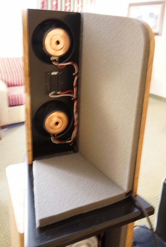

The No-Rez will make a big difference in the sound. The MTM's had a cavernous sound to them in my room before installing the No-Rez. I found putting a piece on the bottom in addition to the large wing was beneficial in taming that undesirable sound.
With the bottom piece you can try before you buy. Set them in place without peeling the backing off. If you like the sound, then peel and stick. If not, remove the piece of No-Rez and keep the bottom shiny.
No-Rez won't stick well to the finished lacquer. It will keep pulling loose. I scuff sanded the areas where I put the No-Rez with P600 sandpaper (~ANSI 400 grit). If you have applied wax, remove that with mineral spirits before sanding.

Thanks Mike.  Yes, of course I waxed the interior side and bottom  :duh: :lol:

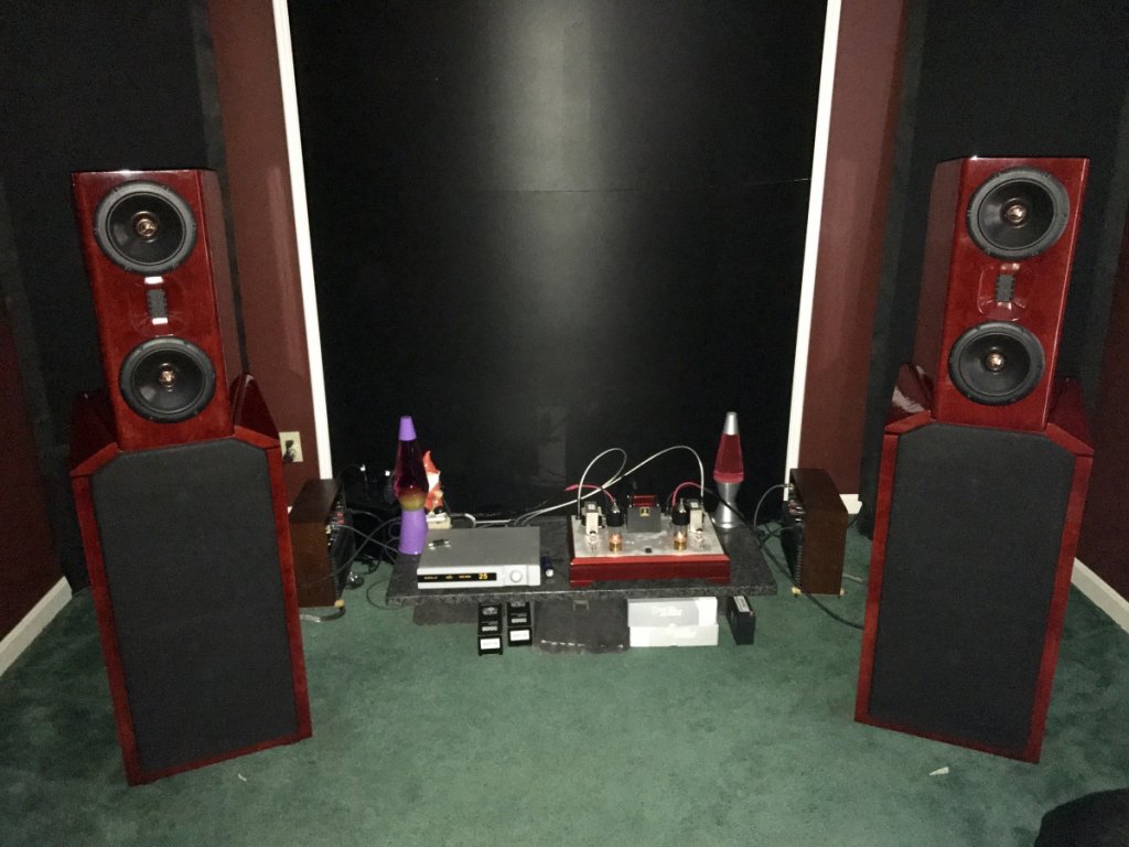

I wanted to give a brief update on the sound.  I have them breaking in on the Folsom amp I built last year, great synergy here, really excellent pairing, makes me wonder if Danny voiced these speakers using his little chip amps.
Sometime after 50 hrs the speakers bloomed, they are sounding fantastic, similar to the Wedgie but more weight and more dynamic.  More later.

Hey, not sure if you  guys flipped the wiring  in the netowrks  or not but,   the  tweeter should be wired   out of phase,   in the pics , it look s like you've got red to + ( if you flipped wiring inthe network, that's fine , but if not,    they need to be reversed).  Good catch Don :beer:
