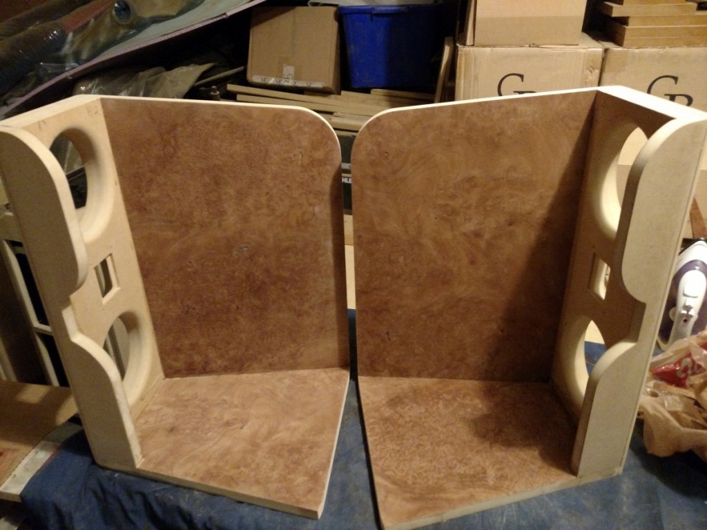

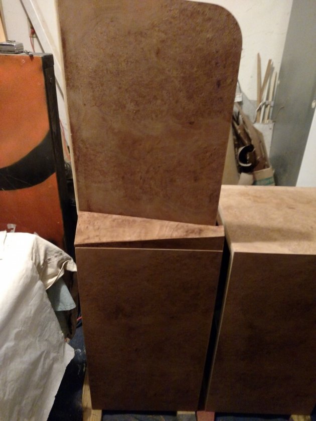

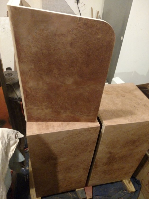

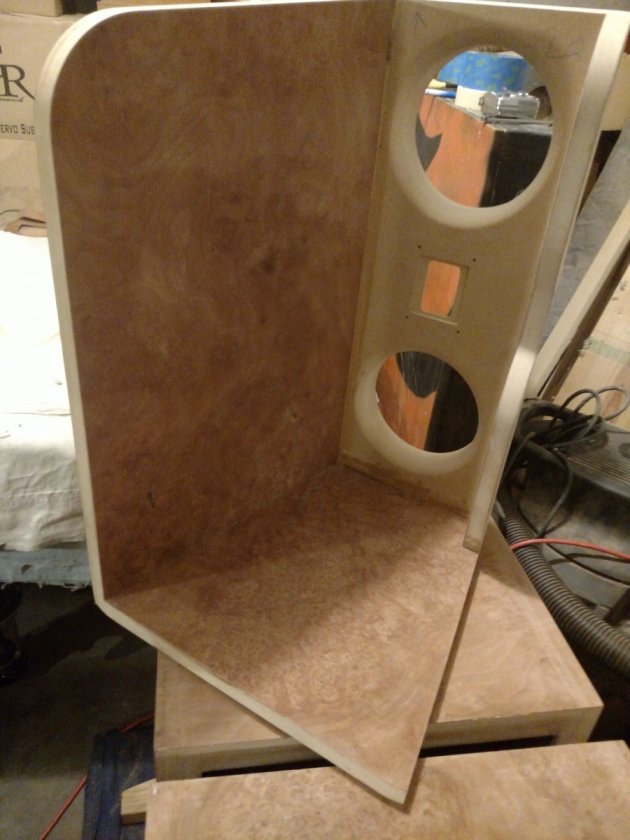

Thanks Mike, I checked, the spray shellac is wax free.  I have a test strip, the shellac and the oil based poly both darkened the veneer quite a bit, the sanding sealer topped with shllac and the sanding sealer topped with poly both kept the veneer much lighter.  I haven't made up my mind yet regarding finish.
One thing I have run into is that the veneer softener has changed the color of the veneer, it started fairly red, the red has come off when using the softener, changing the veneer's slightly red color to brown.   Joe has been great at trying to figure out what happened, going as far as testing his own plane tree Burl, but he couldn't recreate it.  I now believe that there must have been some type of coloring on the veneer, it colors the paper towel used to dab up the moisture.  I first used the softener as prescribed to flatten veneer, I thought that might have led to the color changing, but after the first sheets changed, I decided to try it without pre softening, instead just using the softener after applying the veneer, this has worked well however the color change still occurs.  The veneer looks great even though it s not as red as I had hoped, the softener has kept the veneer from splitting.
What would be the preferred way to add a hint of red back to the veneer?  Could I add tint to the sanding sealer?  Recommendations are appreciated.
Here are a few pics for your amusement:
One large panel left to do.  A note for someone trying heat lock for the first time.  I wanted to keep the heat to a minimum on this Burl to minimize splitting.  To do that I try to let the heat lock set up the minimum amount (if the glue on either the veneer or the panel are the least bit tacky, they stick together like contact cement) if you are doing a large panel and you set the veneer on the panel with glue that is still tacky that is where the veneer stays, using wax paper between them, gradually pulling the paper out as you use the iron makes this much easier.
Edit: re-reading what I said above, it reads as if I applied veneer with the glue tacky, this is not correct and not the way it is meant to work.  However in an effort to to apply the veneer the moment it was dry, I would have a situation where an edge where I had applied tape to the face would have a bit of glue built up or a small area of glue on the veneer was applied thicker and barely still tacky; in these cases, where the veneer lands it can stick, this can ruin a piece of veneer and create a lot of work to remove.  This is why I mention the wax paper trick, I'm sure it saved me more than once.  Sorry for the rambling, Ed.

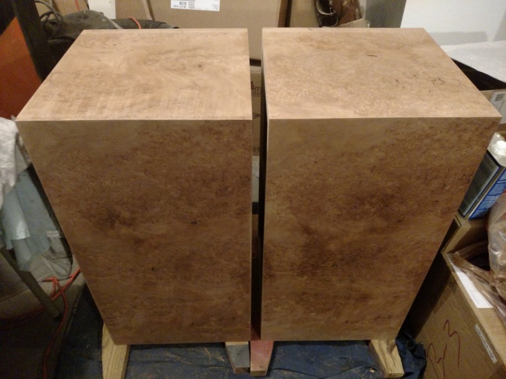

One last piece done today, not cleaned up yet but starting to take shape:
Best,
Ed
