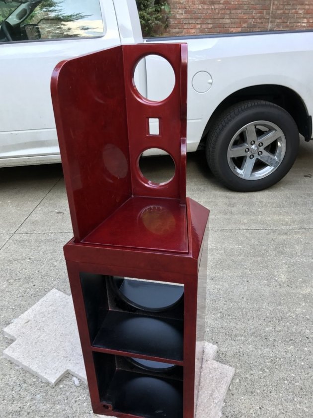

Thanks Peter, it has been a bit of a journey, I have learned a lot.  It appears I underestimated how long it would take to buff one out ( no kidding most of you are probably thinking  :lol:), I managed to get one speaker completed.  They really flattened out well, the first panel had the most cracks in the grain so far. This is how the left speaker turned out:

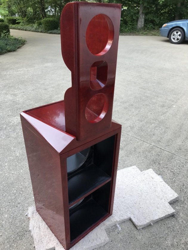

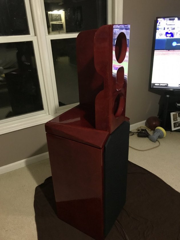

ebag4
Re: Veneer Question/ NX Ottica MTM-H Frame Servo Bass Build
« Reply #186 on: 17 Jun 2017, 12:24 am »
Thanks guys, I am pretty happy with the way they have turned out.

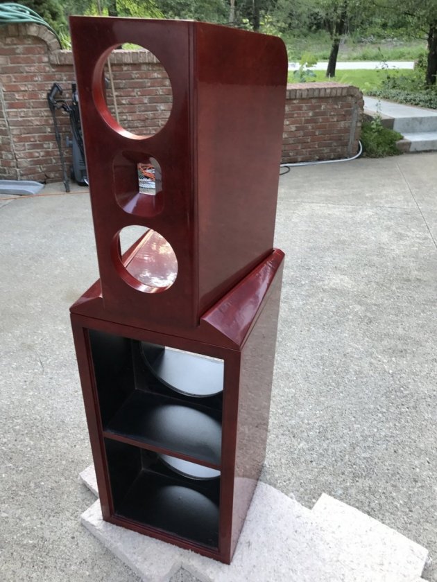

I picked up some Meguiars Polish, I want to see if that adds any additional clarity and sheen.  I hope to make more progress this weekend, I did manage to get one of the grills made.  Here is the left speaker with the grill, Herbies square fat dots between the bass unit and the center piece with the entire speaker sitting on Herbies giant fat gliders:
Best,
Ed

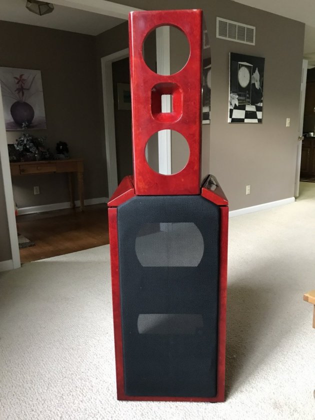

ebag4
« Reply #189 on: 17 Jun 2017, 05:50 pm »

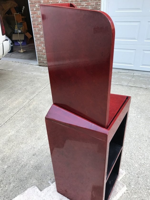

Thanks Jay/ Lacro, that is essentially what I am doing only it is two step followed by wax.  I sanded with 800/1500/2000 and followed that with Meguiars #2 fine cut (based on a recommendation for use with EM6000). I bought Meguiars Ultimate polish to follow the #2 fine cut , I also picked up a can of Johnsons paste wax to apply after the polish.  I used a wool pad on my random orbit sander for the left speaker, I decided to try a random orbit buffer, I picked one up at autozone.  The buffer came with microfiber pads, so I will give those a shot.
At the rate I am progressing, I hope to be listening to these sometime the week of the 4th, I am on vacation that week.
Best,
Ed

Thanks Jim, but there are plenty of flaws. I will be touching up several edges where I was too aggressive when sanding.  I am leaning that a big part of finishing is not screwing up what you have already done.  I wish I was a little quicker on the uptake, maybe I would be doing less touch up. :lol:

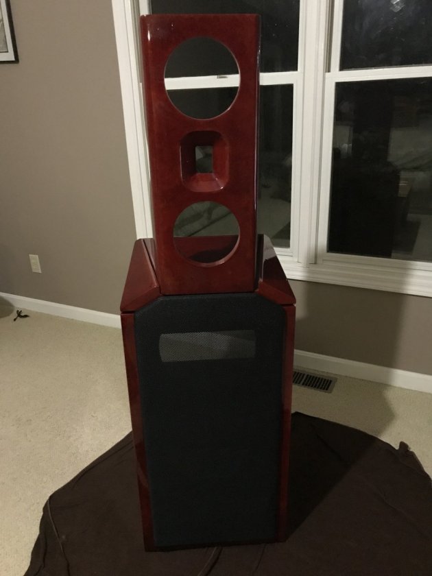

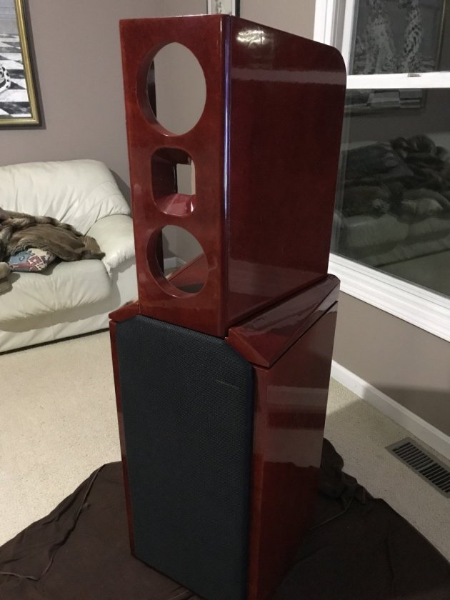

ebag4
« Reply #196 on: 23 Jun 2017, 02:31 am »

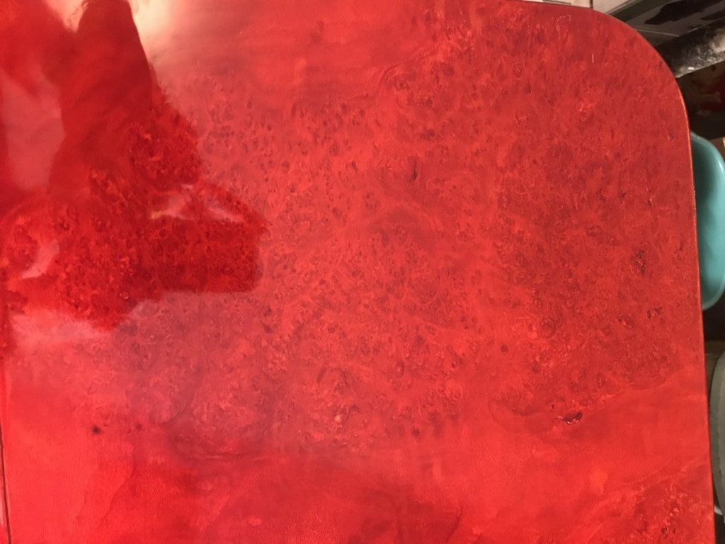

I watched a YouTube video showing how to apply the Meguiar's Ultimate Polish and picked up a foam bonnet for my polisher buffer.  I don't know if the difference is the foam vs wool/microfiber or adjusting my technique, but I am a very happy camper!  The polish gave me the clear deep shine I was seeing glimpses of, the speaker looks better than I had hoped.  I can't get the pics to show what I am seeing, but I gave it a shot (see below), the Burl has a great glow and depth.
On to waxing!
Best,
Ed
