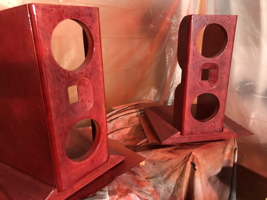

After a brief hiatus I was able to work on the speakers a bit today, they are now sanded and ready for another topcoat.  Jay, it took me about 3 seconds to see what you warned me about, I burned right through on a high spot.
I am going to tint the next topcoat and even the pieces out a bit, then several more clear topcoats.
I am starting to understand why the high gloss speaker posted earlier in the thread took 40 coats, I will not be able to go that far, this Burl has a lot of "character", it would take many many coats to get to that level of finish.

Yeah, it happens  very quickly  on high spots and edges.   I like to block sand the entire cabinet before I start applying anything  (after veneering) to try and have a nice level surface to finish on.
It's always tricky  when  dealing witha   "colord' surface (tinted/dyed etc) as  burn thourgh can  make it tough to  get a nice even tone again. With natural, it's no big deal
I've been listening to a pair of these combined with a pair of  dual h-frames for about a week now  ,  i think you  are going to be  pretty happy when you're done

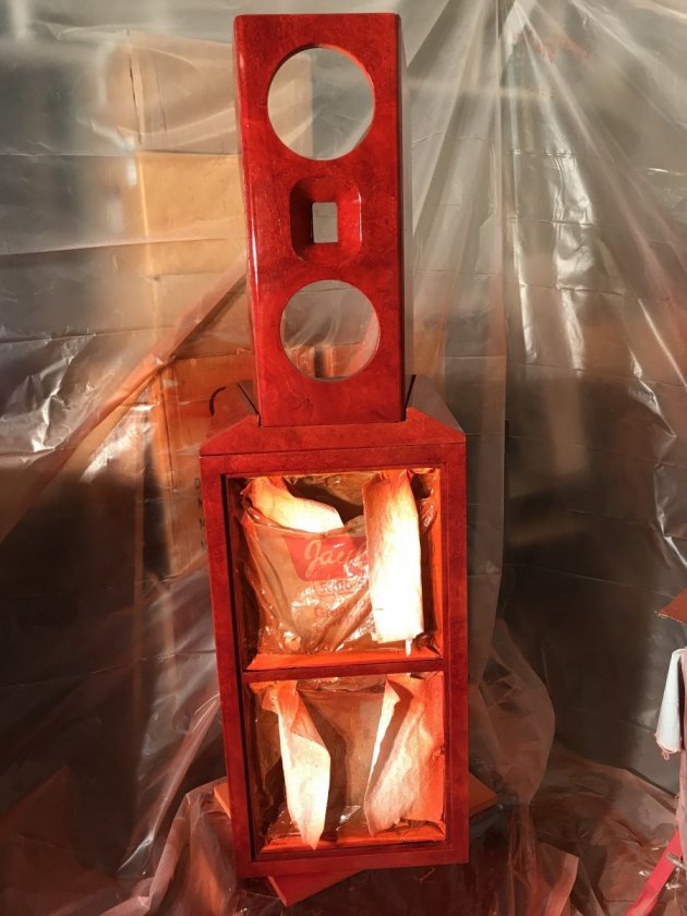

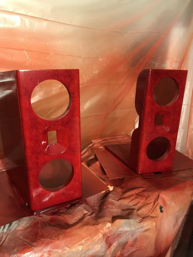

I mixed Transtint into my topcoat to even out the individual pieces, this worked out pretty well.  I have another gallon on order for the remaining clear coats.

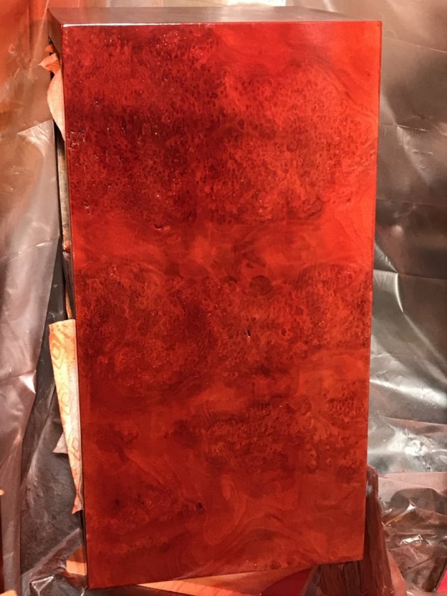

Haven't posted here lately, there hasn't been much to see.  I have just completed my 3rd course of flattening using 400 grit.  To date I have gone through 1.5 gallons of EM6000, I have nothing to really compare to personally, but that seems like a lot of material, there have been about 17-18 coats, I lost count.   It is about as close as I am going to get it, so my hope is that the last .5 gallons will carry through to completion.
I tried the Crystalac on one interior panel, it did a reasonable job of filling in the cracks in the grain, cracks possibly a little larger than what it was made for, compared to oak for instance.  It took several coats and sanded clear, in the end I decided to let the imperfections in the veneer live on.
For those still playing along, here they are after the last sanding, will apply a couple of coats today and hope to finish with the last coats tomorrow.  Hopefully buffing out next weekend.

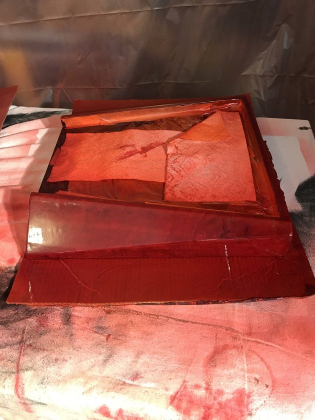

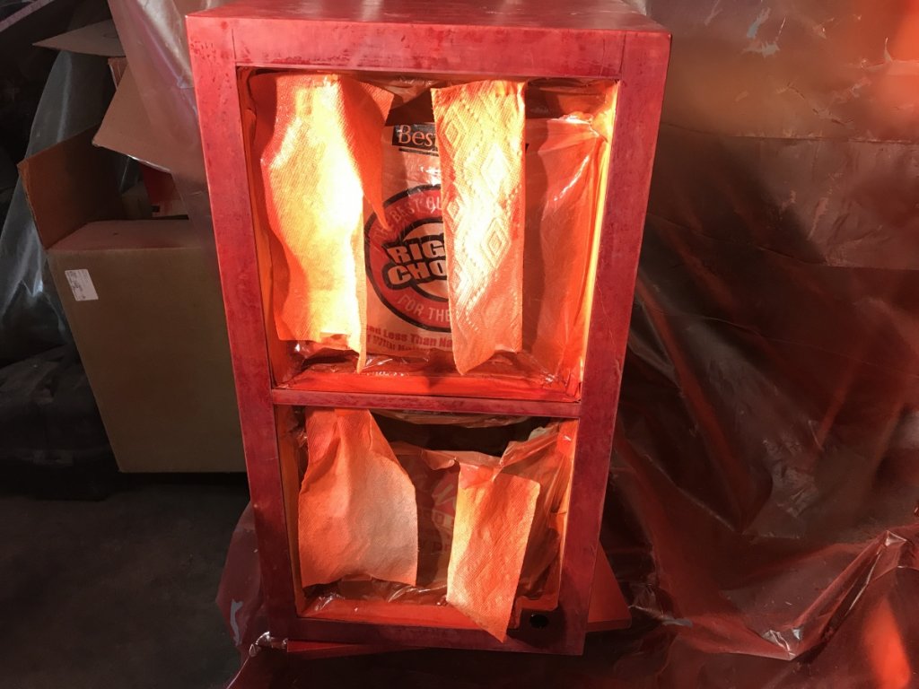

They have flattened out quite a bit although not perfect. They will level out more with these last few coats and light sanding.  Something occurred to me after doing the last sanding, using an 11" piece of 1"x2" as a sanding block has probably slowed my progress versus using a smaller block that would not require as wide an area to be flat.  They are looking good, another coat or two and I am going to call it done, then on to my next new adventure, buffing out the finish! :lol:
I have been having an issue with my gun the last two coats, maybe someone here can offer a solution.  The gun was taken apart and cleaned prior to each time the problem occurred.  After spraying each of the last coats, when I tear the gun down I find dried material that looks like spiraled cellophane.  This has impacted the spray negatively.  There is not much to the sprayer, Wagner Control Spray Max, only about 6 pieces if you count the handle, plus the air supply.  It worked well the first gallon, no issue.  I can't imagine there being a difference in the material that could cause something like this, more likely I am doing something wrong, but I can't imagine what it would be.
This is where we are with the last two coats:
