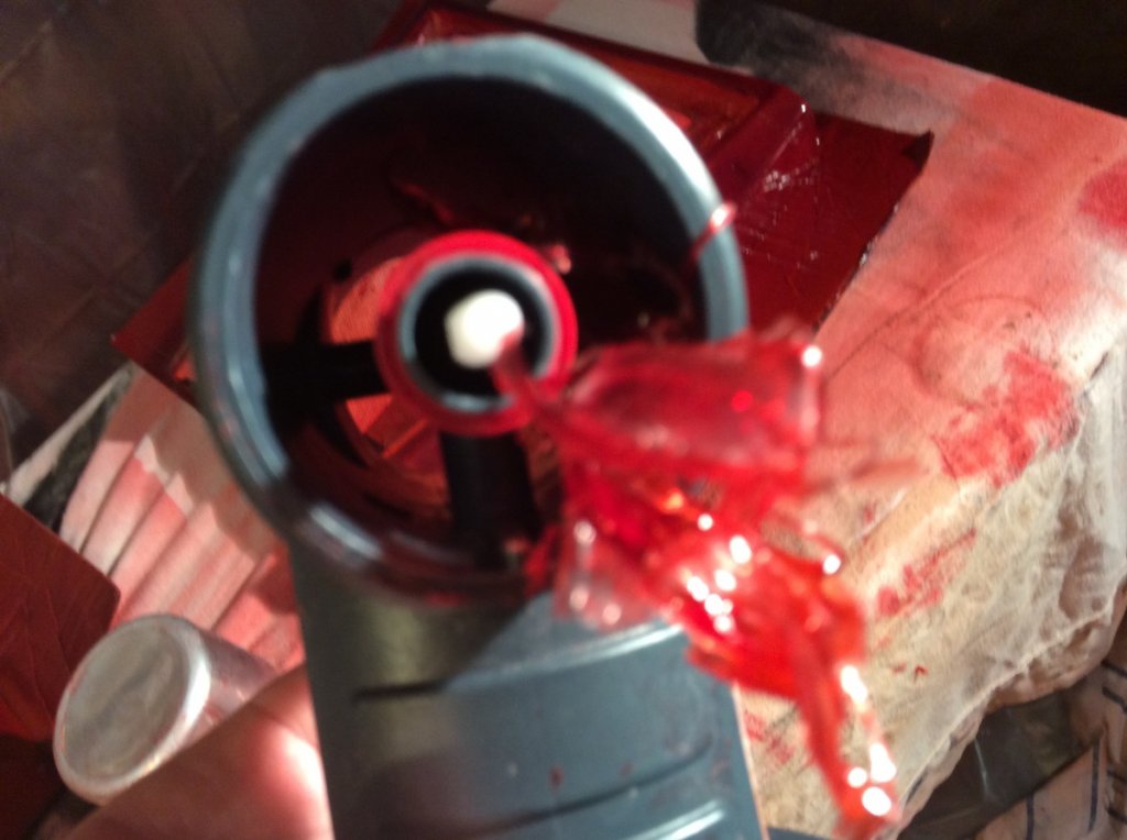

Ed, I don't know this gun, but will see if I can find an exploded view. Where are you finding the spirals? About the only thing that could create spirals (because of shape) would be the needle, methinks, but that would be a new one for me. This has a self contained turbine, right?
I found an exploded view, it doesn't look like this has a needle that stops against the nozzle orifice.
Do the spirals appear to be ribbons of dried finish?

The cellophane is in the main body top air path around the needle, I wonder if the nozzle seal could be leaking after I removed it to wash it out, if it was spraying inside the air path the turbulent air could make that happen I suppose. This is a pic of the cellophane and where I found it in the gun:
What do you think?

I think I'd agree about an internal leak. I'm guessing the air would be spiraling because of turbine output and hence finish would follow path. I know latex paint is really abrasive, I wonder if this finish could be similar. Looks like needle and nozzle are plastic which I imagine could be susceptible to abrasion. That would also make sense from a timing standpoint. It didn't leak at first, but now does.
Look closely at the needle and where it seats, magnifying  glass might help. It's possible the only fix would be new parts.
FWIW, I have a steel needle and nozzle that I took out of good Sharpe gun. The needle has a very visible shoulder that was the result of shooting latex paint. Surprised me.
Edited to add.
That, I'm assuming, is tinted finish, correct? When I'm tinting clear, I typically finish up with clear finish, no tint. It would be easier to touch up later if you have to.

It might also be possible to "seat" the needle. Years ago one could by and abrasive paste to do finish lapping on valve seats in engines, but I haven't looked for it in years. Maybe some gritty toothpaste or ??? and you could lap the needle to nozzle.

Thanks for the input Peter.  I think I will pickup a new nozzle seal and nozzle and see if that takes care of it.  Yes, the last few coats have been tinted, the last couple are going to be clear.  They won't happen today, I'm going to order the parts so hopefully the gun is working at its best the final coats.

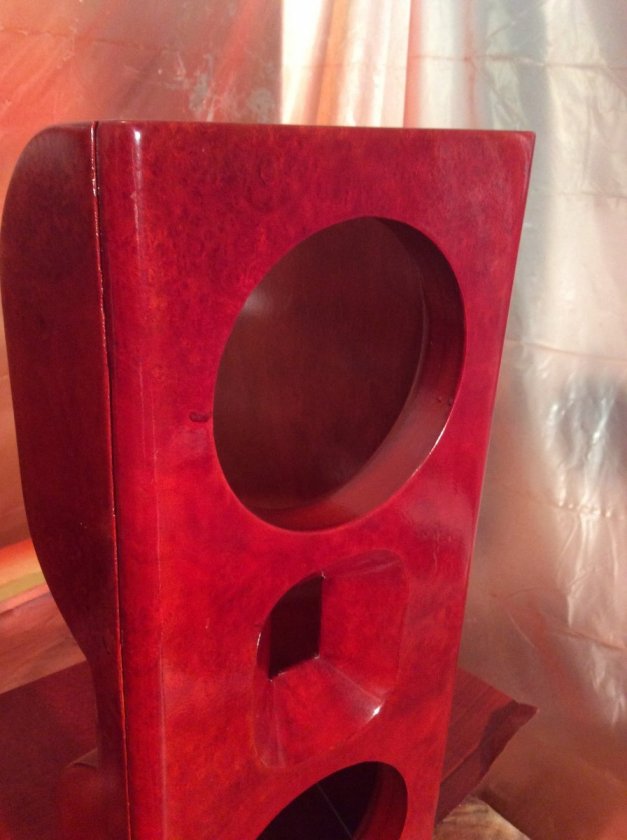

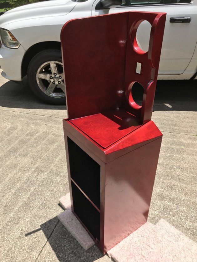

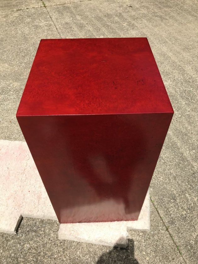

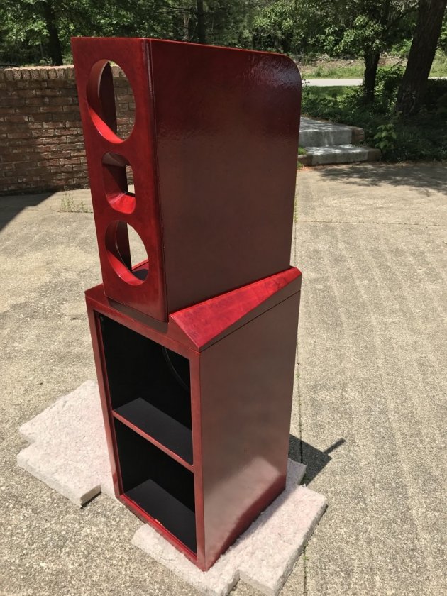

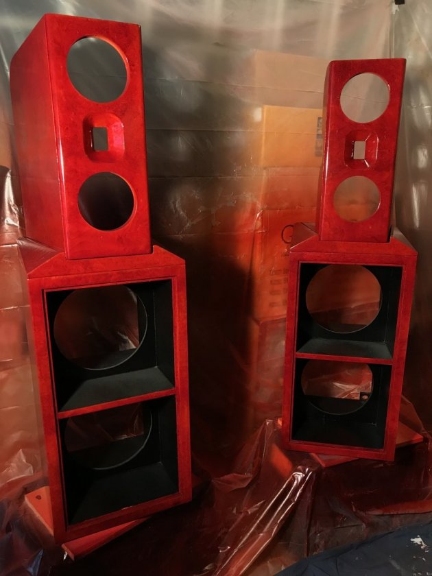

I decided to flatten one more time, the weather was great so I did the sanding outside, much easier to see what needs additional sanding.  This time I used a small rubber block, I believe this was an improvement as compared to the 11" block I was using previously.
My parts for the sprayer arrived Saturday, I had two more tinted coats to apply, although the cellophane in the air path still occurred it was to a lesser degree.  The odd thing was that the final 3 clear coats did not have the cellophane type buildup, no issue at all.
The spraying is complete, I am quite happy with the end result.  I will buff them out but need to wait about 10 days or so.  In the meantime I will apply the Duratex to the bottoms of the bass cabs, center piece and MTMs.

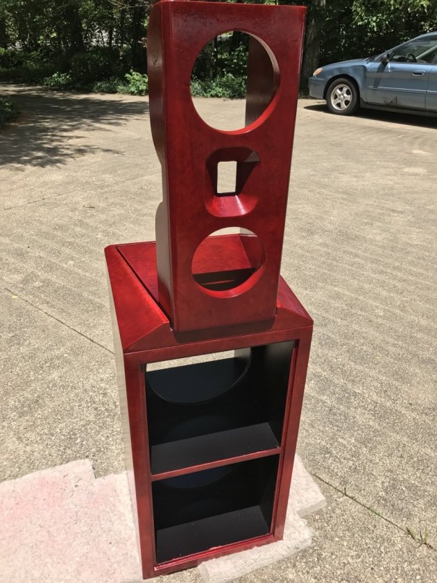

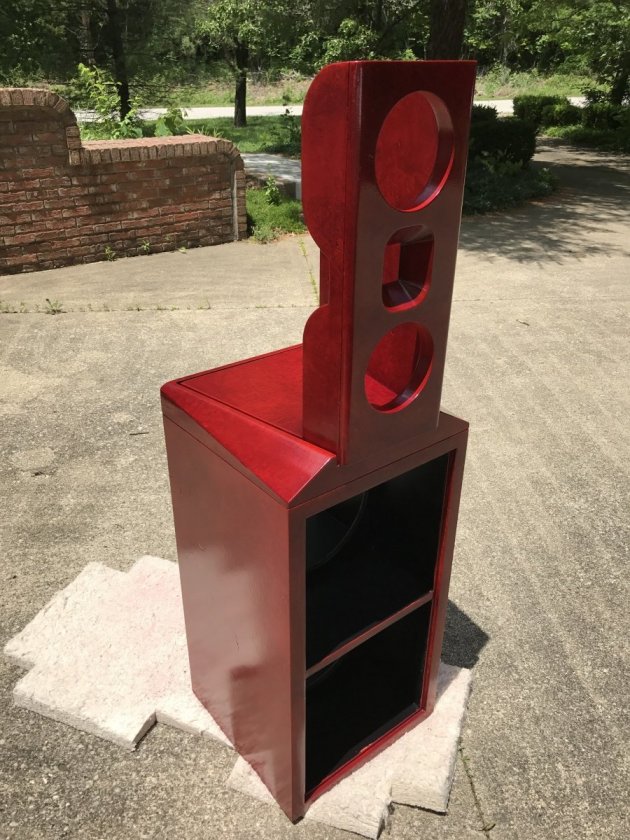

Here they are today:
As is evident, my photography skills are lacking, I took one of the speakers outside to see if it helped:
So no, taking them outside didn't help much :lol:.  Although you can't tell from the pics, the detail in the Burl shows through in a cool way, I believe buffing them out will improve the look.

Ed, these are looking great. Have enjoyed your journey with this build, and eagerly await your reaction to the finished product.
What you're doing takes a lot of patience and care... something we only do for ourselves!

Those are looking really good Ed, it's not easy getting the look you want but looks like you're on your way.
I really like your color choice and bet they will look great buffed out.

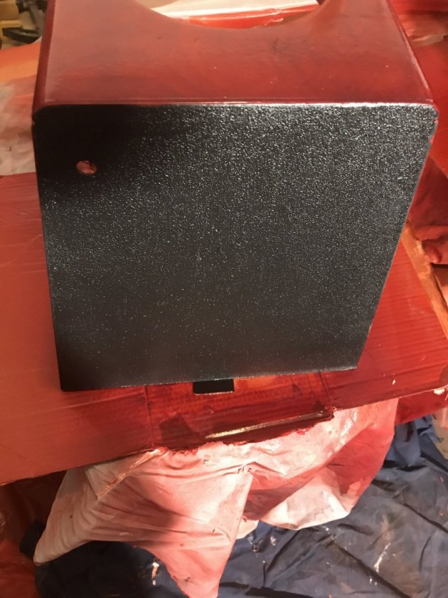

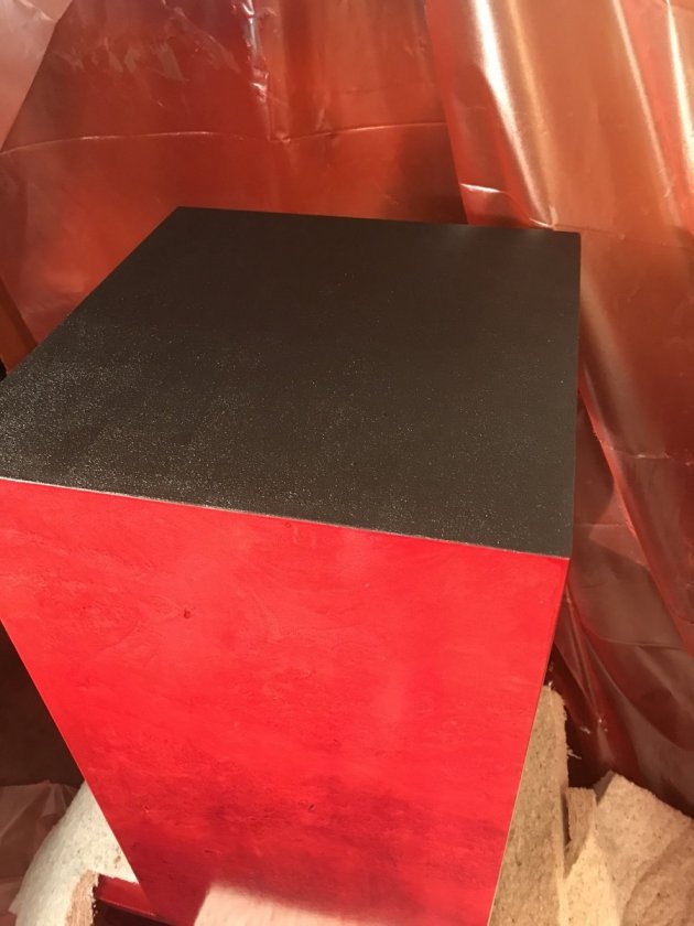

Applied Duratex to the bottoms of each piece and the top inset area of the middle pieces.  This was the first time I have used Duratex, I really like the way it goes on and looks.

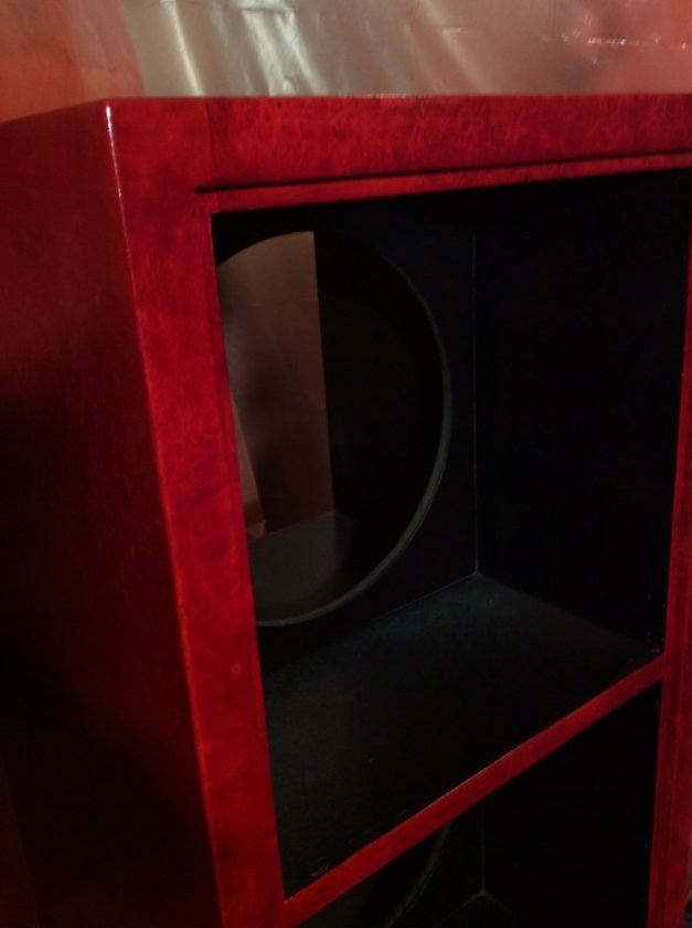

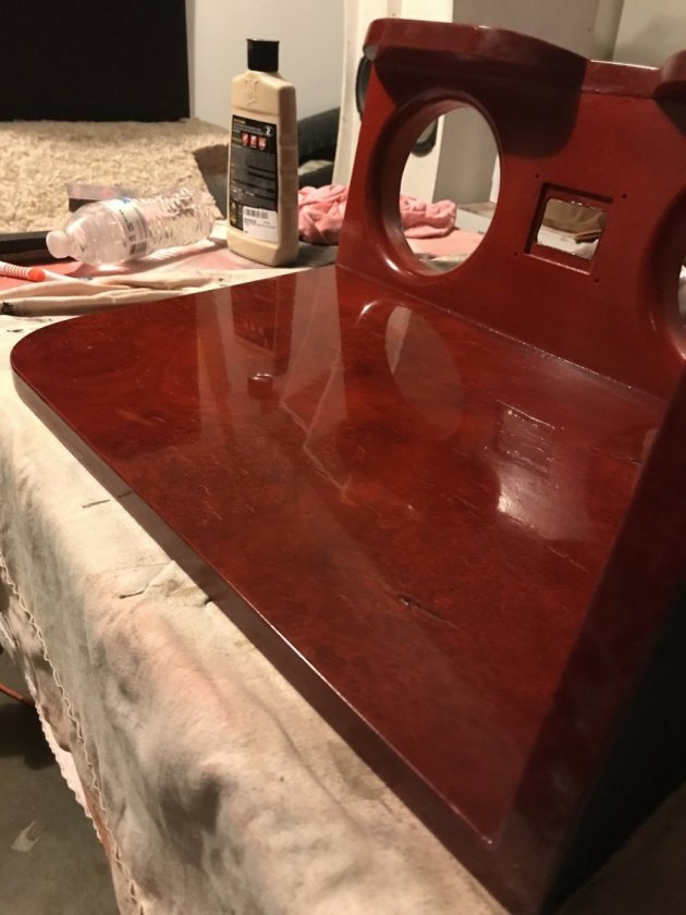

I worked on buffing out a test panel today.  I started with a interior wing so if something went wrong it would be covered with no-Rez anyway.  I started at 800 grit followed by 1500 and 2000.  I then used a wool bonnet on my orbital sander to buff it out with Meguires Mirror Glaze fine cut cleaner.  I am very happy with the result.  The veneer has small cracks in the grain that I opted not to fill, this shows at certain angles but I am good with that, it is wood.  I hope to finish the rest tomorrow.
Best,
