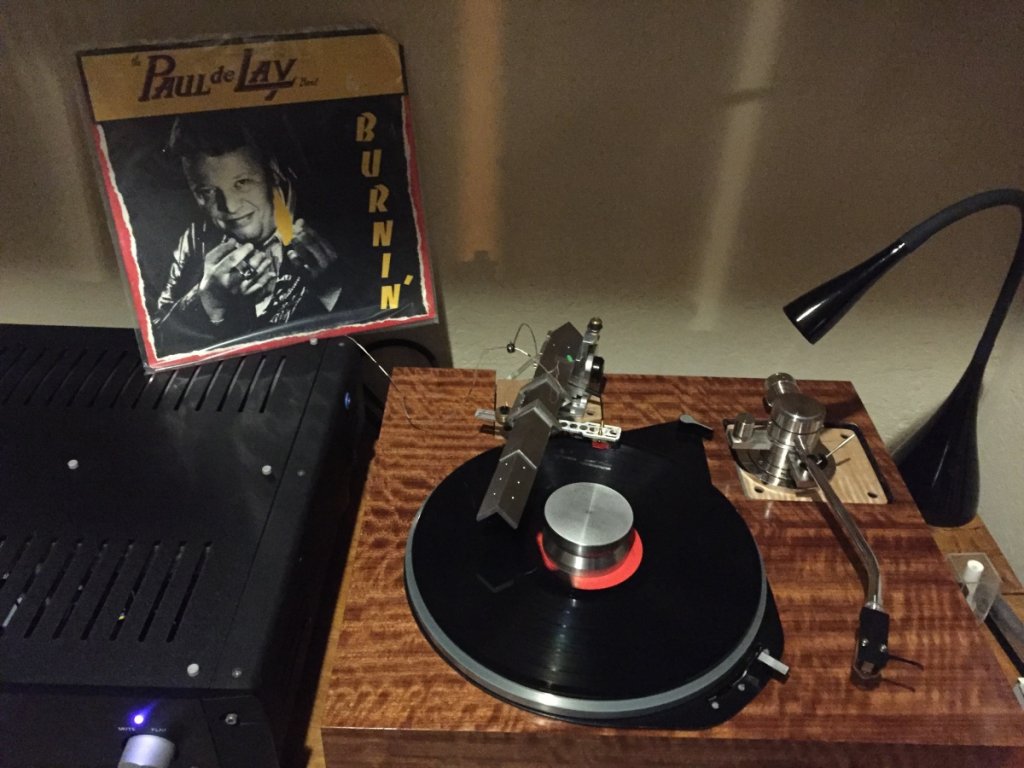

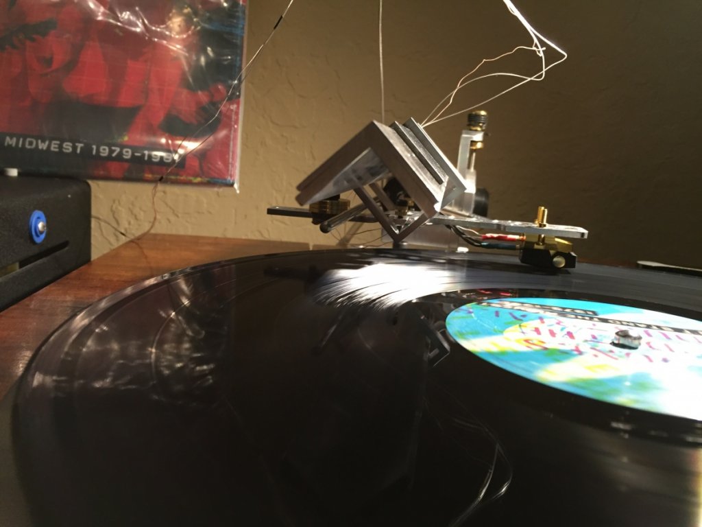

Bob,
Our builds sound similar, although the mass of mine is quite a bit less than yours.  The Lenco rebuild included a Si3N4 spindle bearing, a new precision idler wheel, PTFE idler bushings and a brass idler clamp replacing the circlip.  I also damped the idler arm with Teflon and silicone tape.  I still have Dynamat to add a bit more mass to the pan and motor, but wanted to get it up and running for a baseline before additional tweaks.
The TransFi arm is sounding fantastic, even with the inexpensive AT100E stylus--much better than the 150 MLX sounded with either the Pioneer or WTT arm.  I plan to swap in the 150MLX stylus tonight and give it a listen.  I bought a second wand so I can swap between MC and MM relatively easily.  I am very impressed with the sound of the TransFi arm, and it was amazingly simple to dial in, although I still need to get the Adjust+ record out for final alignment of both arms.
Listening to a little Paul DeLay this morning...

Good to hear it's working out for you and the table looks beautiful!
Please share the setup process with the Adjust+ on the T3Pro, as I'm not quite sure how you'd use it for this arm. Generally I've found the T3 not to be fussy at all with setup, once everything was square and level. The very low air pressure required also makes it much more live-able than the ET3 I used to have long ago, with surge tanks and such. I'm using mine with a Miyajima Kansui and though it's very low output, it sounds terrific on the Terminator.
Tom,
I've got to admit I'm not sure how I'll use the Adjust+ just yet.  Obviously I can use it for setting azimuth, but I was amazed how easy it was to dial in the alignment from the get go.  Not having to worry about a pivot makes things much easier.
About the only things that I'm not crazy about with the Terminator are placing/removing records is tricky--will want to stick to digital or mono if wine is involved--and getting at the stylus to clean is a bit challenging, but that's because of the way I installed it rather than the tonearm design itself.
I'm delighted with the performance I'm getting.

I swapped the 150 MLX stylus for the 100E.  Things seem to have gotten a bit better, but not by a huge margin.  Then again I'm listening to punk rock recorded in 1981, so that could have a little bit to do with the sound quality.

Neo,
I may do that--I've got about 5 lbs of lead I can apply in addition to the Dynamat.  I still need to add the steel bearing brace on the bottom of the plinth, so when I do that I'll see what else I can do.  I figure the plinth is about 40 lbs.  The TransFi doesn't weigh much, but the Pioneer arm and Lenco add about 15 lbs, so the whole thing is 55-60 lbs.
Right now I'm listening to a mono Nilsson Pandemonium Shadow Show and it sounds awesome.
AC

Neo,
Thanks.  I'm pretty particular, and while it's not perfect, I'm very pleased with how it turned out.
The plinth is actally two materials--Baltic Birch (BB) plywood and MDF.  The top two layers of BB are a "glulam" using wood glue to bond them (minimal damping, just mass).  The layers below are alternating MDF and BB bonded with elastomeric polyurethane adhesive for constrained-layer damping.  The tonearms are mounted rigidly to the lower layers, with the idea being vibrations from the motor, idler, and bearing have to go down into the CLD, getting damped before going back up to the tonearms.  The whole thing sits on Herbies Gliders feet, which sit on a 3" slab of ~18"x42" maple (~50 lbs), which sits on Herbies Grunge dots and a solid maple rack.
It seems to work.  Not only do both tonearms sound great, but I have to rap very hard on the plinth to hear anything through the stylus.  I can jump up and down and thump on the shelf and rack with nothing audible through the stylus.
I did add lead to the Pioneer arm board, but there are other strategic spots I can beef up as well.
AC
