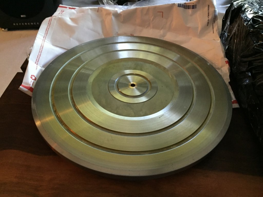

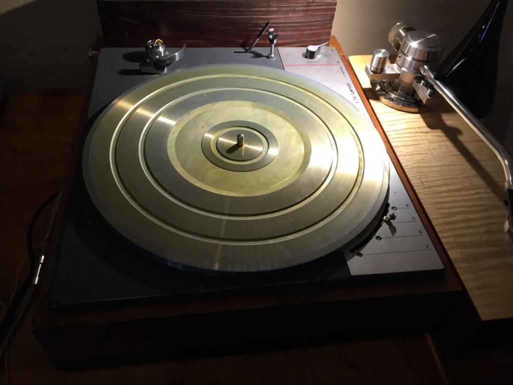

Yep, I'm definitely off the deep end (or ever deeper into the rabbit hole), as I have a new project--building a turntable.  Actually, I'm going follow lots of others that reuse key parts of a Lenco idler-drive turntable to take them to a new level of performance by replacing the sprung plinth with a massive hunk of something to damp vibrations while rigidly coupling the spindle to the tonearm.
My adventure started when I stumbled across this article by Arthur Salvatore.  While I'd heard about (and lusted after) the Forsell and other decks he referenced, I'd never heard of a Lenco.  To see his claims that a turntable that could be purchased for a few hundred bucks (less in Europe) could best statement turntables captured my imagination.
http://www.high-endaudio.com/RC-Lenco.html

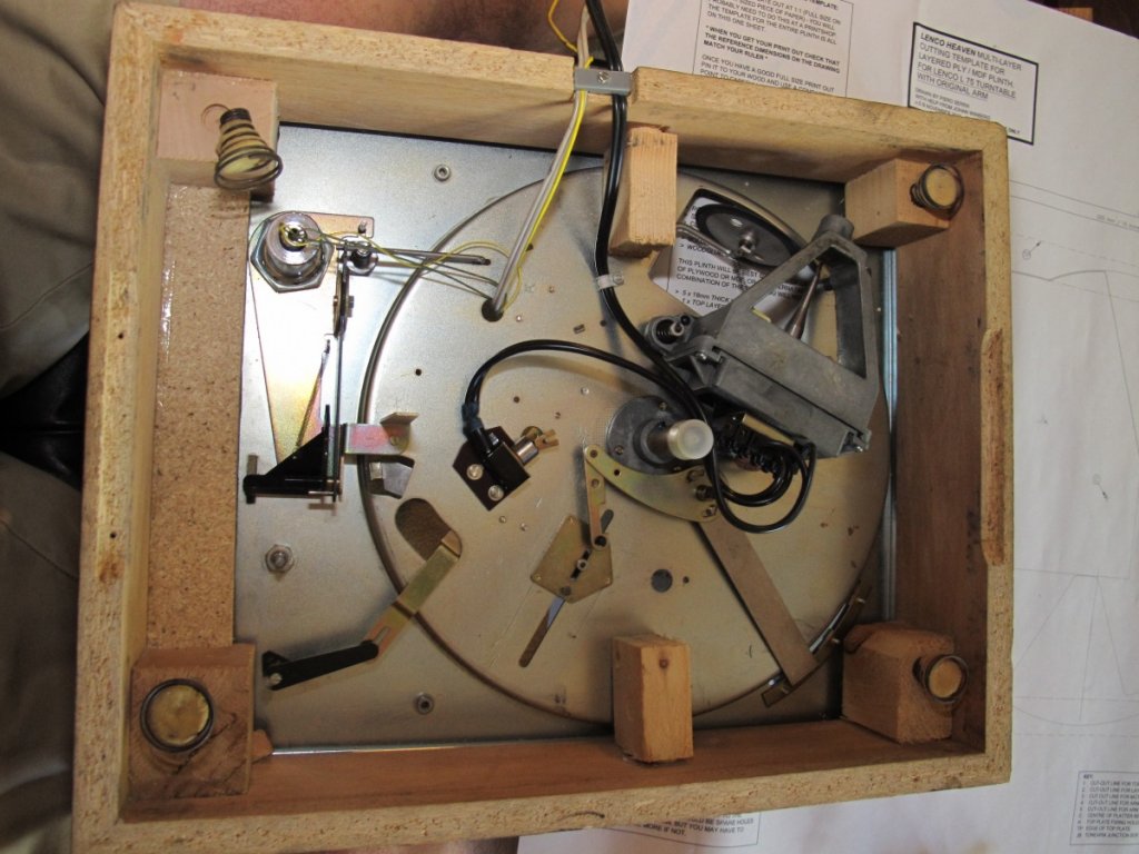

Over the next few months I continued to research what I could about idler drives--something that was old and rumbly when I got into hi-fi in the 70s as everyone was into belt drive and direct drive.  I discovered the Thorens 124, and Garrard 301 and 401, all of which were much more expensive with rarer replacement parts.

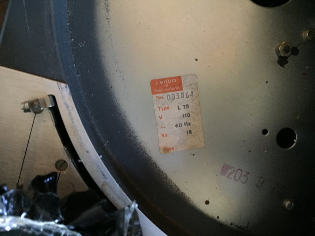

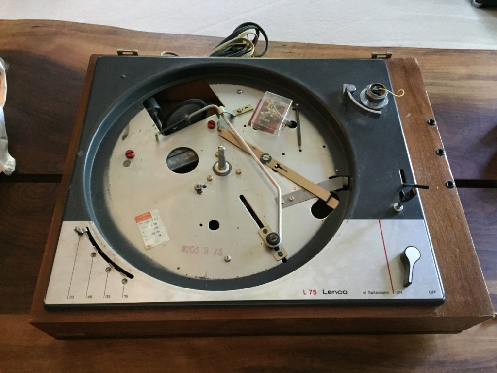

A few weeks ago I found this 60 Hz deck for $300 (AC frequency is important, as most Lencos were built for 50 Hz, and the higher US frequency creates a challenge with running at 33.3 RPM).  The tonearm was trashed, but I didn't care since I'd be adding my own (maybe 2!).  I took a gamble and hit "buy it now".  The seller warned me that the packing was in rough shape, but that it would arrive safely, and he was correct on both counts.
The seller had correctly tightened the transport screws to protect the motor suspension, and removed the platter for shipping.
I plugged it in and it spun.  There was a bit of noise, but I expected that since it was an old idler drive--it likely needed a full rebuild.  I moved my second arm on its pod over to the Lenco and aligned it with the Feickert protractor, using Adjust+ to dial in azimuth and VTA.  There was no mat, but I wanted to see how it sounded, so I put on a record.  Tada, music.  Yes there was a bit of rumble, but it sounded pretty darned good.  Sitting there listening to music coming out, I remembered that I forgot to LOOSEN the transport screws!  Removing the platter, I loosen the 3 red screws, replace the platter and put on a record again.  Dead quiet!  Magic!  I now know what all the shoutin' is about--this thing as-is compares quite favorably to my WTT Reference turntable.  Now I'm excited!

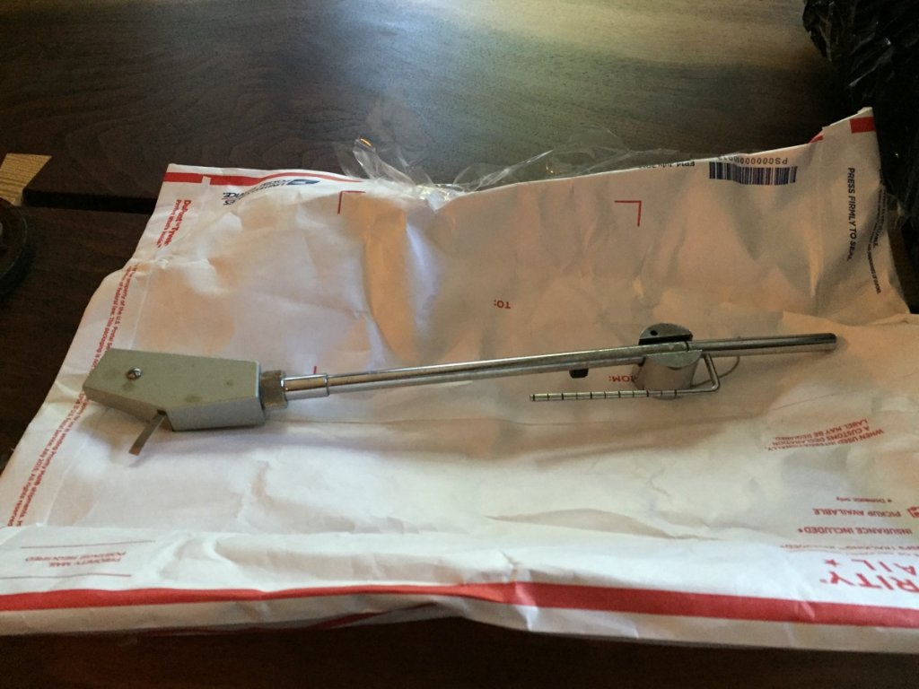

I considered a PTP, as well as Corian.  For this build I'm going to use as shaved top-plate "frying pan", although mine will be more like an "amoeba" since I plan to leave the on/off switch in place as well as the speed control selector.

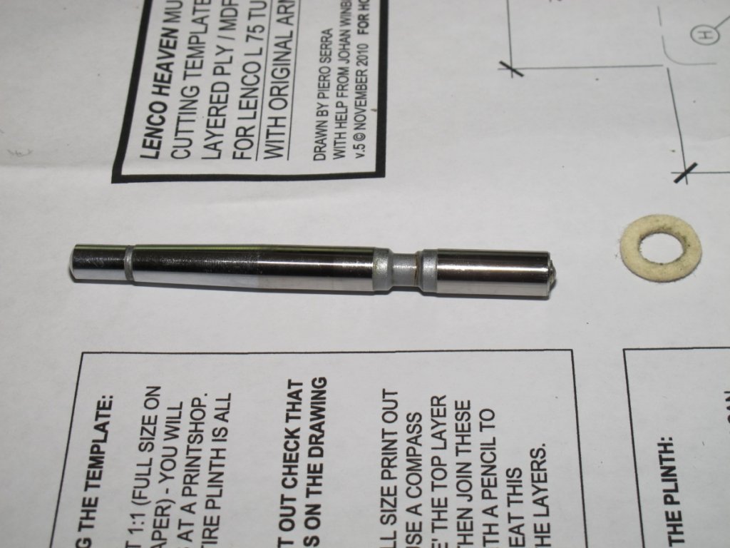

I've already ordered and received one of Norbert's idler wheels,
http://www.lencoheaven.net/forum/index.php?topic=11628.210
as well as after-market PTFE bushings and a brass clamp to replace the circlip on the idler shaft.
http://www.lencoheaven.net/forum/index.php?topic=21002.0
I've ordered a spindle bearing cap to replace the plastic one, and allows the spindle bearing to be bolted to the plinth.
http://www.lencoheaven.net/forum/index.php?topic=9739.150
I also have a pair of VibroStop Platter Mats stacked on the Lenco (I'm really liking them so far, at least as compared to no platter mat):
http://www.hologramacoustics.com/product/vibro-stop-platter-mat/
The rest of the mechanicals will just be taken apart and cleaned/lubed.  My hope here is to not screw something up, as the current performance is pretty darned good as-is.

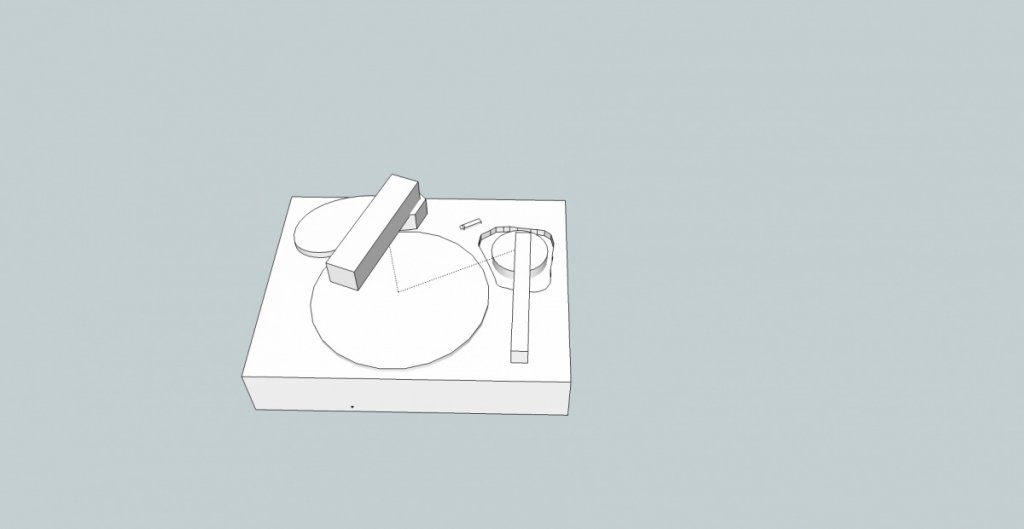

Here is the concept for my turntable:
The Lenco top plate will be rotated 90° counter clockwise so the on/off switch will be ~1:00.  The Pioneer PA-70 tonearm will be ~2:00, and I'll be adding a TransFi Terminator linear tracking tonearm at 12:00, angled at ~30° which should make it relatively easy to access for operation and stylus cleaning.  The Pioneer will have multiple headshells/cartridges, but will primarily be for my Miyajima Zero mono cartridge.  The TransFi will have two interchangeable arms, one with a Lyra MC and one with an AT 150 MLX MM cartridge.
Key design considerations for the plinth are to 1) reduce vibration by servicing and tuning the motor, idler, and spindle bearing.  2) isolate/damp motor and idler, 3) rigidly couple the spindle bearing to the tone armboards, and 4) damp the tonearm/spindle coupling by sinking internal vibrations to the plinth, 5) massive, high-damping plinth to absorb internal and external vibrations.  I may also add a second platter to add rotational inertia and deal with the relatively low platter height of the Lenco.  I will use armboards to allow for future arm changes made from either Panzerholz, cast resin/bentonite, or baltic birch plywood.

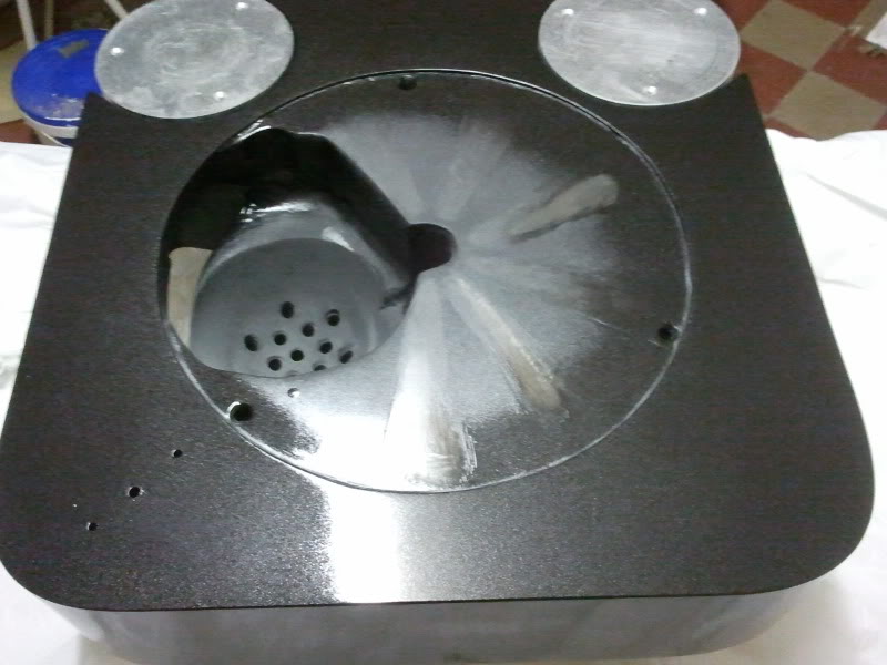

The leading candidate for plinth material is bentonite (fancy kitty litter--unused  :wink:) saturated into isopthalic polyester resin as formulated by Rap,
http://www.lencoheaven.net/forum/index.php?topic=12943.msg196263#msg196263
 and used by others.
http://audiokarma.org/forums/index.php?threads/resin-bentonite-clay-plinth-build.530544/
http://www.lencoheaven.net/forum/index.php?topic=14351.0
I looked at Panzerholz, which has a great reputation for good damping properties (plus it's bulletproof for those Hunter Thompson moments :thumb:)
http://www.delignit.de/Delignit/cms/front_content.php?idcat=17&idart=46&changelang=3
It's also hard to find and really expensive when you do (~$1kUSD for ~3' x 5' sheet ), which is why I'm considering teaching myself to cast polyester kitty litter.
As I mentioned I'm also considering soapstone and possibly slate, although working those materials I find even more intimidating than learning how to cast and finish resin.

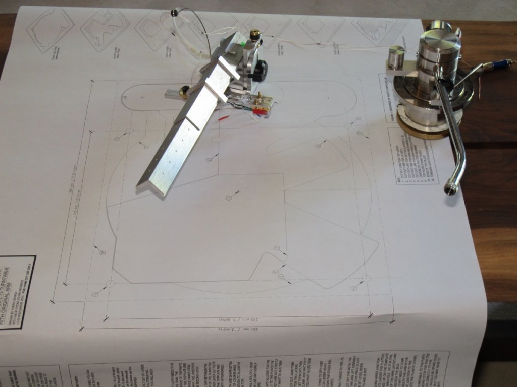

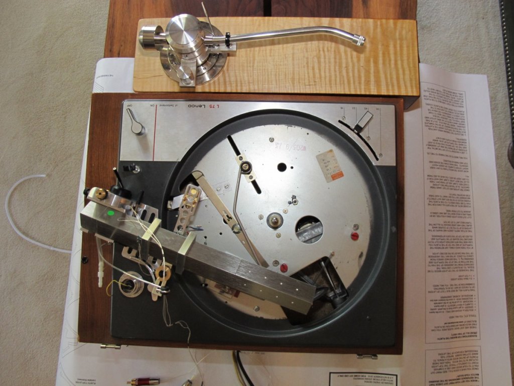

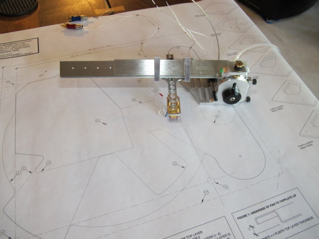

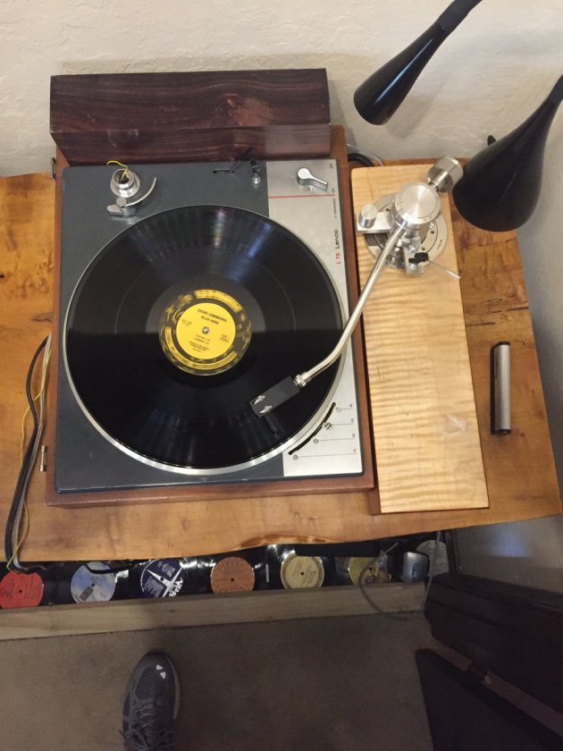

Made it to Kinkos to get the template printed out.  The template is designed for A1 paper, but prints well on 24" x 36" paper here in the states.  Started by checking the TransFi tonearm placement.  It think it will work quite nicely.  By the way, I'm very impressed with the fit and finish of the TransFi tonearm.  I hooked up the air pump and quickly determined that the tonearm wasn't level as the carriage slid toward the end.  A quick twist of the alignment thumb screws remedied the problem.  Seems like it will be pretty straight forward to dial in.
Once I got the TransFi pretty much situated, I placed the Pioneer PA-70 tonearm to make sure everything would still play nicely with each other.  Looks like it will.

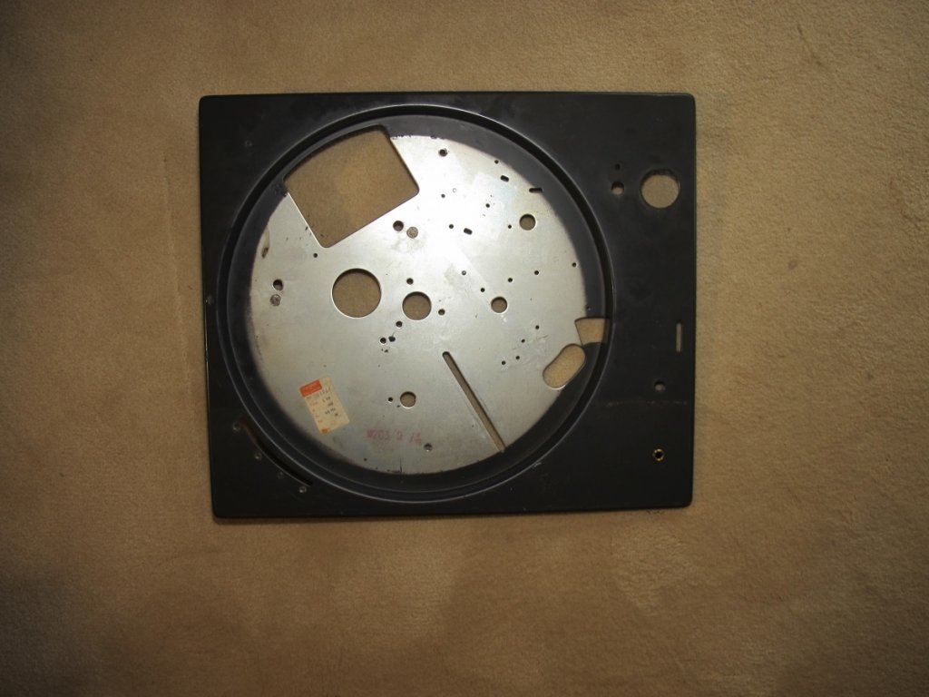

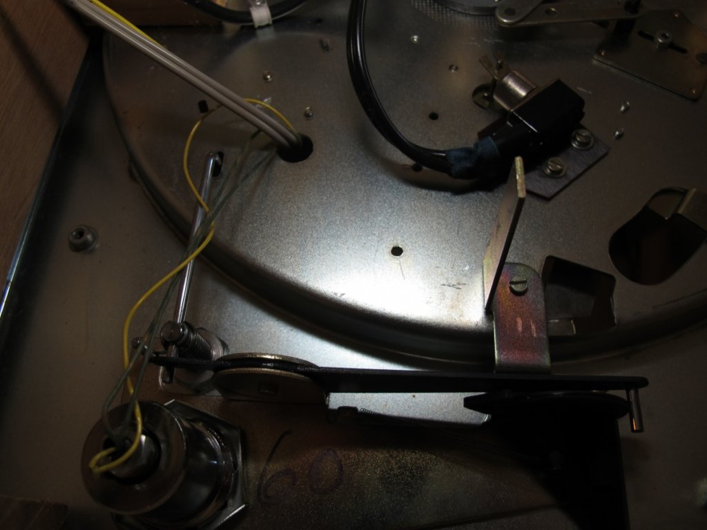

Now that I have the alignment pretty much figured out, it's time to strip the Lenco down.  I'll be cutting down the top plate so that it fits flush into a 22 mm deep cavity.  Of course that means I need to find/make a 22 mm thick top to my plinth.  I'm still noodling on that one.

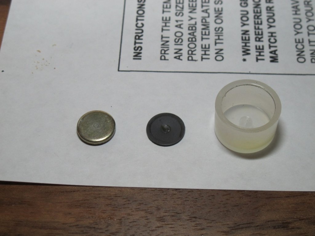

The bearing was dry, but the bottom cap is in good condition--not that it matters all that much as I'll be replacing the bottom cap with a machined piece that's threaded for additional bracing from the bottom.  The spindle seems to be in good condition.  I've got a replacement Si3N4 ball bearing for the bottom, as well as a new PEEK thrust plate.
The top plate is all stripped down and ready for trimming to size.  That's a task for next weekend.

Take a look at Richlite, it is also compressed wood similar to Panzerholz. Richlite can be machined with carbide tools and is readily available, if you are lucky a local distributer or installer will have samples or scraps like sink cutouts to play with.
http://www.richlite.com/
Here is my un-scientific tap test of three materials including Richlite:
https://www.youtube.com/watch?v=SkSxH40x5SA
Search for "Richlite" on AC, I have made many posts over the years with my damping experiments.
