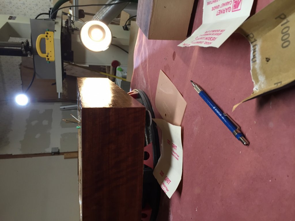

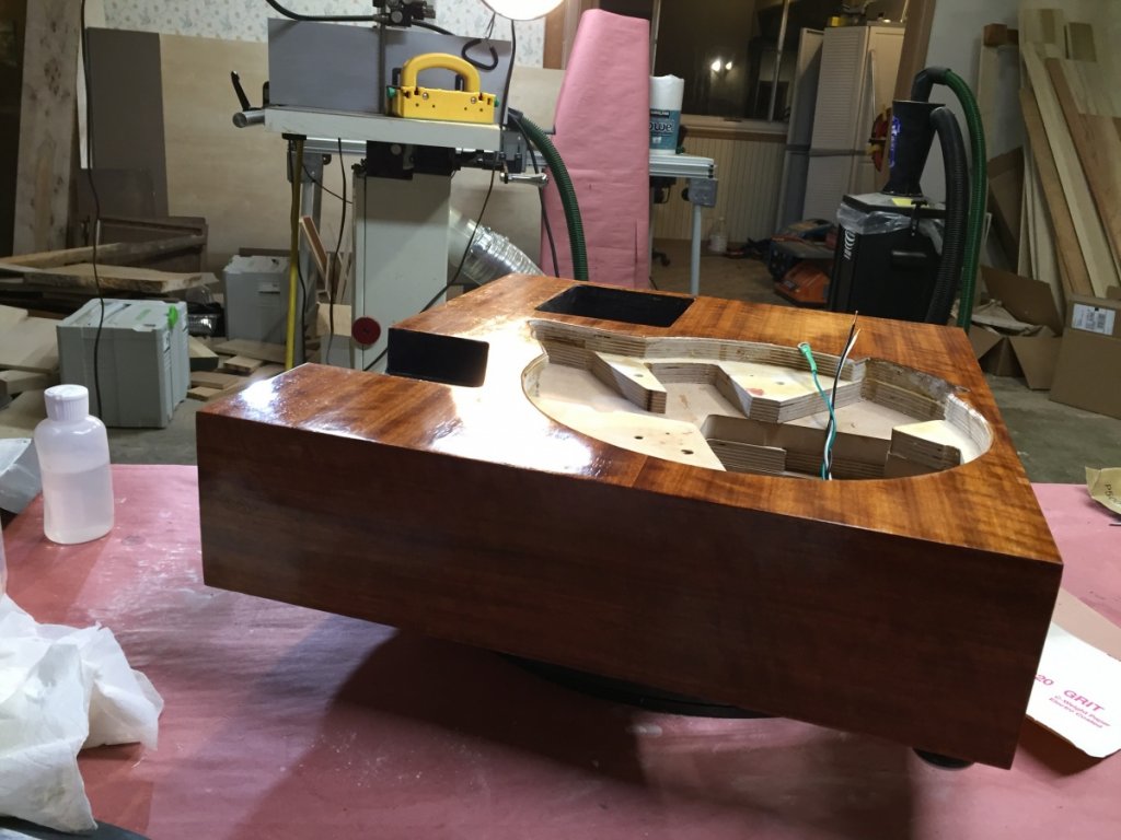

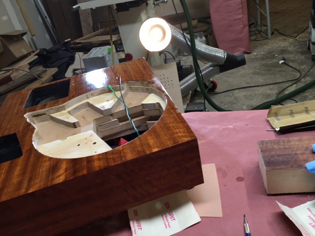

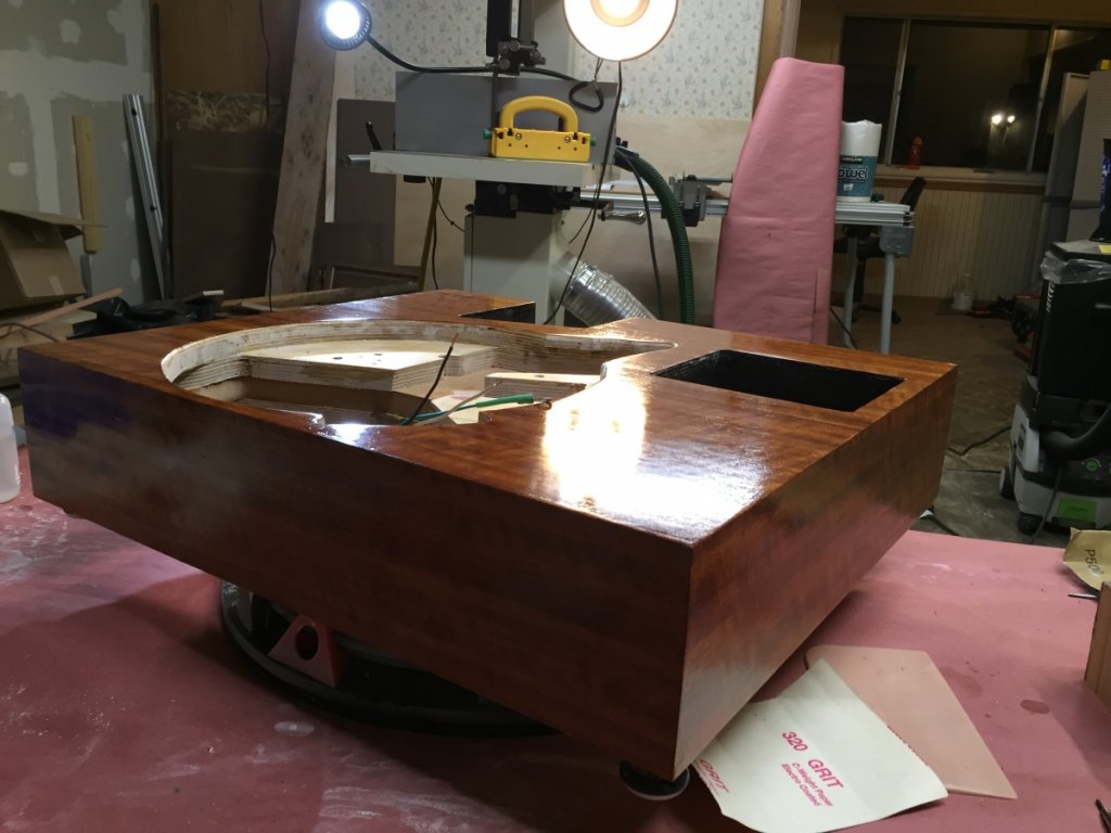

I dropped down to 320 wet/dry with mineral spirits, then back up to 500 and 1000.  The surface was looking decent (definitely not perfect, as there were still quite a few "shiny" spots), and I decided to give French polish another shot.
Holy cow--I was getting a "ghost" trail and everything.  The pore filling definitely made a difference.  I used the Camellia oil to lube the rubber and the finish started appearing.  It's still not museum quality, but it looks pretty darned nice, and definitely good enough for jazz!  You can see some undulations in the surface, but there's also a pretty clear image of the light bulb at a low angle, so it's pretty specular.
Anyway, I'm calling this project done!  Gonna let the shellac harden overnight, then bring everything inside for assembly.

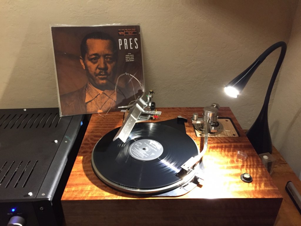

IT'S ALIVE!!!!!
 :D :thumb: :green: 8)

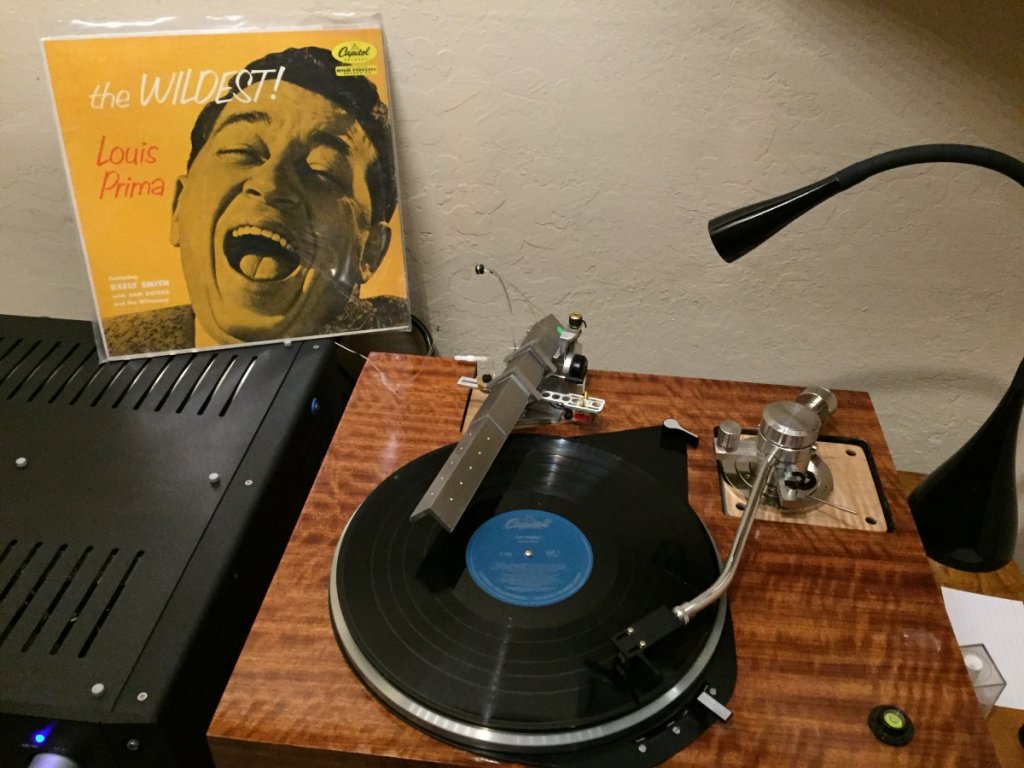

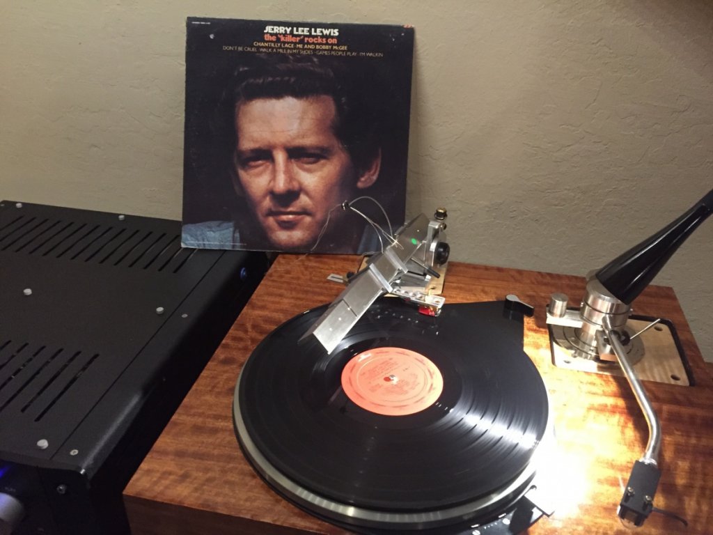

Just have the mono tonearm set up and playing for the time being.  Still need to tweak VTA as the arm is a tad too high even with two Vibra-Stop mats, but Lester is sounding divine and more importantly (for the moment) there are no strange noises from the turntable or cartridge!
Life is good!

Thanks.  Before I get to the sound I just want to say I thought I was building this massive, heavy, vibration absorbing and repelling plinth.  And I did.  But when I lifted my old Well Tempered Turntable off its perch I realized my 40 lb turntable was light by about 20 lbs.  That WTT is one heavy sucker!
Anyway, no epiphanies, but then again after only spinning one LP, and one that I'm not terribly familiar with, I'm not at all disappointed.  In fact, I'm delighted there weren't more issues (hums, buzz, etc.) and the fact that Lester's sax came swimmingly through was very nice indeed.
I am looking forward to getting the TransFi tonearm set up, first with the AT 150 MLX MM cartridge, then with the Lyra Kleos.
I'll post more updates as I get them.

Got the Pioneer PA-70 VTA adjusted by eye (tonearm level with the record) and the Miyajima Zero is sounding absolutely splendid with Louis Prima this morning!  Bass slam is fantastic, as is tonality of reeds and brass.  Drums just sound right, as do vocals.  Will need to get the stereo cartridge set up before I can listen to my reference "Kind of Blue" for a more objective comparative.  Until then I'm groovin' on my mono records!
Will need to get out my USB microscope and Feickert's Adjust+ in the next few days to dial things in further.  I'm not sure how critical alignment is with a mono cartridge?
One of the things I like about the TransFi tonearm is the precision of adjusting all aspects of cartridge alignment, which should allow me to dial in the Lyra Kleos to actually hear an improvement over the Delos (my WTT Reference was forgiving, but also I suspect not the best arm to get the most out of the Kleos).

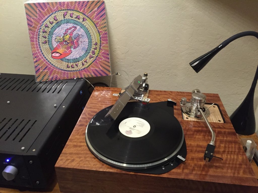

Got the TransFi arm aligned and plumbed.  I'm listening to a crappy used record with an AT150/ATN100E cartridge.  No strange noises!  When I have more confidence in the set up (and my ability to use it) I'll pop on the 150 MLX stylus and listen to a few better records.
ACHiPo
Re: My New Vinyl Adventure--Building a Turntable
« Reply #99 on: 6 Oct 2016, 04:19 am »
Ok, so I couldn't wait.  Put on a decent copy of Little Feat "Let it Roll" and roll it does! :thumb:
Still running the 100E stylus, but it sounds pretty darned good.  Looking forward to getting on a familiar cartridge with a better stylus!
