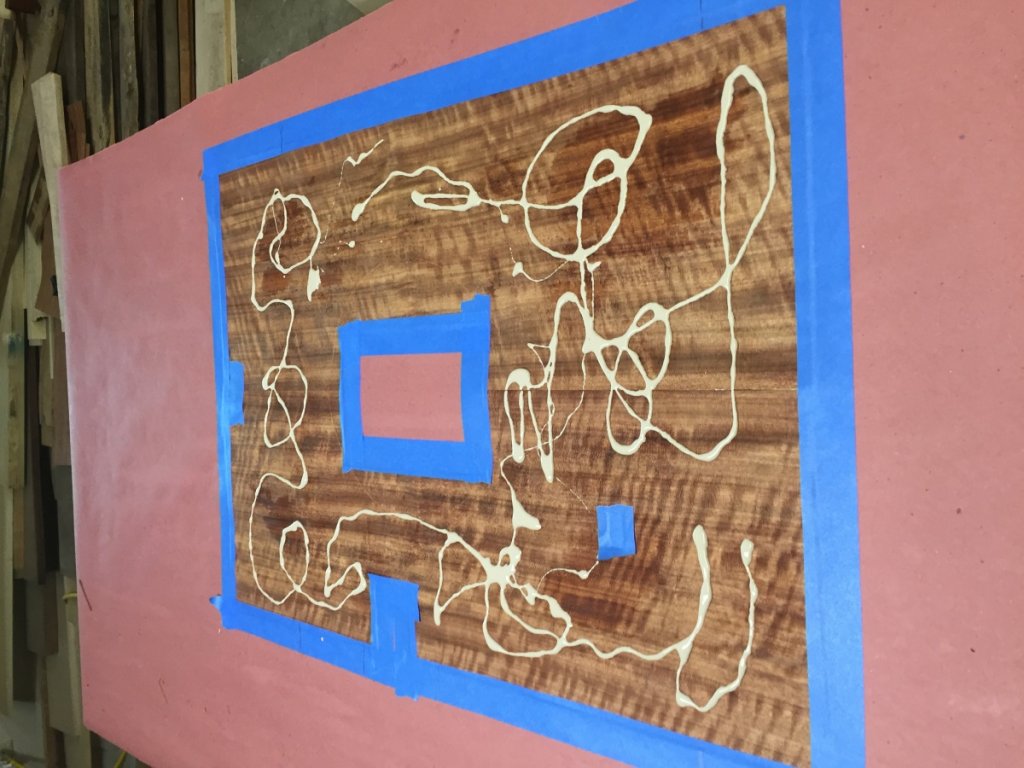

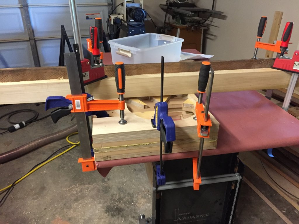

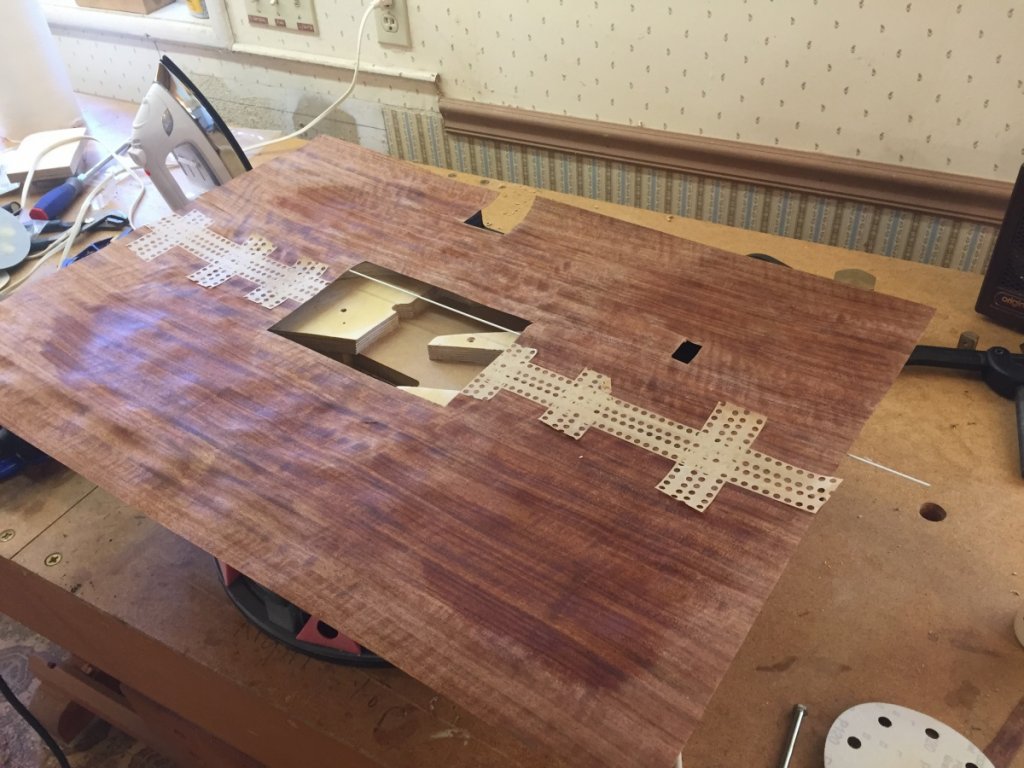

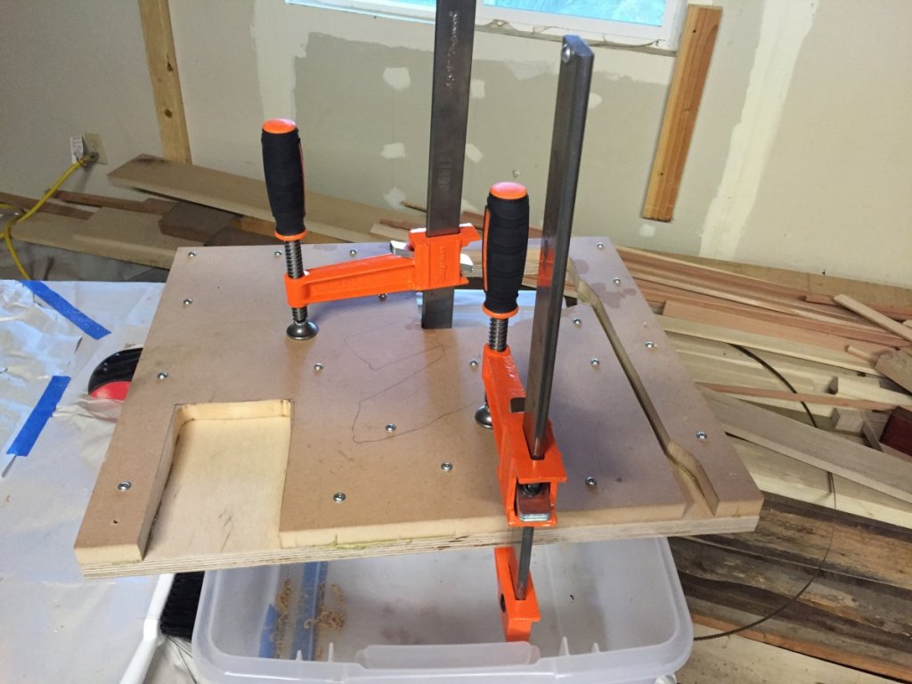

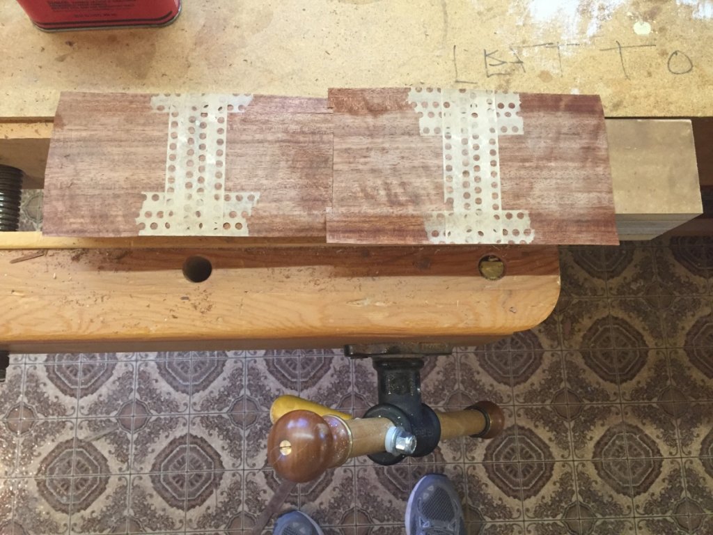

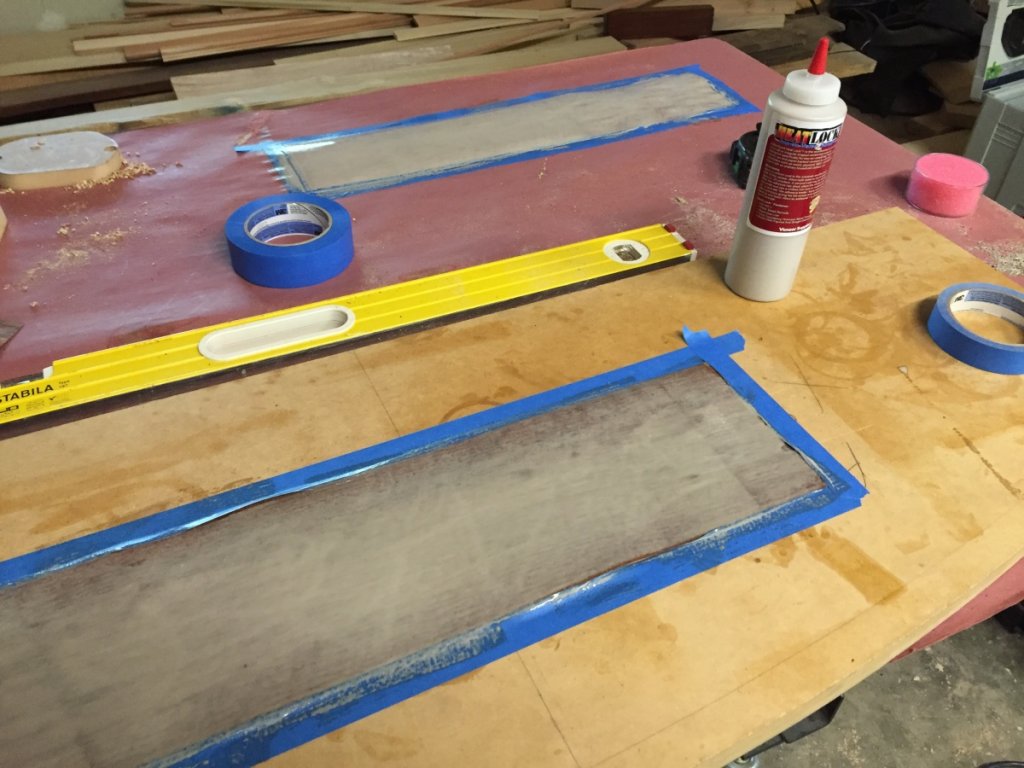

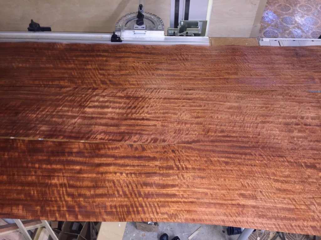

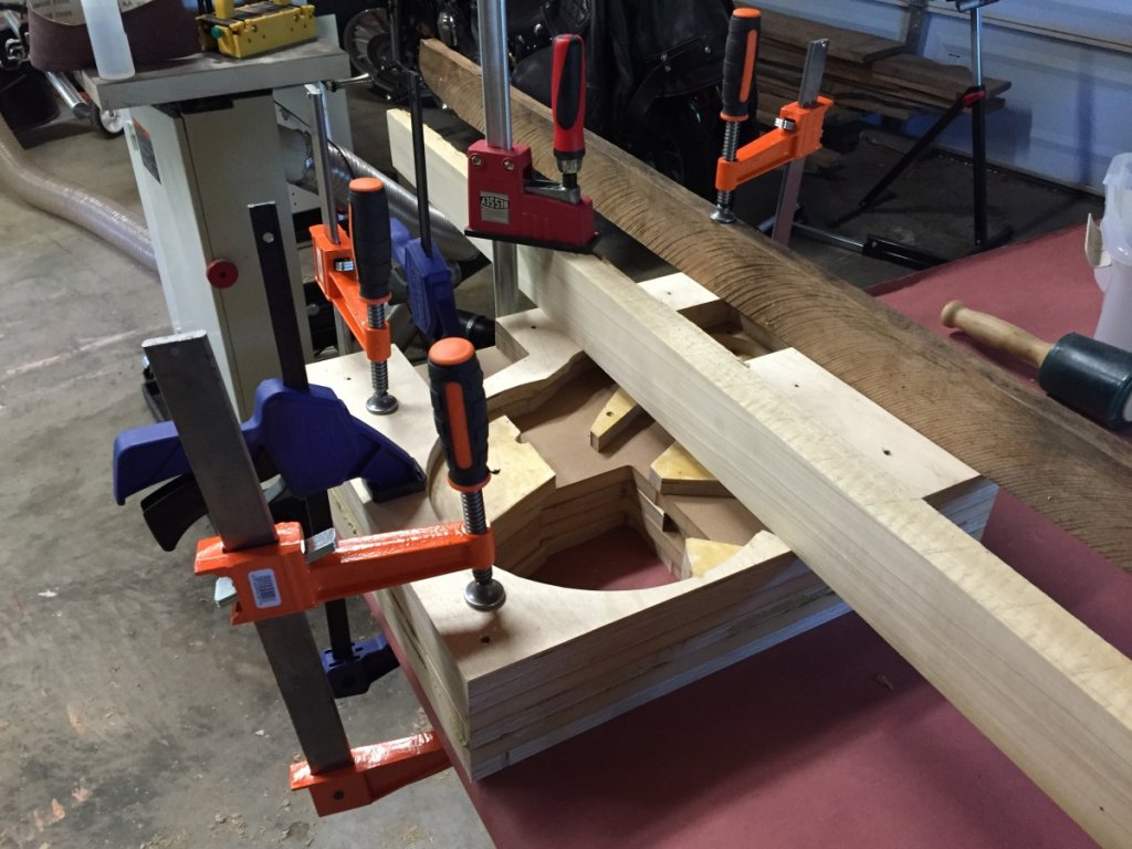

A little more progress today.  The veneer arrived last weekend, but I didn't get a chance to look through it until today.  I think it's going to be stunning!
Applied veneer softener and pressed it flat.  Also trimmed off a piece for practice.
Got 3  + 2 layers laminated with the polyurethane glue.  It has a very long curing time, which is nice, but also makes things a mess as it's very easy to transfer glue from gloves to other items.
Also got the 1/4"-20 threaded inserts installed, and the armboards drilled and countersunk for allen head bolts.

What veneer is that?
Bob,
It's curly Etimoe.   I found a turntable I liked that had similar veneer.  I ordered the Etimoe, then learned the turntable I liked was curly Koa, which is about 3x the price.  All told I'm happy with the Etimoe choice.

ACHiPo
Re: My New Vinyl Adventure--Building a Turntable
« Reply #53 on: 5 Sep 2016, 11:29 pm »
Norman,
Thanks for your kind words and your comprehensive post!

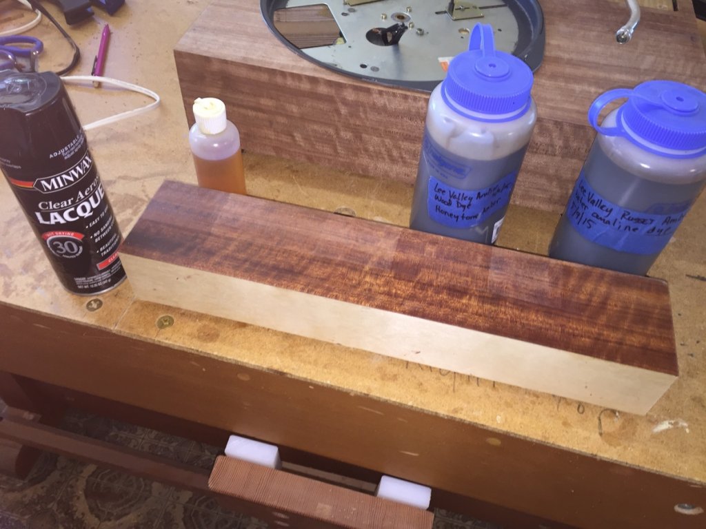

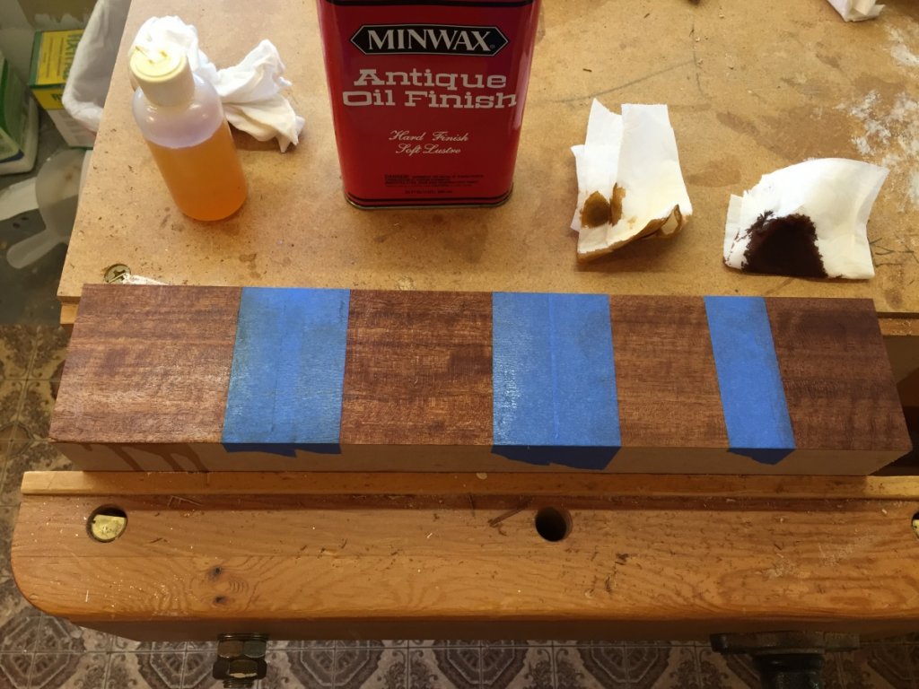

I have not taken any pictures, but I've made up a couple laminations of plywood and MDF to practice veneering and experiment with finishes.  I have an HVLP spray set up, but haven't used it yet, so will likely stick with things I've done successfully before.
I've done French polish successfully before on curly maple, and like working with shellac as it's repairable.  It is not, however, durable, and I'm not sure how things like Stylast will affect if there's an accident.  I've also built up gloss urethane finishes and sanded and buffed them to a mirror shine, but I wasn't always happy with the result, as it can look plastic-y.  I've done quite a bit with aniline dye and rubbed oil finishes--simple, easy to repair, and can be quite beautiful with highly figured wood, but I think I want something with a bit more "sizzle" for this piece.  I have not worked with lacquer, but have seen pretty impressive results from a spray can IF you "finish the finish" as you say with successively smoother abrasives and finally with automotive rubbing compounds (I wouldn't want to use a rotary polisher like the one in your picture--I much prefer a random-orbit buffer as it's less likely to damage the finish in the case of an accident).

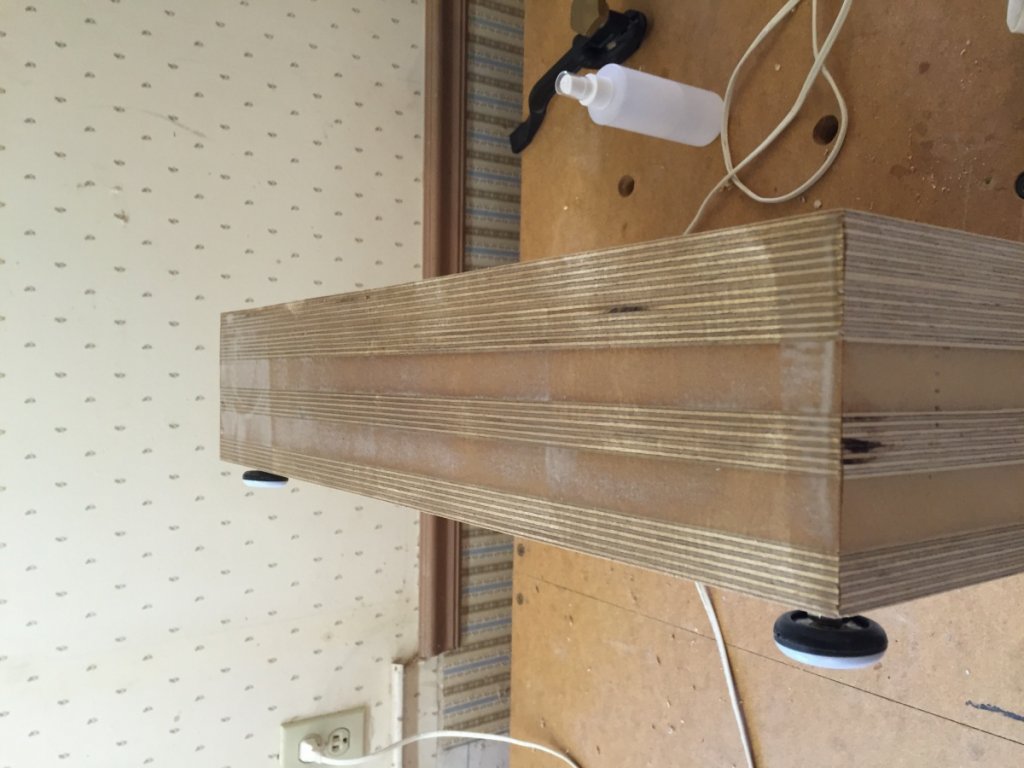

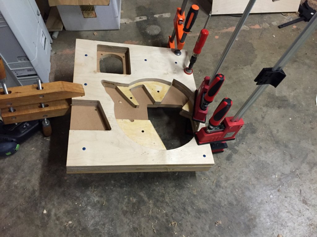

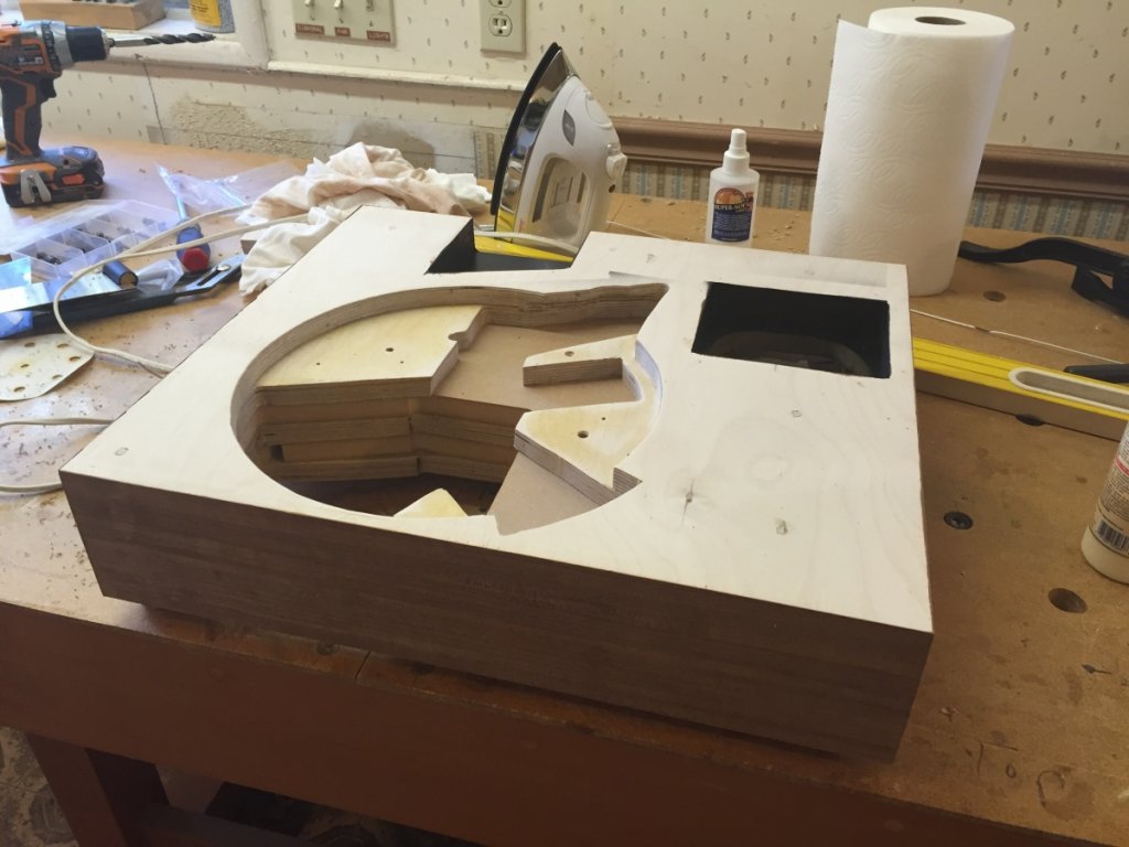

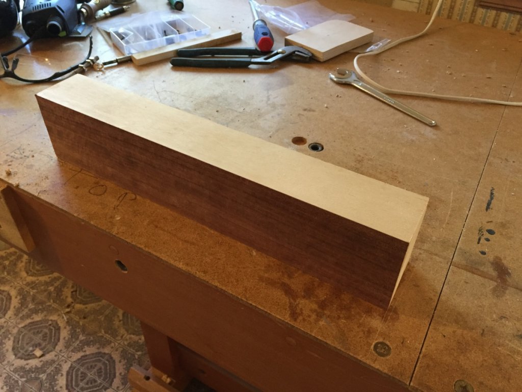

Here's my progress today:

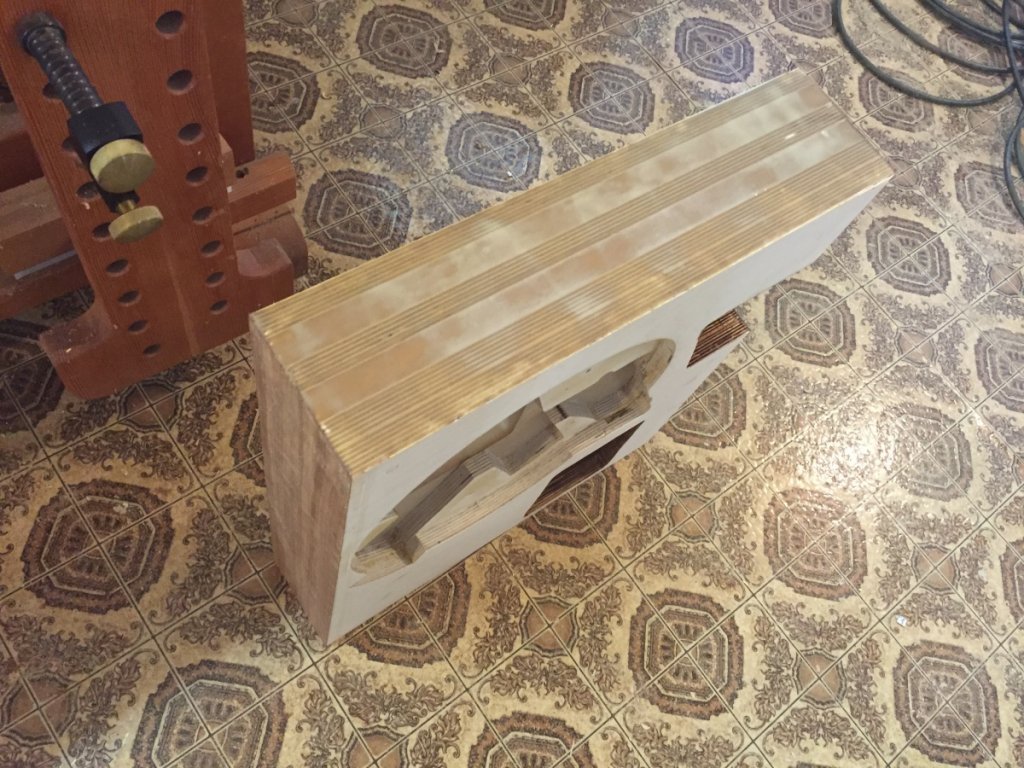

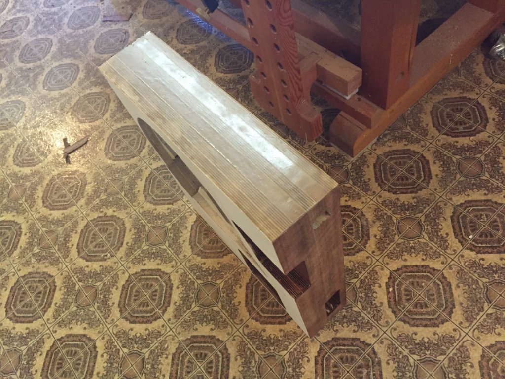

The glulam/CLD plinth is complete and curing!
I ended up drilling 1/4" holes all the way through the plinth to keep the layers aligned with dowels.  I should have done that at the beginning and it would have saved me quite a bit of time.

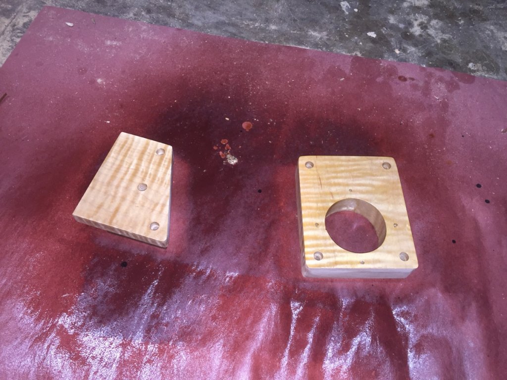

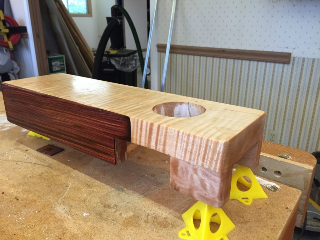

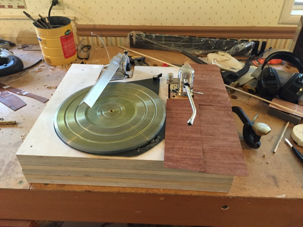

I played around a bit with the tonearms and veneer to visualize finishing the pan.  You can see the smallish pieces of veneer that will be used for practice veneering and finishing.

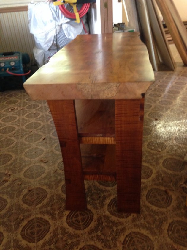

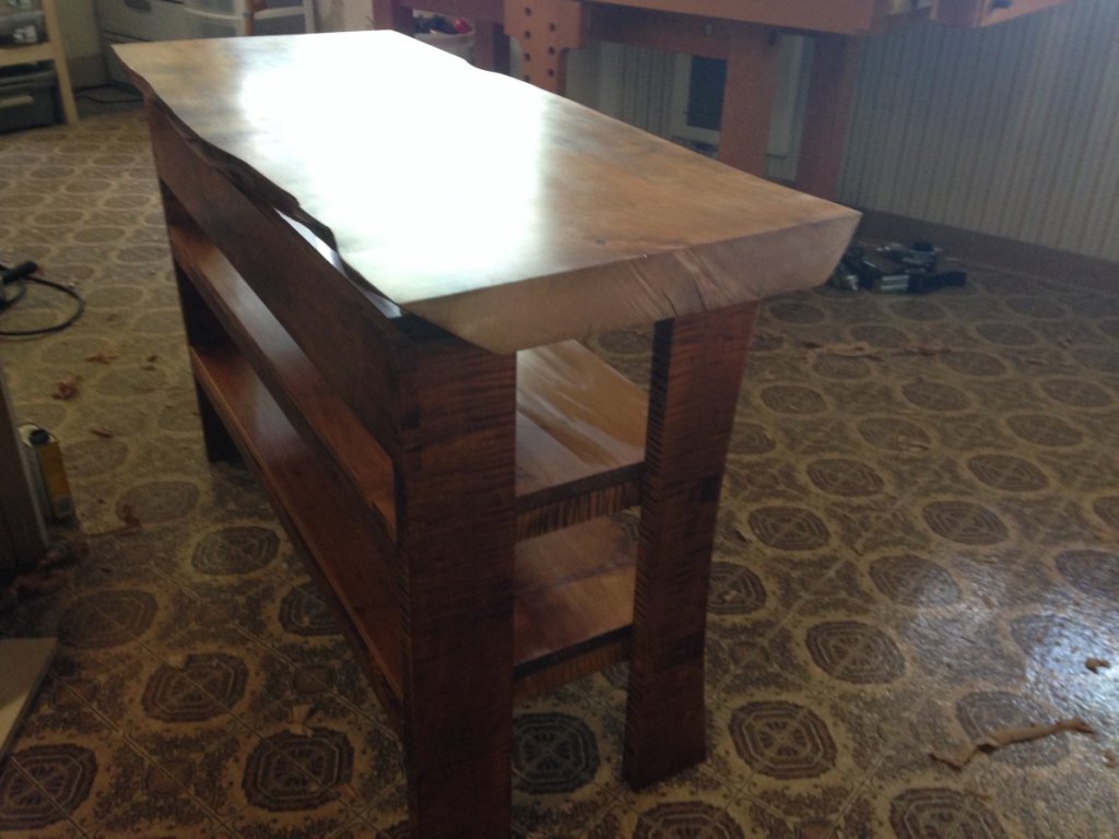

Here is a simple aniline-dyed, blonde shellac, and oil finished tonearm pod I did a few months ago.  It's made from curly maple with cocobolo veneer I resawed with my bandsaw:
...and a bigger piece that preceded my tonearm pod (no veneer):

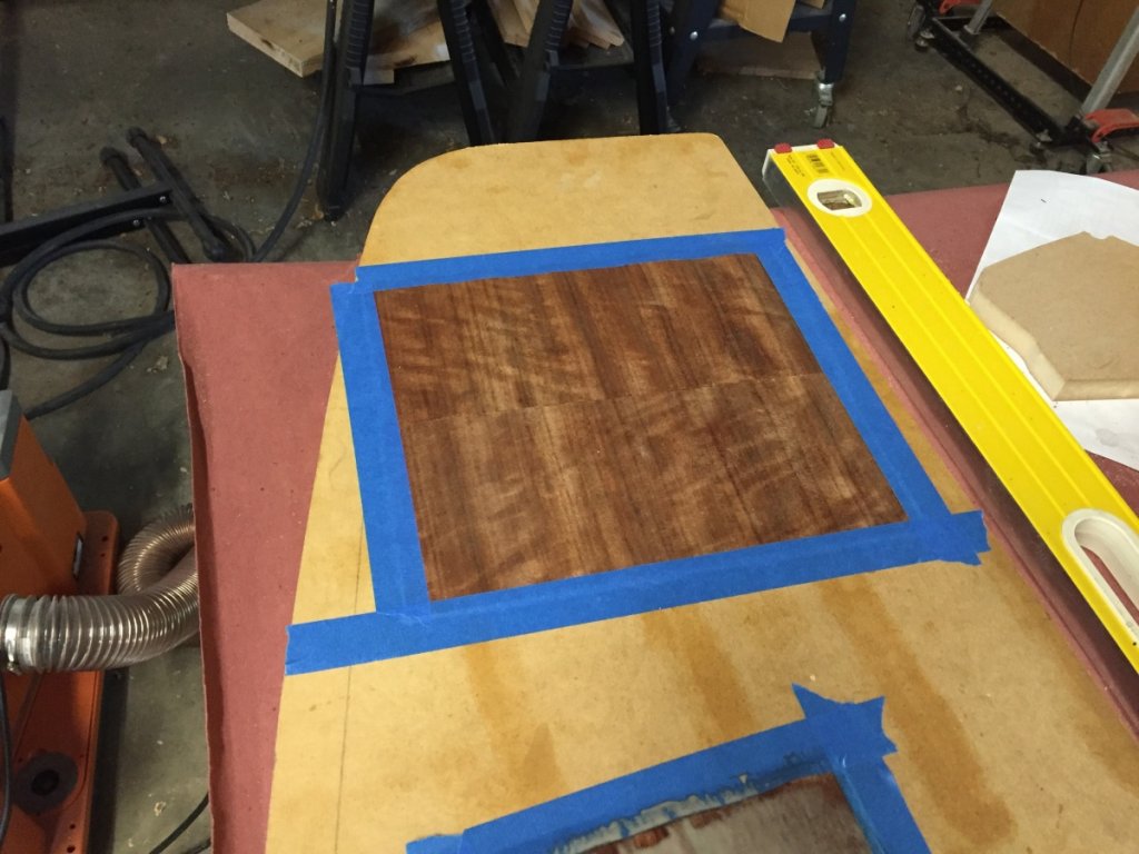

Feeling like it's starting to come together.  Got the sides veneered, as well as a few finish experiments started on my practice veneer piece.
Tomorrow I veneer the top (saved the hardest for last) and finish the finish experiments.

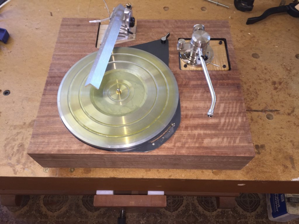

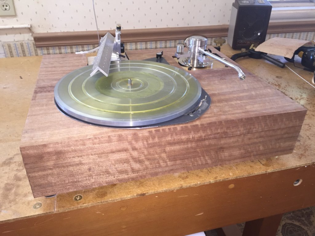

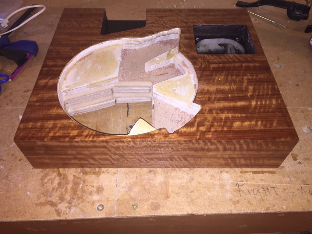

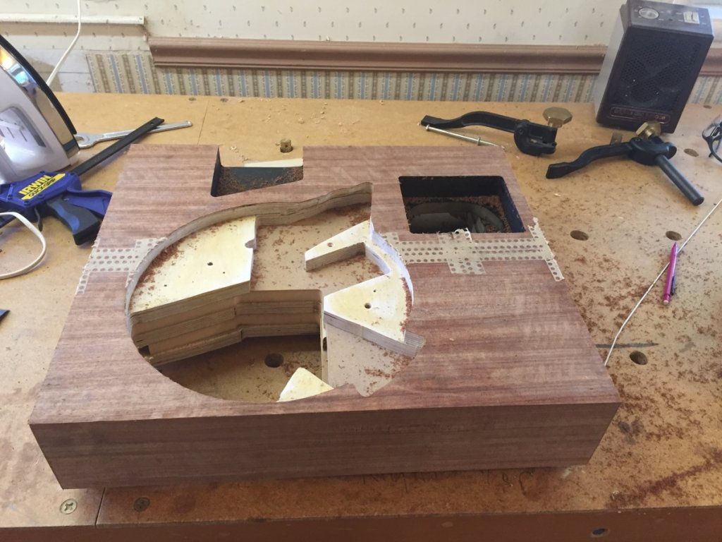

Got all the veneering done!
Couldn't resist mocking it up.  I think I'll like it!

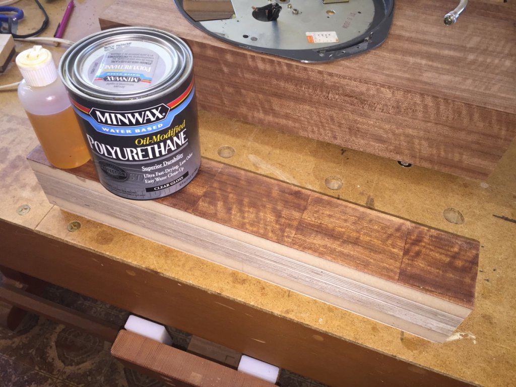

Experimented with finishes--shellac with/without aniline dye stain (two colors), oil, rattle can lacquer and water-based poly.  Conclusions:  The stain doesn't do jack on etimoe, so I can skip that step.  Shellac as a base definitely brings out the chatoyance so that will be in the final finish regimen.  The lacquer is ok, but I had more flaws (cloudy spots, etc.) than with the water-based poly.  I haven't gotten either of them to a gloss finish, but the water-based poly on shellac looks and buffed to a low sheen looks nice.  The cell phone photos don't do a great job of highlighting the differences.

First coat of shellac on the plinth, and a couple quick coats of lacquer on the arm boards.
