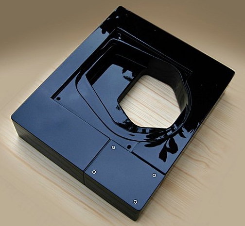

A Google image search for "cast turntable plinth" has a lot of interesting ideas. Has anyone come across a how to guide to casting one?
The guys at Plinth-Design really know what they are doing
http://www.plinth-design.com/
Here is a Lenco mold, you will have to make one of these before casting.
http://www.lencoheaven.net/forum/index.php?topic=4448.0
The member known as "Rap" seems to have it pretty well sorted, plus he's an acoustical geologist, so knows a thing or three about vibration transmission and absorption in solids.
http://lenco.reference.clicforum.fr/t2198-Donc-je-recommence.htm?q=rap

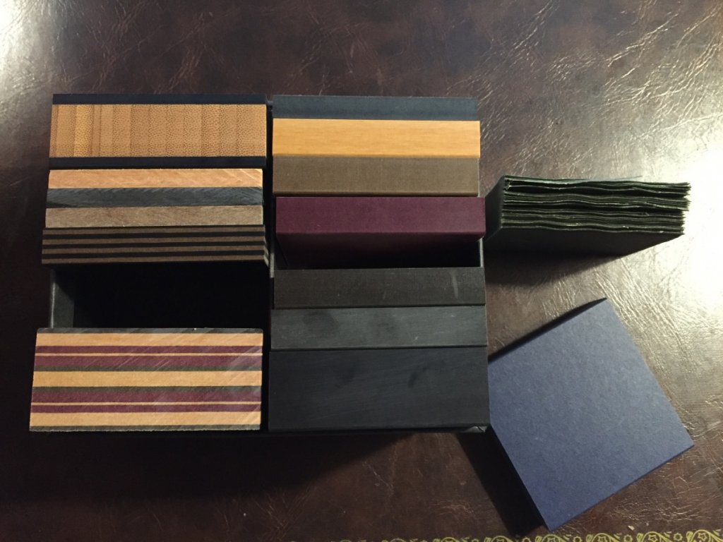

I received a box of samples from Richlite...
The box is quite heavy, which makes me think the product is pretty dense.  Very interesting laminations available...
The company gave me a list of local fabricators that use the product, so hopefully I'll be able to find some remnants to play with.  The product comes in 4' x 8' sheets and sells for $8/sf to >$30/sf, so in the range of Panzerholz.

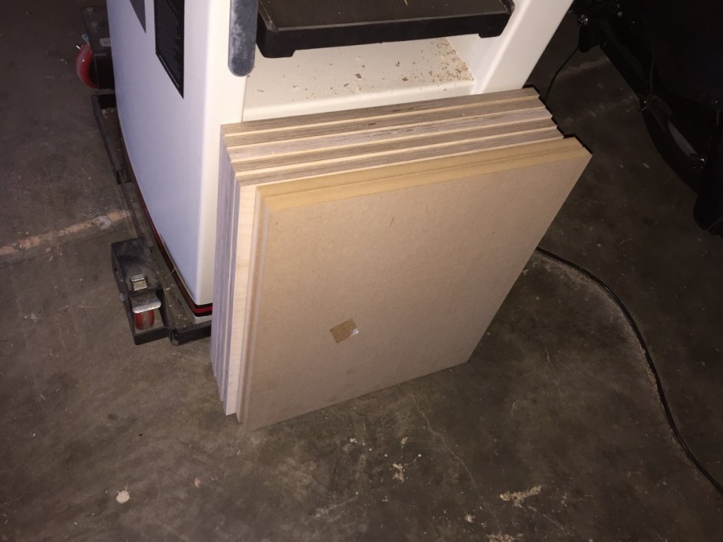

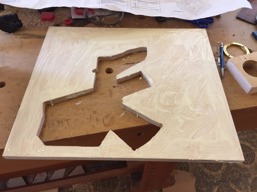

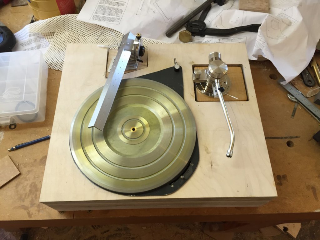

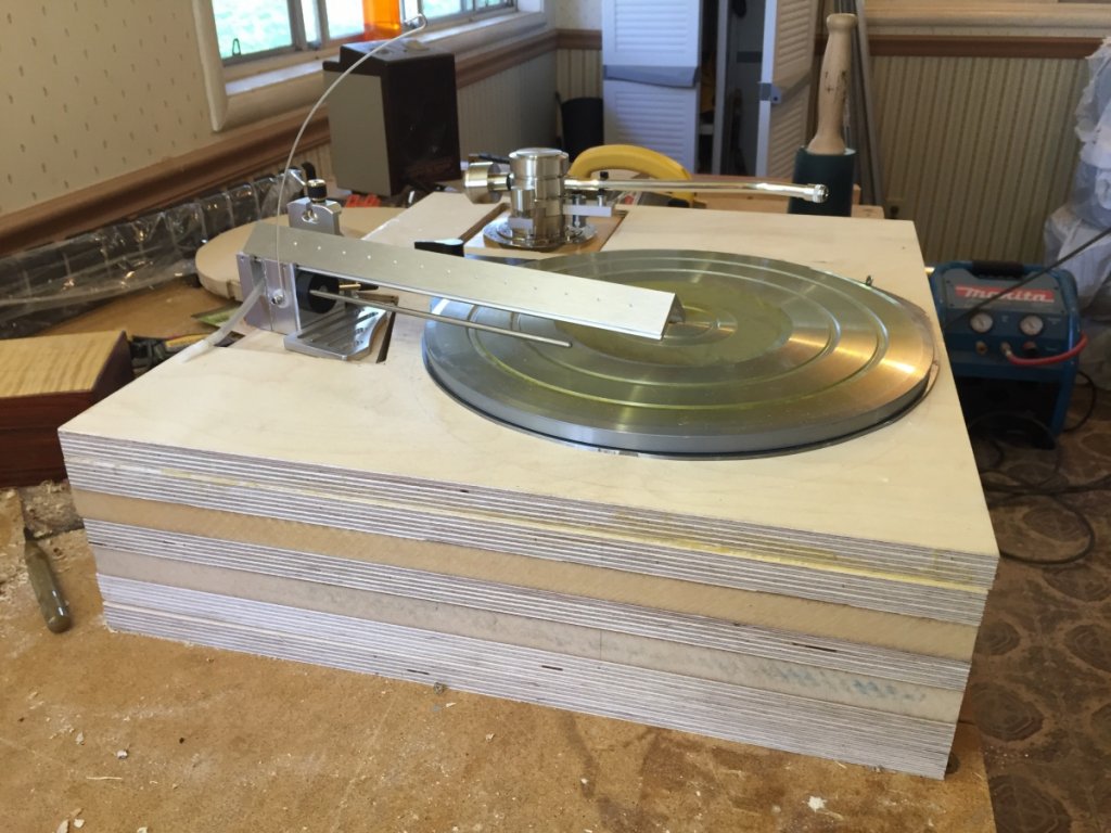

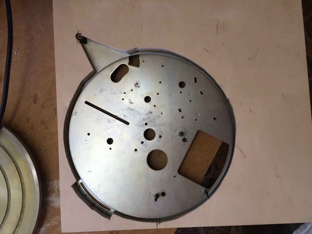

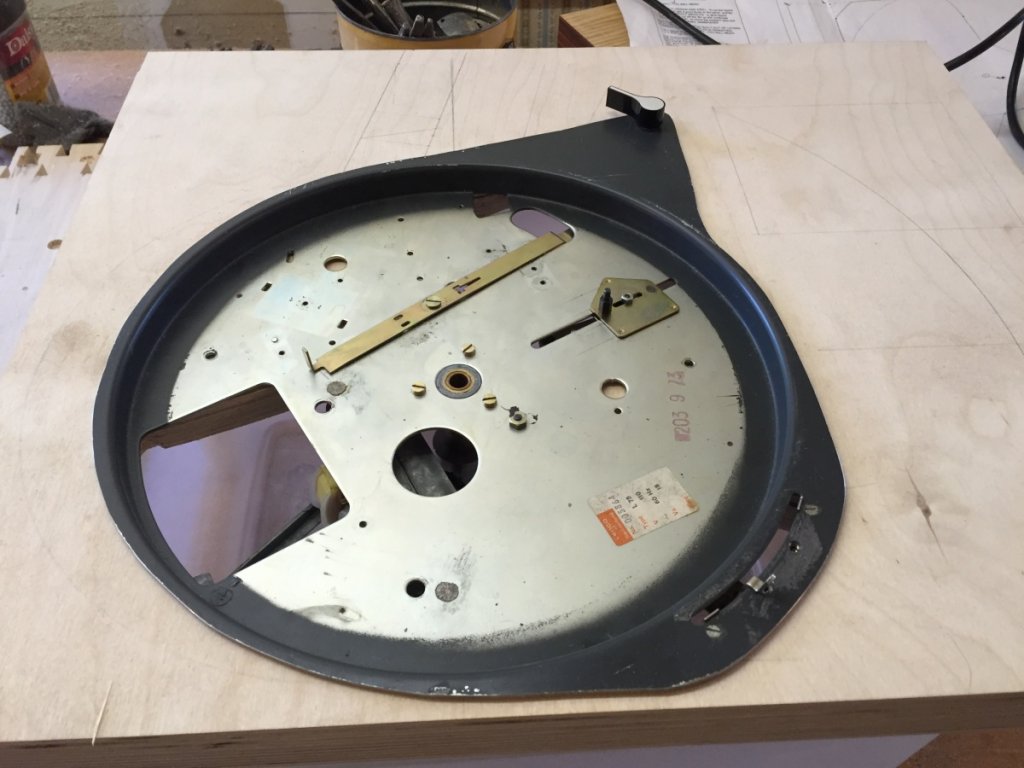

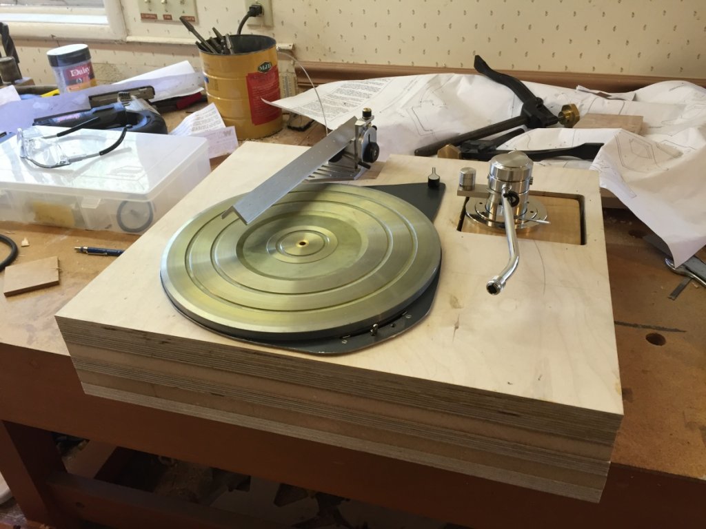

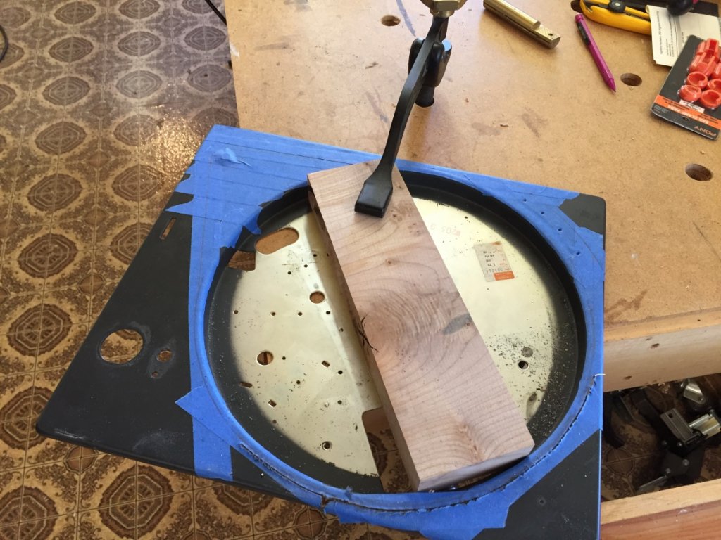

Well I dove in head first this weekend.  First task was to trim the top plate...
No turning back now!

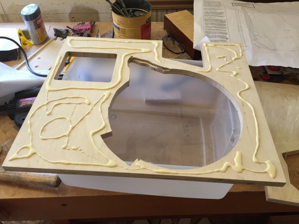

With the top plate roughed out, it was on to the plinth layers.
I ended up with an oopsie on one of the plinth layers, so decided to mock up the top layer.   Good thing I did, as the template I used was made to keep the top plate in tact, and thus the cut out for the pan was a bit too big.  It also gave me the chance to figure out a few other things on layout and construction.
Plinth will be 6 layers of Baltic Birch plywood with a couple MDF layers for flavor  :lol:  The top two layers will both be plywood and glued with wood glue (no constrained layer damping, just a glulam).  The other 4 layers will alternate MDF and ply, with polyurethane construction adhesive (cured durometer ~60, so flexible and enabling a constrained layer sandwich).
Got the top two layers cut out and figured out the tone arm board locations and sizes.
That's all for this weekend.  Next weekend plan to get the other 4 layers cut, the arm board cut outs done, and everything glued and clamped.  I might even get the top plate stripped and prepped for paint.

Just realized I forgot to update progress as promised.

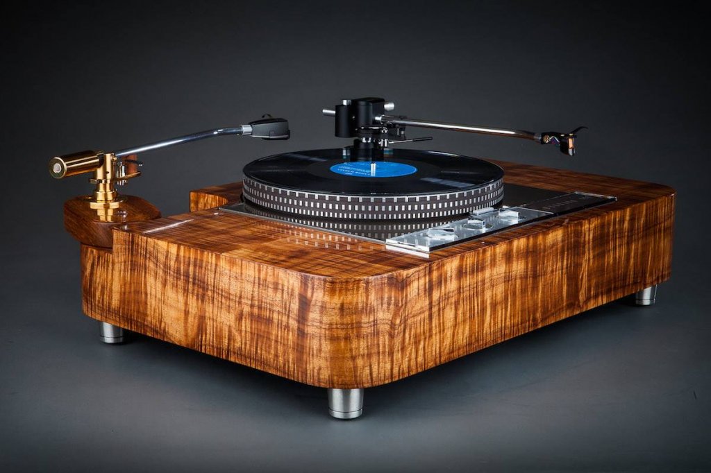

Veneer ordered--I'm shooting for something like this:
I think the pictured table is curly Koa ($$$), although I bought curly Etimoe.
All layers have been cut out at this point, and the armboards are roughed out as well...

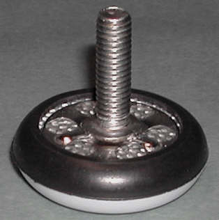

Also ordered three of Herbie's feet...
http://herbiesaudiolab.net/studgl2.jpg

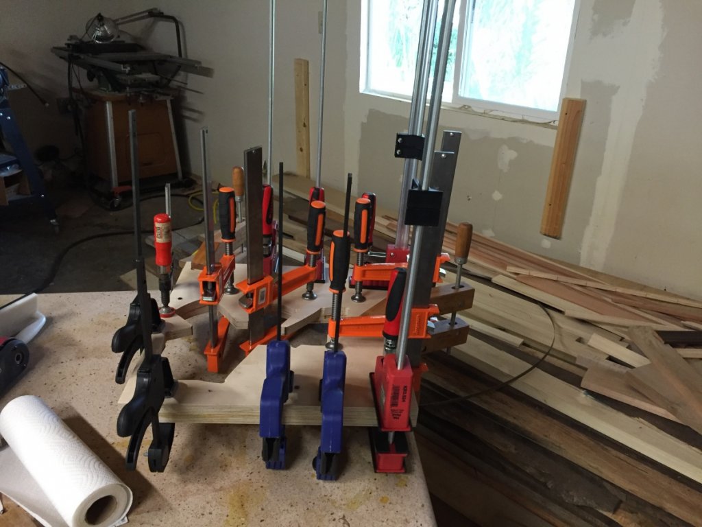

Family is visiting this weekend, so no progress, but hopefully I can get everything laminated next weekend with the polyurethane glue and maybe even get it sanded and prepped for veneer.  Also need to get the pan shaped, stripped, sanded, and prepped for paint.
Have you used these feet w a turntable before?
Jim
ACHiPo
Re: My New Vinyl Adventure--Building a Turntable
« Reply #37 on: 29 Aug 2016, 06:53 am »
Jim
This is my first turntable build, so no I haven't.  They were recommended, and seem like they'll work.  I couldn't find anything I liked better.
