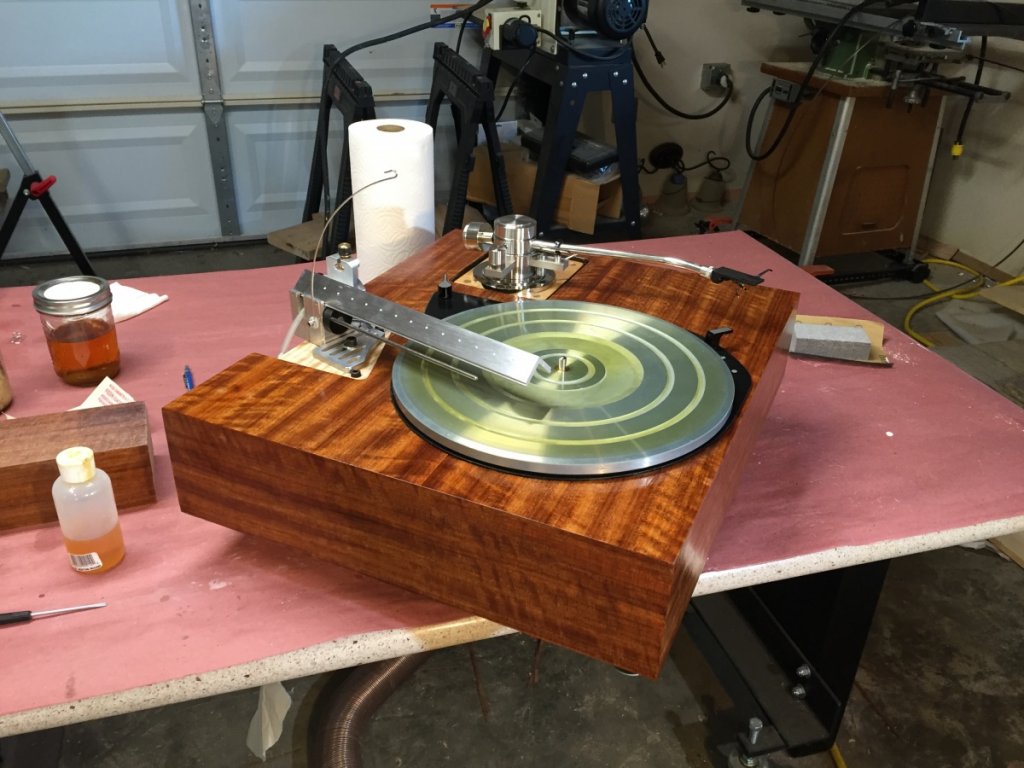

Thanks Guy and Folsom.  Was wondering if everyone nodded off. :lol:  Also just a tad offended that no one complimented me on the rather fancy wainscoting and floral wallpaper in my shop.  :wink: Yes, there is a story there.
Wallpaper's nice but I like the turntable a lot better. I assumed shop was once a house...no? Do tell.

The detached garage that I use for my shop had been converted to a guest house back in the 40s.  The previous sellers had to do some repairs on it that required pulling a permit, but there was no record of the guest house conversion ever being permitted, so they needed to revert it back to its prior purpose before they could get a permit for the repairs.
At some point I'll remodel it into a true man-cave, but until then it's got 3 220V outlets, lots of 110V outlets, plenty of daylight and ventilation, no one complaining about saw dust or cluttered surfaces, wainscoting, and flowered wallpaper!

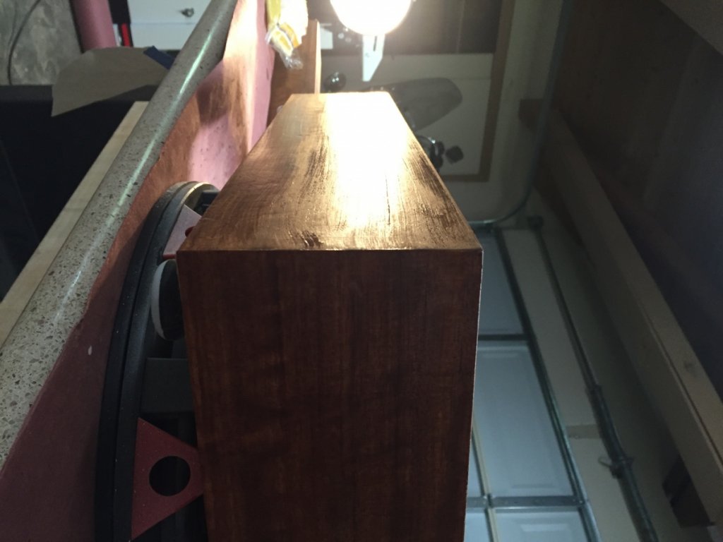

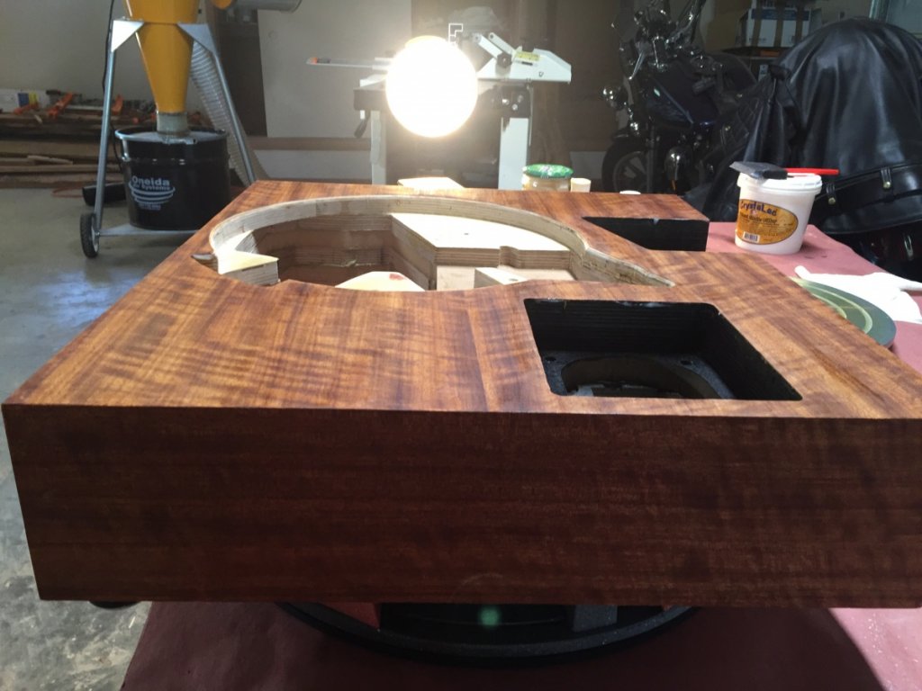

After a week and a half road trip, finally got back to the project this morning.  At this stage things are moving slowly, but definitely in the right direction.
Two coats of shellac, dry-sanded with 320 leaving the dust on the surface, then padded on two more coats to fill the pores...
I figure 4 more coats of rubbed shellac, with a "coat" defined as padding on as many passes as I can until the pad starts dragging (usually about 6-8 passes) will fill in the pores well enough to give the water-based poly a good substrate for a decent gloss finish.  I may stop with the shellac if I like the finish after a few more coats.

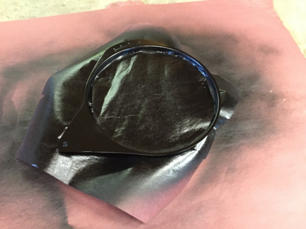

Got the pan painted as well.  I used appliance enamel which hopefully will be thick and hard enough to rub out to a good finish as well.  I'm not terribly impressed with how it looks after 3 coats.  I've got a buddy that owns a body shop, so if I can't get the finish I want with a rattle can I'll have him prep and shoot it.
I do like the black and etimoe color combo, though!

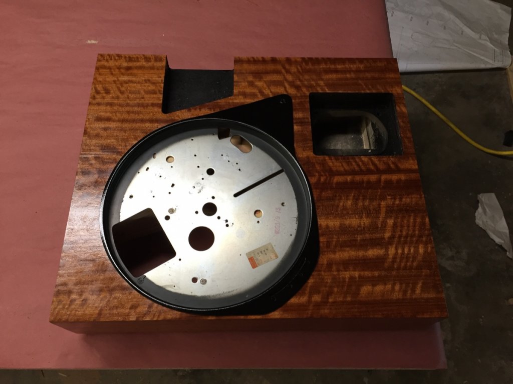

« Reply #70 on: 25 Sep 2016, 02:37 am »
Did one more sanding and coat this evening.  I think that will be the last sanding of shellac, as I've now gotten to the point where I don't seem to be filling in the grain/pores any more, and it seems like I'm removing shellac on the high spots all the way down to the veneer.  I'll give it a few more coats tomorrow, then let the finish outgas/cure for a few days before starting the water-based poly.
I did get the bearing cleaned and the spindle polished.  I'll rebuild the motor tomorrow between coats.
The pan paint turned out better than I thought.  I think a quick wet sanding with 600 and 1000 grit followed with a buffing should give it an acceptable finish.  Gonna give the paint a full week to cure before trying to rub it out (maybe longer--will do some research on how long the paint takes to fully cure).

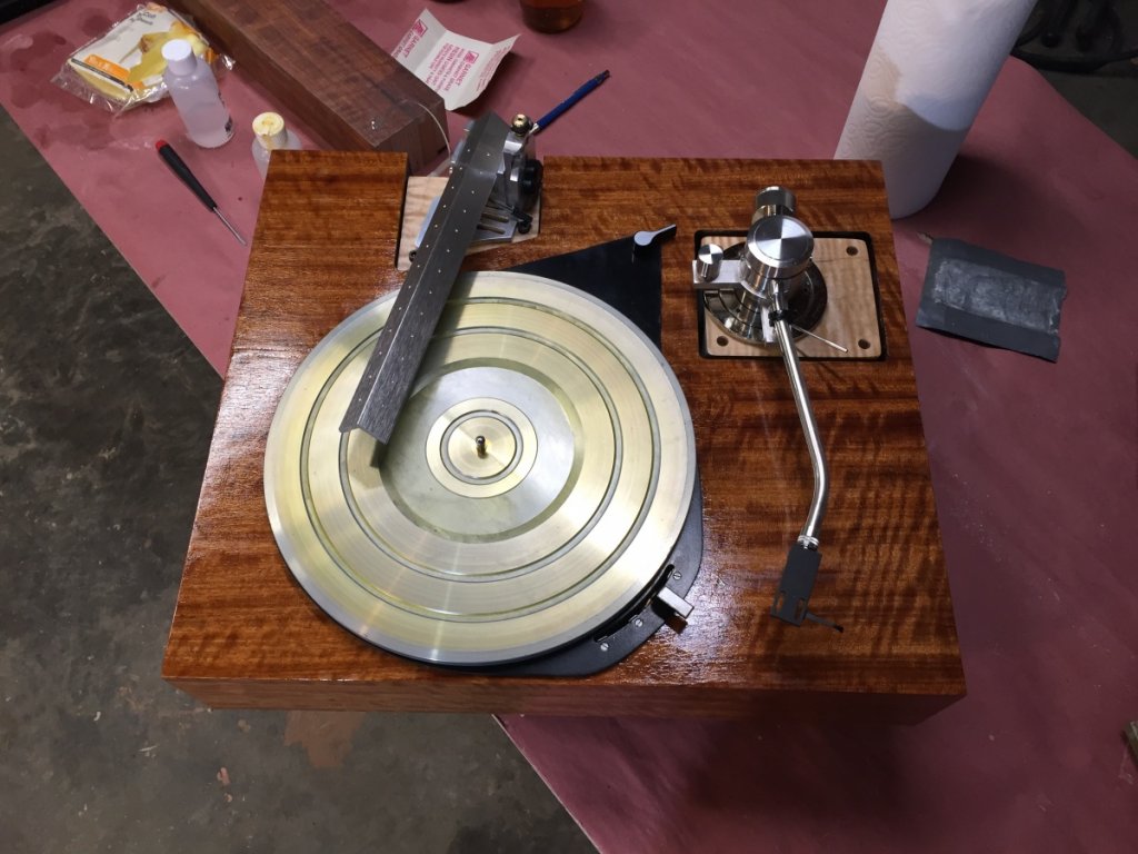

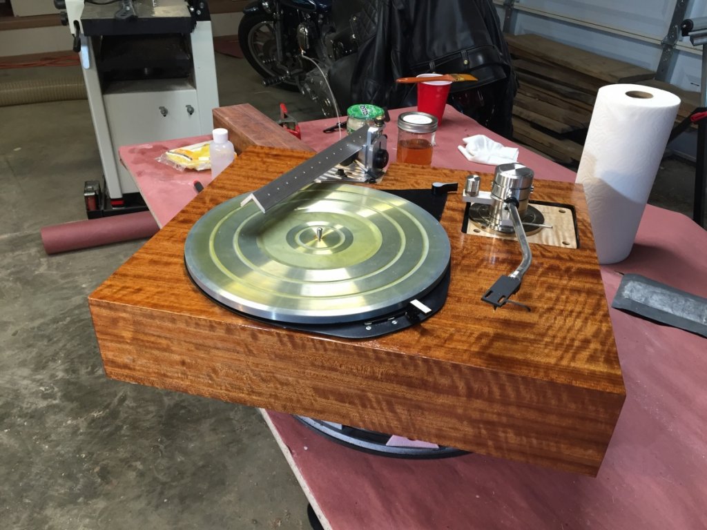

« Reply #71 on: 27 Sep 2016, 03:38 am »

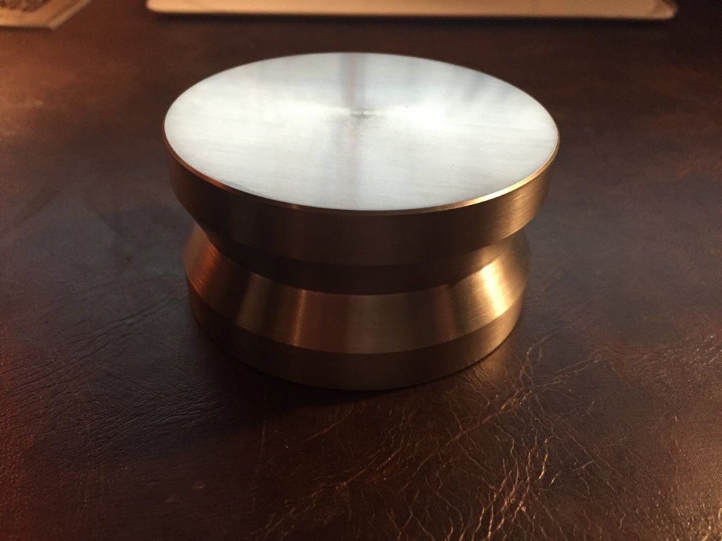

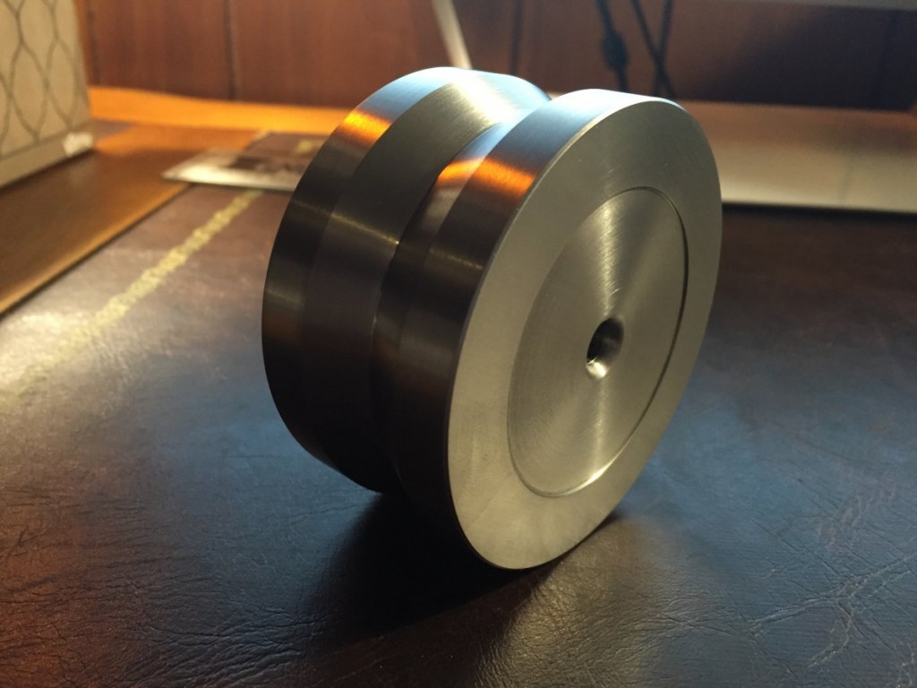

Lookey what showed up in the mail today--Aluminati's 1250g stainless record weight.  Not quite like running a second platter, but should help inertia a bit and actually usable with the TransFi tonearm.
I'm thinking a bit of Herbies Grunge material on the rim will be a nice addition, not to mention provide a bit of padding if I drop the mother!

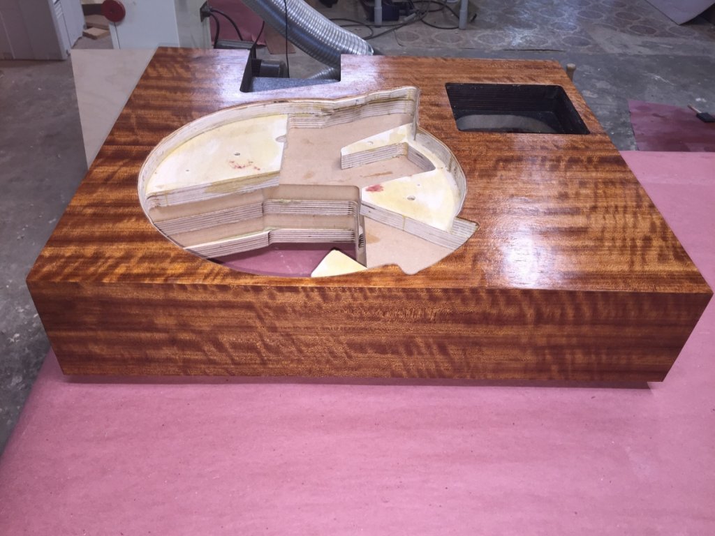

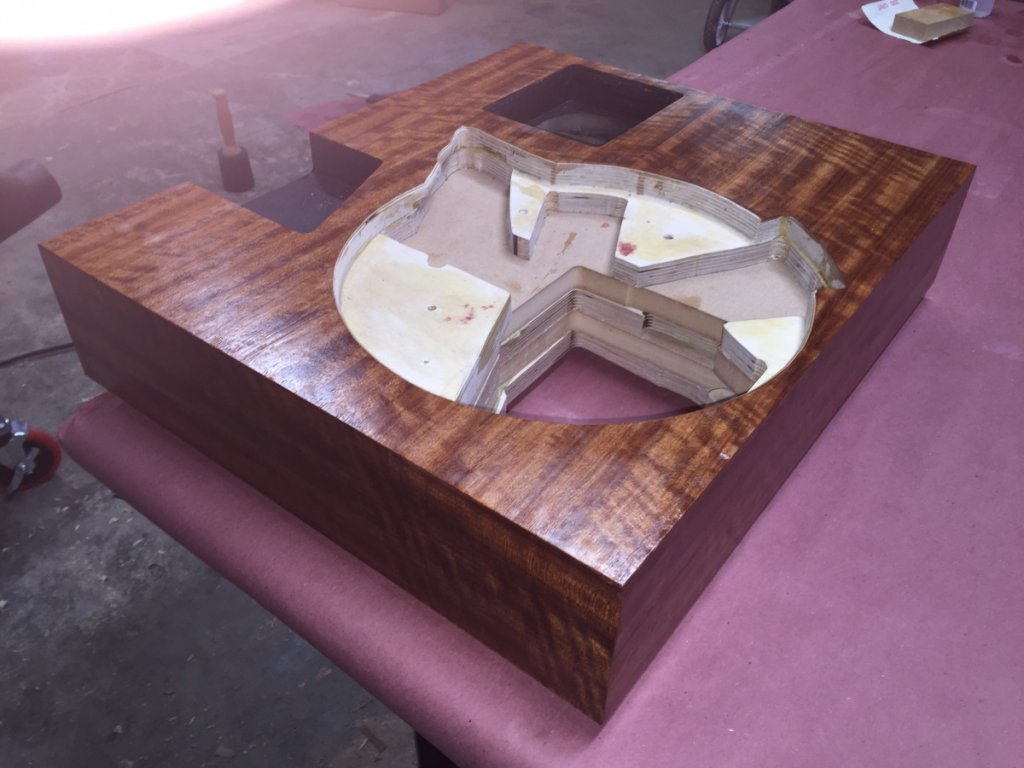

« Reply #75 on: 3 Oct 2016, 01:00 am »

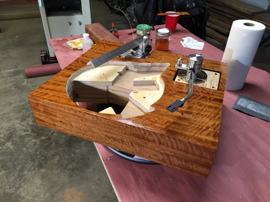

Definitely gaining on it!  Gave up on padding the finish as the pores were taking forever to fill.  Ordered this stuff:
And had at it.  It only took two coats to fill in the pores, then 6 more coats of brushed-on shellac leaves me here:
Still need to rub out the finish.  I've got a couple areas where the veneer is a few thousandths above the surrounding area.  If I can't build up the shellac adequately to level the surface I may need to give up on a gloss finish and settle for a satin finish.
