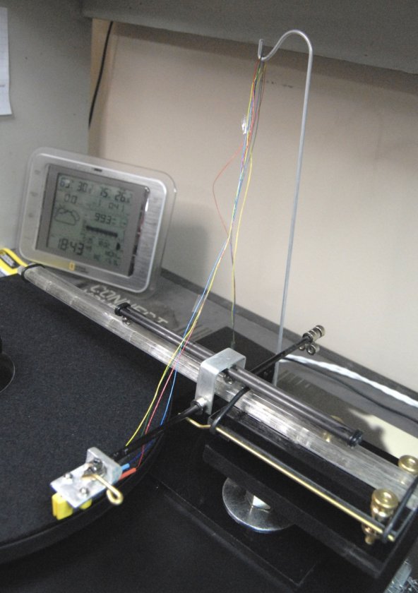

Haaaa.... The mess with the tiny cartridge wires.
I tried to twist them together, but did not work,
even if their are small they are a little stiff.
I try to put them closer together and use little pieces of Scotch tape,
the result was so, so...
My next trial will be to lower the wires support
and then shorten the small wires.
Each new trial is done on my only free day, which is Sunday.
Therefore, probably by the end of this year,
I will have found an ideal way to route the wires so they look good
and don't interfere with the movement of the arm.
Does that make sense ???
Guy 13

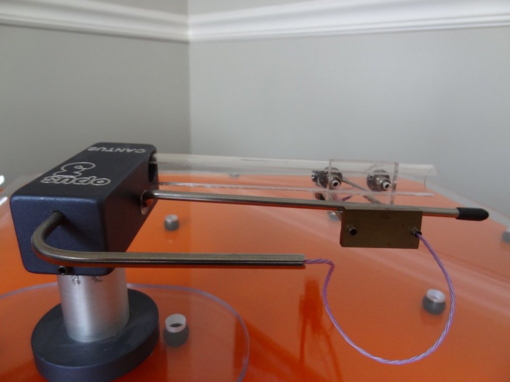

I've had at least 4 variants on this type of arm and have never ground it.....never had a hum.
The 195 page thread from Diy Audio has dozens of builds on this type of arm, or a close clone....metal bearings
rolling on glass tubes.
None have grounded the arm....http://www.diyaudio.com/forums/analogue-source/238027-diy-linear-tonearm.html
The arm that Guy has worked with no hum here with my AT13e cart on my P3, but my wires were shorter and
are set back in a tube like this pic of the Cantus Opus 3
I've also had luck with longer wires hung overhead, this pic is of another I built.....no hum
Not that grounding the arm wouldnt help in Guys set up.....just havnt needed it before.

Unshielded phono wires from the cartridge to anywhere hanging in mid-air are going to hum!
Frank Van Alstine
Hi Frank.
I've connected my original Rega RB301 with it's ground wire connected to my Pro-Ject phono stage
and I've put the arm resting on top of the turntable platter temporarily connected
and even if the Rega arm was shielded I had the same hum,
therefore the bare wires are not the problem.
Guy 13
