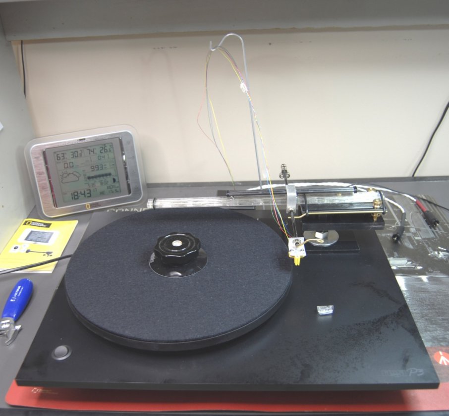

Hi all.
The set up is almost completed.
This is what I did:
With an aluminium coat hanger I did a support contraption for the (hair size)
wires from the junction box to the cartridge.
Hopefully the wires won't pull on the arm.
An over all view.

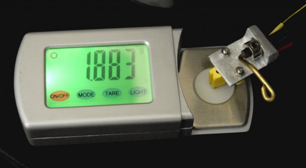

It was not easy to set the weight at 1.8Gr. I had to make sure the tiny wires did not pull or push on the cartridge to change the weight.

I really have to more the arm slowly and delicately,
otherwise, it fall off of the rail.

Hi Guy,
Looks like a good antenna.  Just kidding I know you don't plan on leaving it like that.  I thought I'd show you an example of braided tonearm wire.
http://www.vpiindustries.com/tone-3d.htm
It might take a little experimentation to see how short you can make the wires and where to start braiding.  Good luck with the project, it looks like a good one.
neo

Hi neo.
Of course that set up on the picture is only temporarily,
I will refine the set up as I made a few tweaks here and there
to improve the sound.
I did try that setup as is, but the cartridge's needle was jumping from
one sillon to the other.
But it did sound fairly good.
Now I am getting back to my man's cave, which I call my penthouse
and try to make the set up sound as good as I can.
I will report later on on my success  :thumb: of failure  :cry:
Guy 13

Hi all.
At last, at long, long last...
It's finish, completed and working fine.
That was something laborious for a guy like me with it's hands full of thumbs.
All the adjustment are made as per Perry and others.
THANKS ALL !
(Especially Perry for his wonderful gift. highly appreciated.)
It was time consuming
and needed a lot of patience for a guy like me.
But it's done and now rewarding.
I've played a few vinyl and it sounded good, why not excellent?
Because I had to still use my Bellari hummer and FM receiver unit.
Now I will not play anymore vinyl because of the BB (Bad Bellari)
and I will wait for my Pro-Ject phono pre-amplifier.
By the way, the Pro-Ject can operate on a walwart 120V input 18V DC output
or one 12VDC battery and one 6 VDC battery in series.
Therefore I should avoid at least the hum.
Thanks, thanks, and one more thanks.
Guy 13

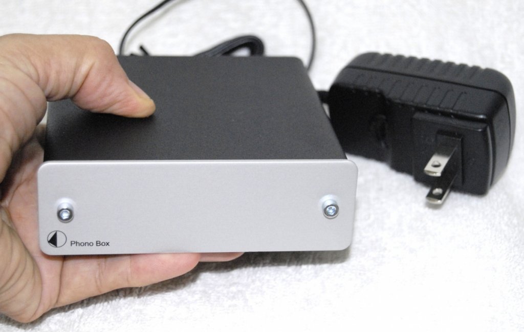

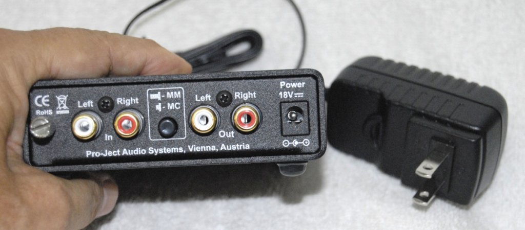

Hi all.
At last, at long long last...
I just go my Pro-Ject Phono Box DC that I've bought from Amazon for 149 USD and that was brought on planet Vietnam by a relative from Seattle.
(No custom tax - no transport fees.)
It's installed and running, however I still have a very faith hum,
but no FM interference, that an improvement over my previous Bellari VP-129
Sounds good, but I suspect that the output of the Pro-Ject is not 2 Volts,
my Decware SE84C+ need a minimum of two volts to give it's full 2wpc.
I will try to swap the walwart (18 VDC) for some batteries. (One 12V + one 6V should do the trick) and see if I still have a residula hum.
Other than that the PDR linear arm works good, I still need to make some fine adjustments, you need to do everything very slowly and carefully otherwise you have to run after the ball bearings that fall off of their glass tubes location.
Thanks to Perry for the PDR linear arm.
I will also have to find a way to protect the whole thing from dust, bceause planet Vietnam have so much dust that they could fill the Grand Canyon with it.
Will update of the final result.
Guy 13
I was surprized to see how small it is.
Could almost fit under the turntable.
