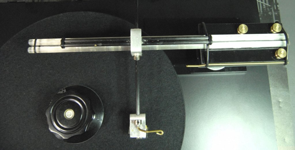

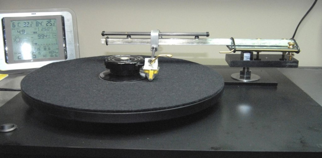

Soon I will be installing a PDR linear arm (Ball bearing + glass tubes) to replace my Rega RB301 on my Rega P3 turntable.
The PDR linear arm is a gift from a generous AC member.

My PDR linear arm is now at the post office and I am waiting to get the release of the custom to pick-it up.

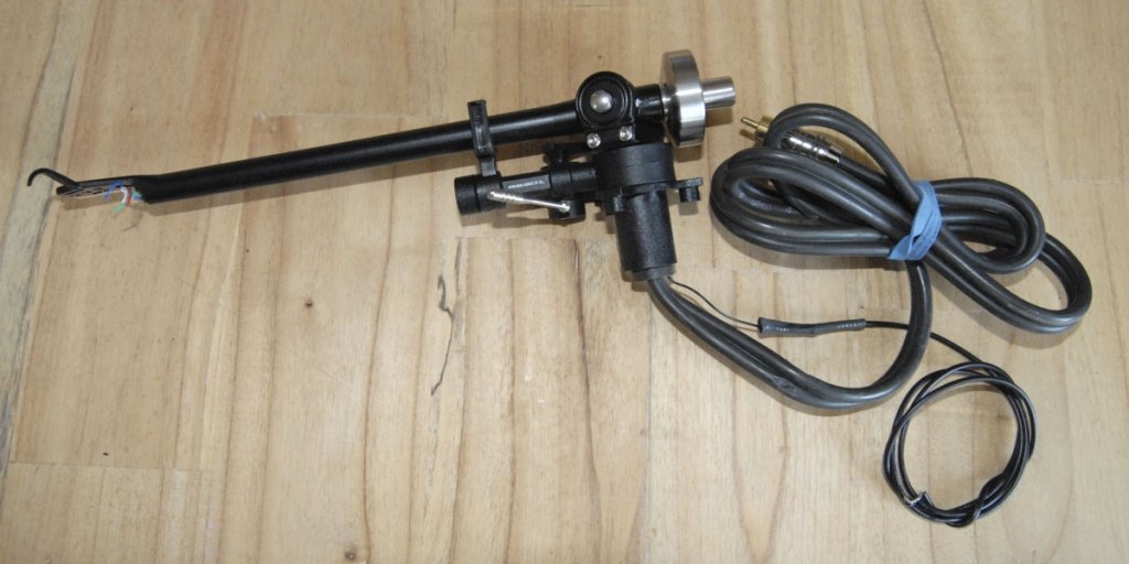

In the mean time, I am so anxious that I have already started to take the Rega RB301 arm of the Rega P3 turntable.
The RB301 is for sales, but only for local pick-up, if I don`t get a good price for it, I might keep it in my museum of Rega horror.

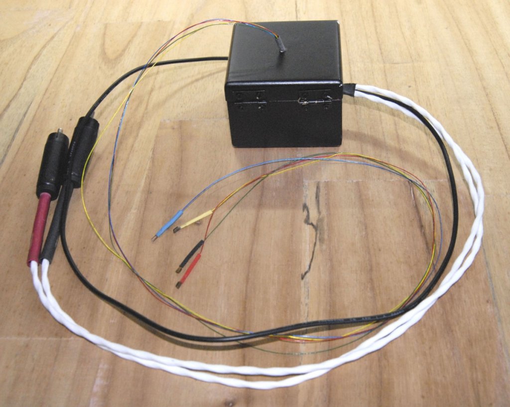

I have also made from scratch a junction box for the interconnects and the tiny weeny little wires that will go the the cartridge, they have to be very small so that they don't interfere with the movement of the linear arm and cartridge.

Hi Guy,
You might want to hold on to that 301, at least for now.  It looks like you have a couple of feet of unshielded wire going to your junction box from the arm?
Assuming you still live in the same place, you might have a problem with those wires and RFI.  If you braid those wires it should help.

Hi neo.
Of course the tiny wires going from the cartridge to the junction box are not shielded,
how can such small wires like that be shielded?
As far as I know, no linear arm wires are shielded.
(I hope the way I wrote the above is not too rude,
because from previous experience, I know a lot of sensitive AC members would take that as a rude behavior from my part.)
I did try that set-up with my wife’s home theater Pioneer amplifier with a phono input and no hum at all.
So far, so good.
Of course I will keep the Rega RB301 arm, at least until I know the new set up works 100% hum and interference free.
However, after that, I will say: Farewell RB301 trouble maker.
Please don’t assume that I still live in the same place, because I do live in the same house, remember, I am stuck here.
To braid the wires, I presume that’s the same as twisting them together, so that’s what I will do, but I have to be careful not to make the bundle too stiff.
Thanks for the good luck, because with that project, there is still a lot of unknown factors.

Often the tone arm has at least a thin layer of metal to act as a shield.  And each channels tw wires should be a twisted pair.

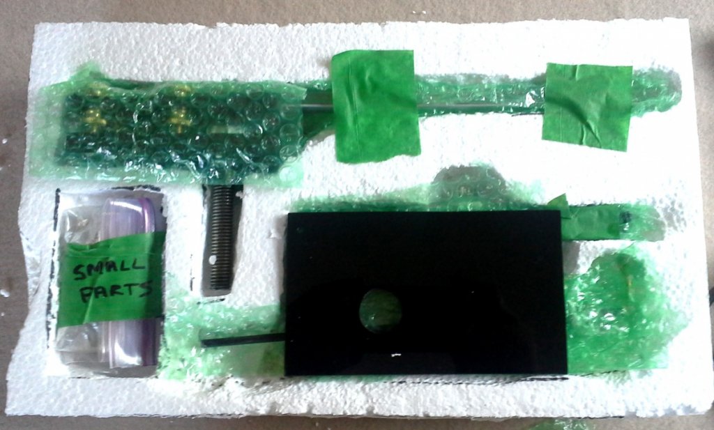

Guy 13
Re: A phono preamplifier is not a FM receiver !
« Reply #134 on: 9 Sep 2014, 04:17 am »
Hey Guy did you mount that glass linear on your Rega?
Picts? Followup?
I think that is a real cool tonearm setup. Those wires cannot really be twisted so leave them hang separated that is all you can do.
Let us know.
Hi bacobits1
After a long space shuttle trip from the US of A to planet Vietnam,
the PDR arm landed safely on this planet,
planet Vietnam that is.
Then the PDR arm was taken hostage by the Vietnamese post office
because they did'nt have the slightest idea what that device was,
they probably thought it was some world war I destructing device.
My wife filled in tons of paper work and whent thru lots of red tape,
but at last, at long, lonmg last, the hostage was release
and landed in my listening room.
And because the Vietnamese custom people did not know what it was,
even after my wife sent them a picture of it and it did not look even close
to a flying saucer, they came up with a hefty bill of:
26,800 Dollars, Vietnamese dollars of course, which are called Dongs here
and in real money that's the huge amount of 1.25 USD.
(One dollar and twenty five cent)
I really don't know how I will be able to pay that,
I guess I will have to sell my turntable.
O.K. enough of my absurd jokes.

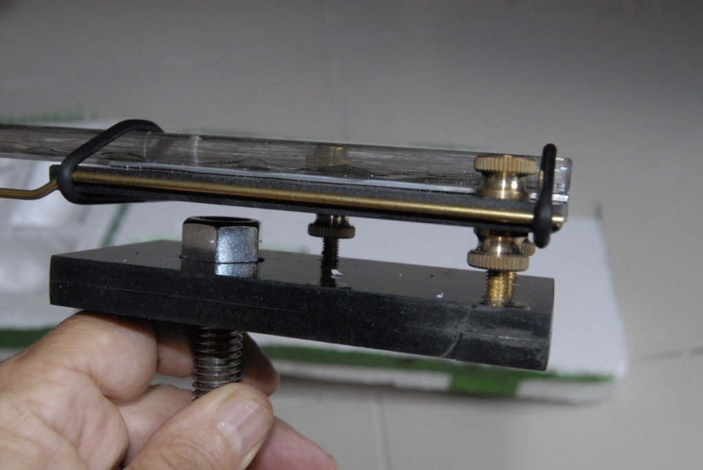

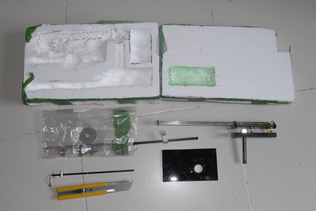

The PDR arm arived in a zillion tiny pieces...
Joking again.
It was really well packed, nothing was broken and no parts were missing.
Thanks Mr. PDR (Perry) the mysterious man that gave me such a nice gift.
For a few days, I will try to recover from my yesterday business trip
to Hong Kong (23 hours without sleep) and then I will start assembling the puzzle, the audio lego, the kit.
Look forward to have fun and frustrations.

Hi there Canadian fellow.
Yes, I took forever for your gift to reach destination,
I don't know how long is a goat gestation,
but look to me like it was forever...
Anyway, it did reach destination unharmed.
Thanks for your super packing job.

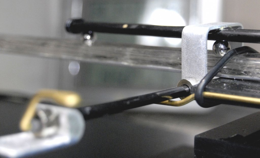

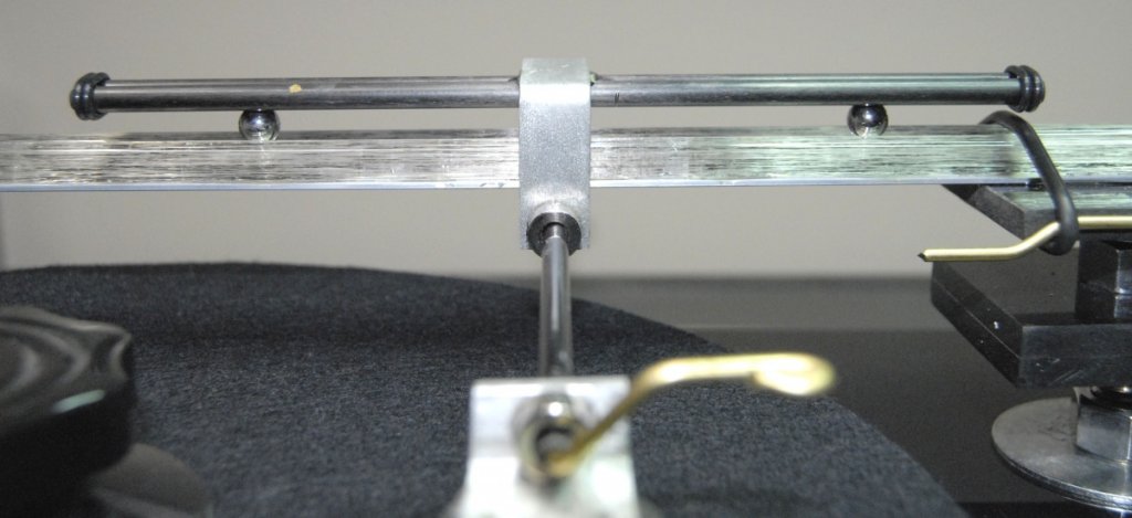

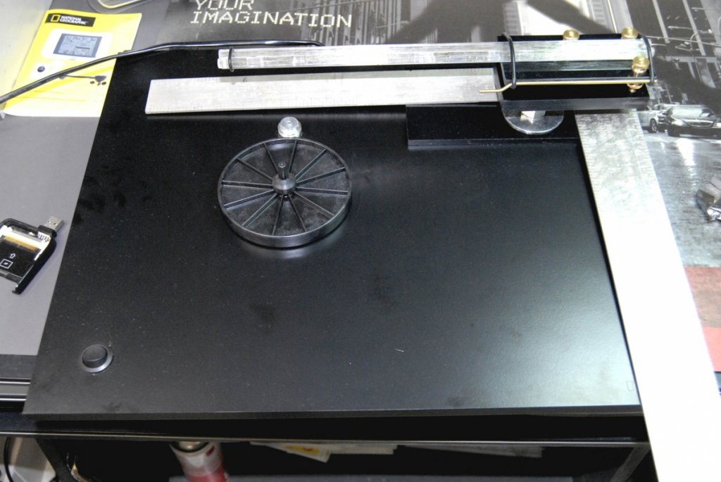

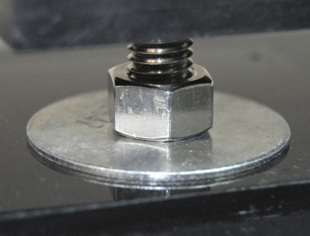

Hi all.
O.K. now it's phase one of the PDR linear arm puzzle.
I've put into the large hole, the large bolt that hold the glass tubes assembly
and that was easy.
I tighten by hand so I could aligned everything.
I've been told/warned that I would chase the ball bearings
and I did when they fell off from their glass tube gutter.
While adjusting the zillions allen screws the ball beraing
fell off a few more times.
I finally after a few draken double drak adjusted the arm itself and I temporally taped the cartridge so it would not bang on anything.
So here are a few pictures so that anyone that want to comment
can do it more easily with pictures.
One question.
Where should be located the ball bearing in relation to the arm's shaft?
The three little brass knobs are for adjusting the angle of the tube
for the tracking force.
Phase two is the adjustments and fine tuning.
Soon to come, don't go away.
Guy 13
PDR
  • Posts: 820
  • May the best man win
« Reply #137 on: 10 Sep 2014, 11:50 pm »
Guy,
With the arm all the way over to the right, on the arm rest....
One bearing should be over the arm, the other should be all the way to the left against the rubber o ring.
You'll need to draw a line on a piece of paper, punch a hole on the line at one end and use it like a protractor on the platter.
You need to make the line on the paper and the glass arm parallel.... then the needle has to follow the line
Hope this helps...

Guy,
Hope this helps...

« Reply #139 on: 15 Sep 2014, 01:29 pm »
Hi all.
My wife's business keep me off the road chasing nice Vietnamese chicks
and since I'm in my office, I took a 5 minutes break and started to adjust my PDR linear arm.
I've use this angle ruller to make sure evrything is at 90 degree.
Then, I tighten the big bolt (I hope the larger washer goes on top ?)
Then I made the adjustment to make the glass tubes parallel to the plinth.
Then, I made sure the arm with the cartridge holder is parallel to the protractor.
and made sure that the ball bearing are at the right place.
Is everything O.K. ?
Please tell me know while I am in a good mood.
Tomorrow, I might be in a not so good mood or even worst.
Guy 13
Next step, mount the cartridge and connect the wires, that part might be more delicate and will need some agile and precise fingers, something I don't have...
