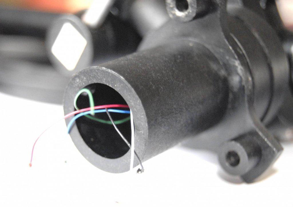

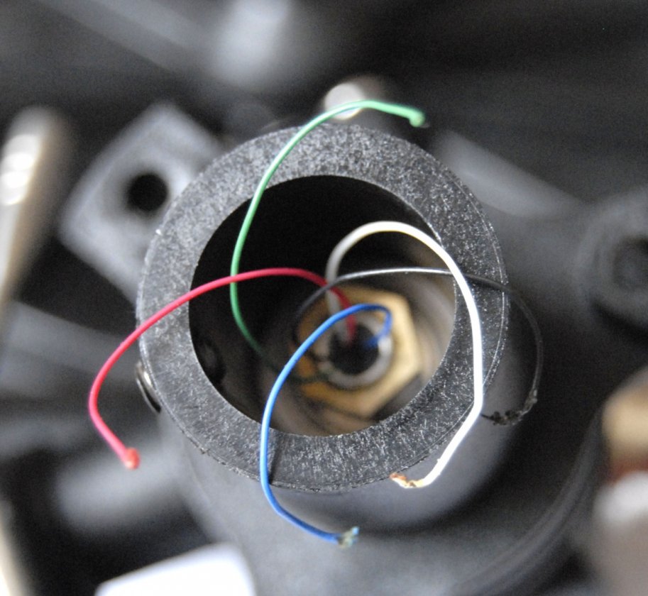

I've decided to take apart the interconnect that goes into the pivot of the Rega RB301 arm.
It wasn't easy, everything was very tight.
And clumbsy me, I manage to break off all four wires when I pull out the intercennect assembly.
(See the pictures)
Tomorrow, I will bring the arm and interconnect to a repair man
with a small solding iron and with tiny agile little fingers.
Hopefully, he will do a good job and won't make it worst that it is now.
To be continued...
Guy 13

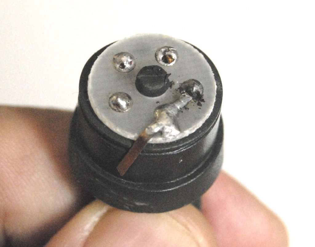

On the bottom picture look you can see that there is a small flat copper part that makes contact with the arm then the pasrt is inserted in the arm's shaft.
There, I do have a grounded arm. If the thing is making a good contact, of course.

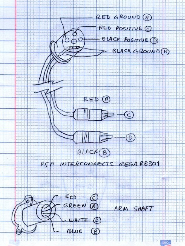

Of the 5 wires the black is the ground.  The connector at the bottom has 5 connections.  The bottom one for the black ground wire is strapped to one of the channel grounds to the right of it.  That would be either the green or blue wire.  That strap should be defeated.  You should make it so those two aren't connected.   A separate ground wire should be run along with your tonearm wire, from that bottom connector to your preamp ground lug.
That brown piece on the bottom is part of the ground.  It should contact the mating arm part when you reassemble.  The wire code is:
red - right (+)
green - right (-)
white - left (+)
blue - left (-)
Good luck,
neo

With my ohm meter, I did some intensive and careful wires identification, because I wanted to know what is what
and what goes where.
You will find all my results/findings on the hand sketch below.
Now I know more where I am going.
Interesting is the fact the only one side of the interconnect is grounded to the arm via the little brown metal tab that is supposed to make contact with the arm shaft or tube to ground the arm, but that round thick tube is made of plastic, yes, plastic, and plastic is not conductive, I’ve check carefully with my ohm meter.
Therefore I can conclude without being erroneous, that the arm is not grounded and that’s why I have interference.
Rega, how can you do so much STUPID ?
Now, separating that double connected terminal B might be good, but I don’t think it will make anything better.
There is no way I can add a ground wire other than externally.
Which I tried already, but I will try again after I have separated the ground soldering posts.
Ho my God, no wonder I was born on a Friday 13th.

Anyway, on Monday the technician will re-solder all the wires according to my hand sketch and then, I will see what I can do about the ground.
I already have an idea, but the technician will tell me if he can do it.
