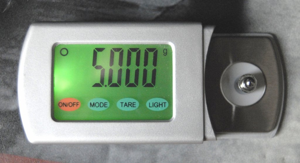

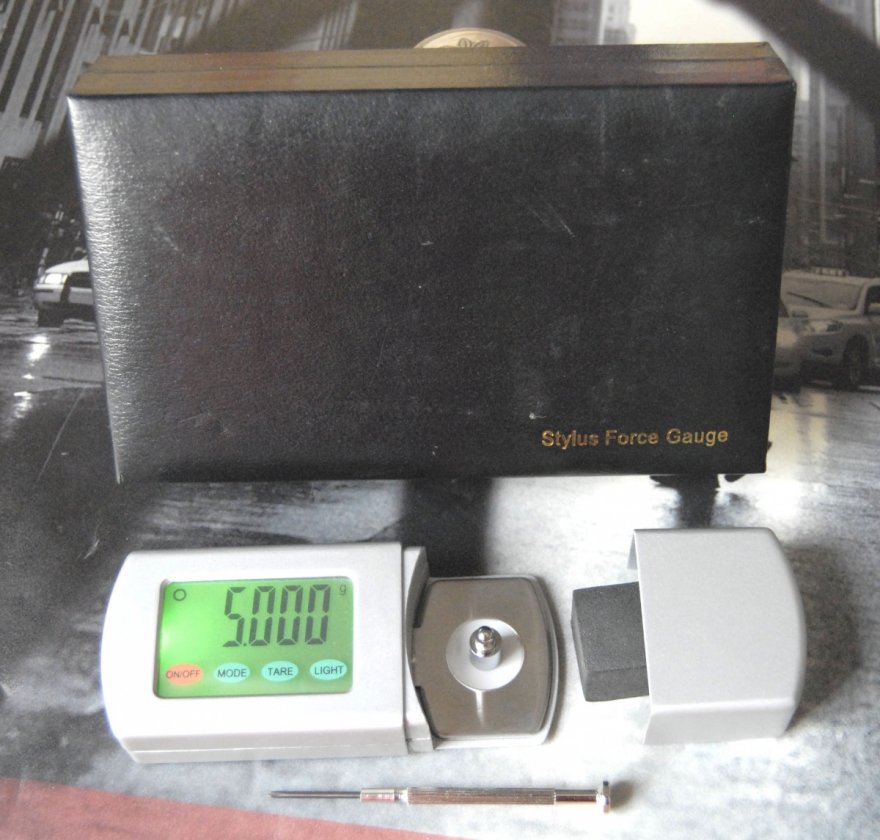

I did the calibration of the weight with my No Name
Stylus Force Gauge (Made in Taiwan) for 70 USD.
Set at 1.75g as per Rega recommendation.

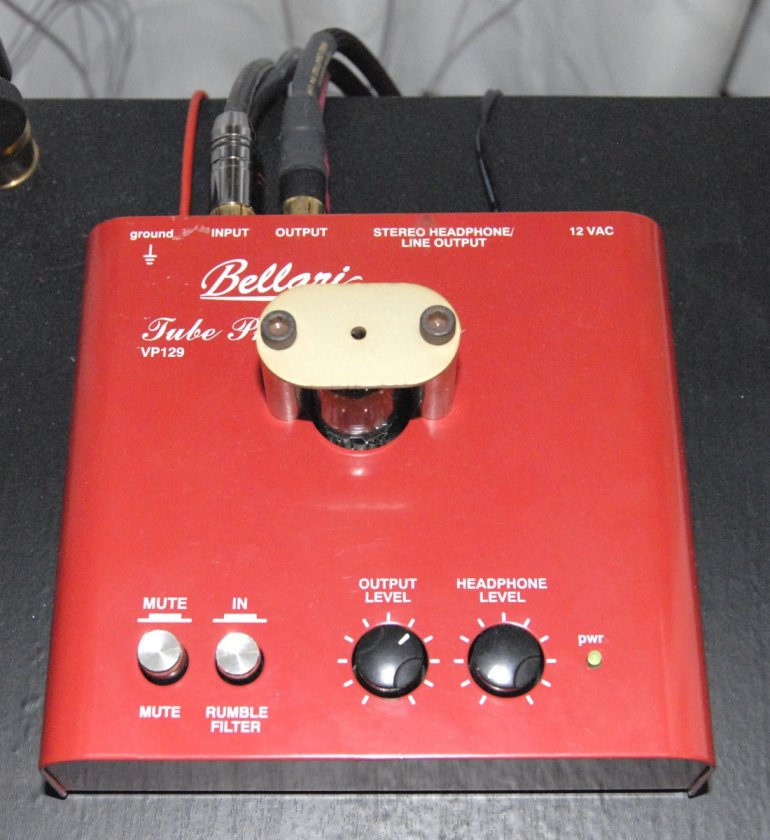

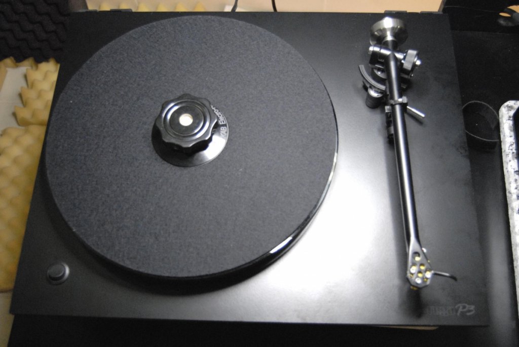

I have a Rega P3 turntable which works on 230V.
A Rega Exact MM cartridge.
A Bellari VP-129 powered by a walwart 120V. in and 12VAC out.
A Decware SE84C+ SET amplifier on 120V.
All the above (Except the Rega P3) are connected on my 120V.
Majik Buss line filter/conditioner.
The Majik Buss is connected to an auto transformer on 230V, with stabilized 120V. output.
Everything is on a common ground going to the 230V. dedicated wall outlet.
The Rega P3 turntable does not have any ground except for the cartridge interconnects.
My problem is the following: I can hear from both of my speakers a radio station, probably FM and its loud enough that I can’t really hear the music from my vinyl.
I would say that 40% radio and 60% music and it proportional the the volume control position.
No hum, only the FM station on both speakers.
I’ve double check all my ground wires.
Any suggestions?

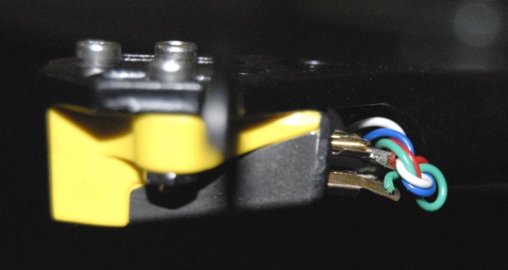

Guy 13,
your wires look like they are in knots.  Could that be the problem?

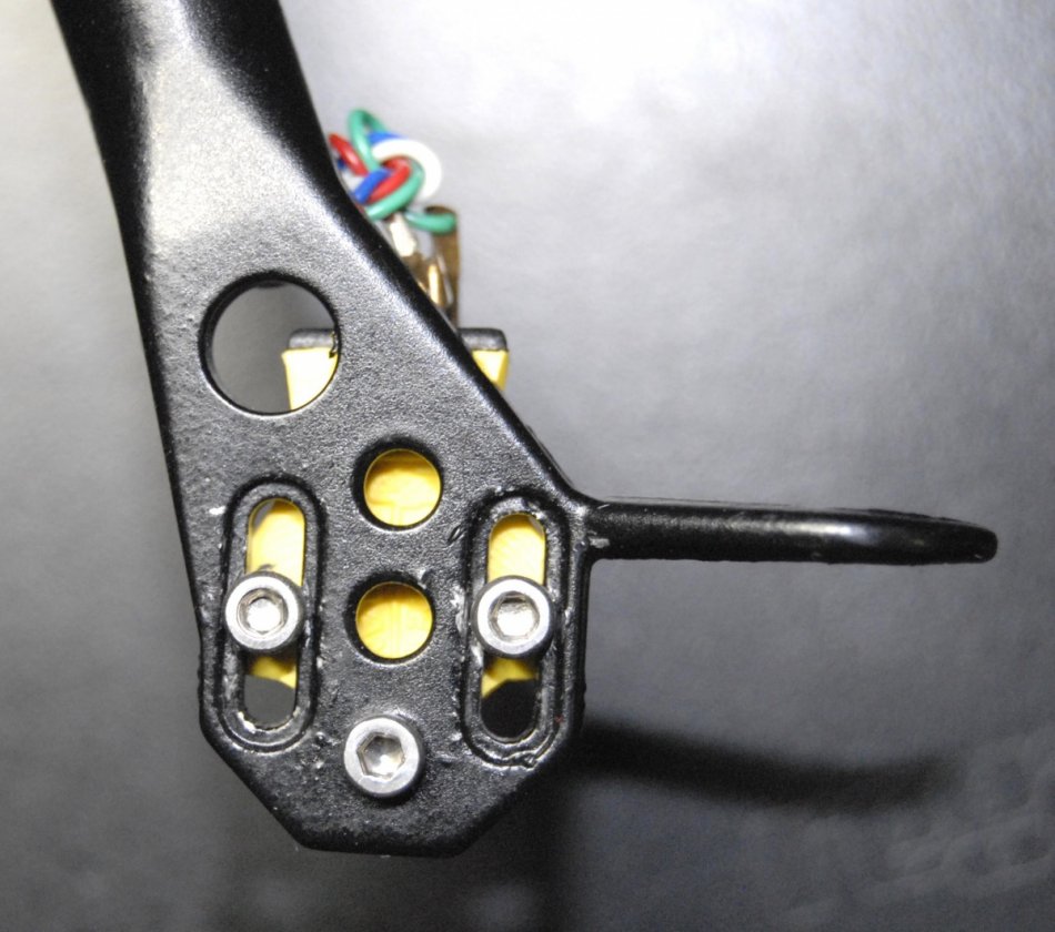

« Reply #3 on: 15 Apr 2014, 11:45 am »
Nightfall is talking about the wires to your cartridge. You can see from your photo that they are all inter-woven and in a mess. While untangeling that mess may not eliminate your radio station, it may improve your channel separation.
I'd like to inquire what kind of RCA interconnects you are using from your phono preamp to your line preamp. I suspect that there is some poor shielding going on. Unshielded interconnects are a radio antenna, and would explain your reception of a local station.

Hi Guy
I don't know that phono stage but I think it has a mute. Try that and see if the FM disappears. If so, then you've narrowed down the source. From there check the gain settings on the phono stage to see if that impacts 'reception'. If nothing else works, try moving the arm around like an antenna and you might at least pick up a channel you can enjoy (just kidding!).
Keep us posted
Patrick

Hi Guy
Keep us posted
Patrick
Hi Patrick.
Yes, if I push the mute button, it goes quiet, dead, nothing, zilt.
If I turn down the gain knob, the FM radio goes down,
but also the music from the turntable.
Even if I move the arm around to get another FM station,
I am always stuck with the same boring FM station.
I suspect that there is something going on in/within the arm,
because the arm is not grounded in any way.
I even tried a ground jumper wire with an alligator clip,
but nothing, zilt, rien, khong, nenine...
Draken double drak, come up with something, otherwise I will do something I might regret.
(The axe is not far or withing an arm length...)
Guy 13
Nick77
Re: A phono preamplifier is not a FM receiver !
« Reply #7 on: 15 Apr 2014, 02:10 pm »
Boy, correct me if im wrong but i always thought that ground lug was for the turntable not for the wall outlet.

Davey
  • Posts: 1481
« Reply #9 on: 15 Apr 2014, 02:23 pm »
You're not wrong.  :)
Guy, I think you should change your grounding scheme and remove the red (earth) wire you have connected to your phono preamp and connect the ground wire from your RB301 arm interconnect cable to that lug.  If your RB301 cable doesn't have a ground lead then you should get a cable that does.
Your phono preamp should not have a direct earth ground connection to the wall outlet.
Dave.
« Reply #11 on: 15 Apr 2014, 02:31 pm »
 :o
TMI
rollo
  • Posts: 5530
  • Rollo Audio Consulting -
« Reply #12 on: 15 Apr 2014, 02:48 pm »
Dave.
It appears the tonearm is not grounded.  You could also try some aluminum foil rapped around the phono ICs. An old recording studio trick when FM signals were heard.

« Reply #14 on: 15 Apr 2014, 03:21 pm »
Agree with a couple of posters. Ground wire should not go to house-hold system ground, and tonearm/turntable ground should go to the Bellari ground. Problem should go away.
The shield of the RCA interconnect will carry the Ballarie ground to your line preamp.
« Reply #15 on: 15 Apr 2014, 04:00 pm »
Hi Guy,
Unshielded wires at the headshell can pick up noise or RF.  Braiding those wires tends to reject noise, but you don't want to stress the connections.  Probably nothing to worry about, but I can't tell how tight it is.
So, you hooked up an antenna ground wire from your phono stage ground to the AC outlet and now you're listening to the radio and a record at the same time?  I suspect the reason it wasn't a problem in the last house is due to chance.  You know what they say, "Location, Location, Location".
Chances are, if you get rid of that wire you'll be fine.  There is no easy way to connect a ground wire to your Rega arm AFAIK.  The ground is in one of the channel grounds and it, in turn should be connect to the ground inside your phono preamp.
neo

Dave.
Hi Dave.
I am back and I have removed the red/ground wire.
An Interconnect cable with a ground,
then the ground wire of the interconnect should be connected at both ends.
Correct ?
On the phono no problem, I can use the lug,
however, on the arm, where can I put it ? ? ? :scratch:
In addition, that means I have to go inside the arm or in the pivot and do some delicate soldering, which I am not to brave to do.
Guy 13
