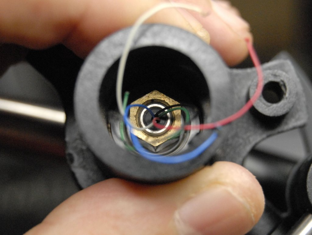

The interconnects come out directly from the Rega arm shaft and they are Rega stock and they are shielded.
Then, they go to the Bellari VP-129 phono stage.
Guy,
Looks like you have a bigger problem.  Unless those wires change color in the arm tube, you shouldn't be getting those results.  The black wire should not be making contact with the left positive (black positive?).  That should be the white wire only.  The color scheme is as I posted above.  Maybe you wrote it down wrong?
The right channel is red and green.  The left is white and blue.  Did you untangle those wires at the cartridge?
If that ground strap only contacts plastic, you'll have to create a ground inside the arm.  Maybe that's why Rega has it connected to the channel ground in the first place.  I'll see if I can find out how aftermarket kits are configured.
neo

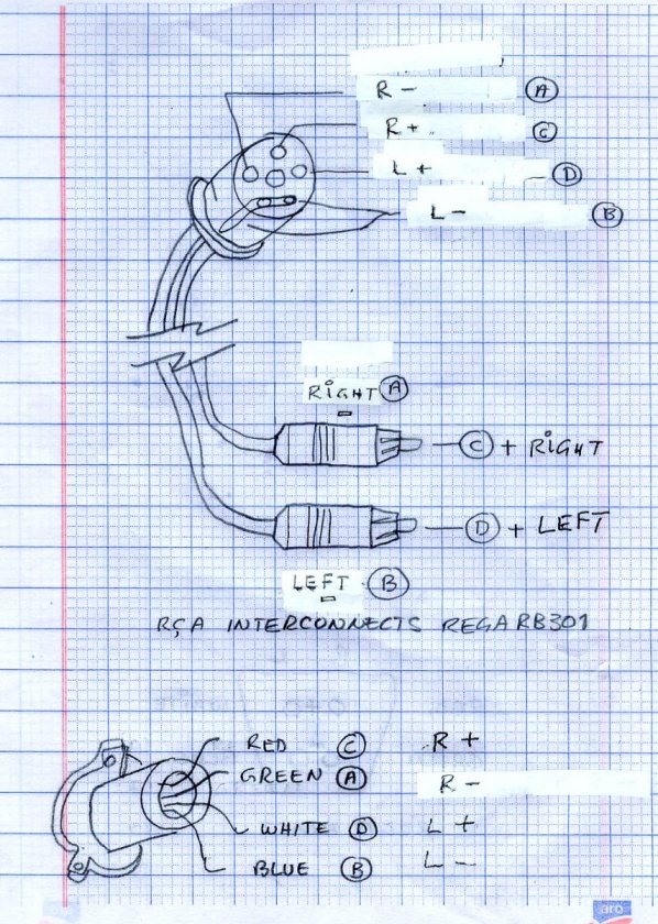

« Reply #61 on: 20 Apr 2014, 02:06 pm »
Hi neobop.
Here is a revised and more complete wiring sketch of everything,
including the cartridge.
I am pretty sure that every wire is at the right place.
Have a look at my pictures and please comment.
Adding a ground wire going i the tube, that's a titanesk job, well for me.
Re-wiring the tube is also a big job, but might be easier ? ? ?
Guy 13

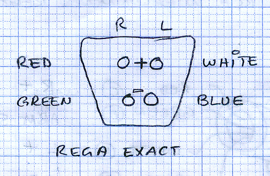

Forgot this hand sketch of the Rega Exact.
I don't know why, but the image won't download.
Therefore, here is the correct wiring of the cartridge.
Red = Right +
Green = Right -
White = Left +
Blue = Left -
Guy 13

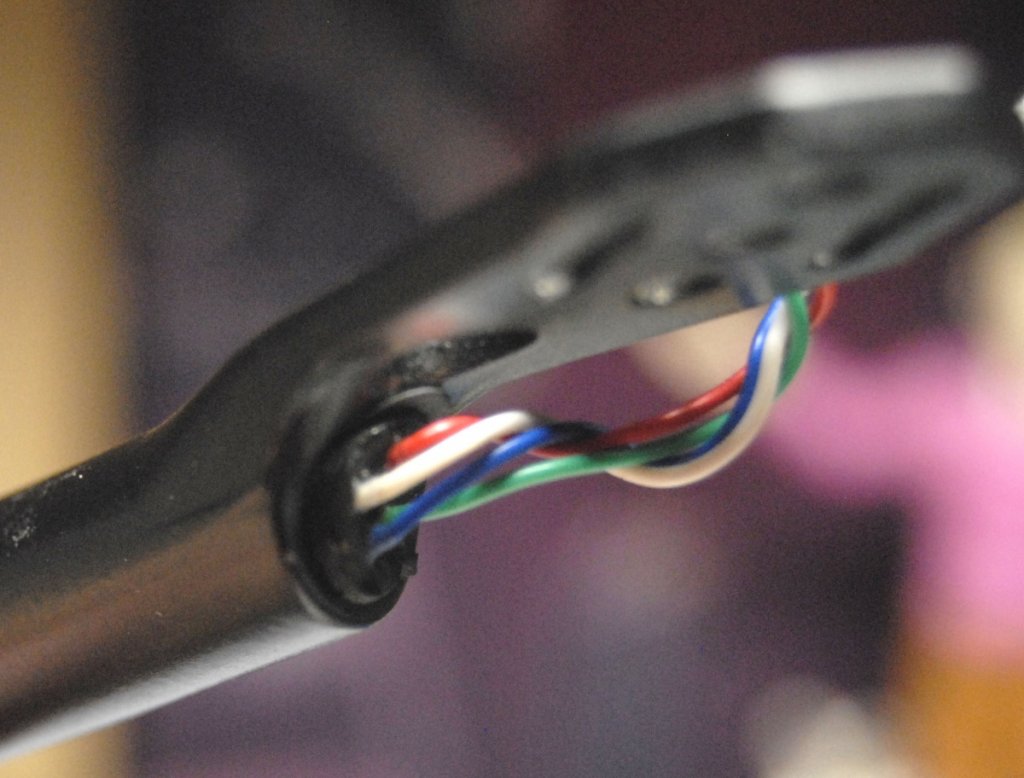

I'm sorry for jumping in late, but the pictures that were shown of the broken tonearm wires also show some suspect soldering. In my opinion all of the solder connections look 'cold'. At least two of those 'joints' would be marginal at best. I think if your guy is any good with the soldering iron, your problem might just go away with the re-soldering.
neobop
  • Posts: 3446
  • BIRD LIVES
Re: A phono preamplifier is not a FM receiver !
« Reply #64 on: 20 Apr 2014, 02:38 pm »
Hi Don,
I think Guy just heated the joints removing the wires.  A couple look a little overheated, but that's not the problem.  The arm worked fine in the previous location.  Those joints will be redone anyway.
neo

I was thinking about something; it’s been turning in circles in my head for some time.
When I bought the turntable from the local Rega authorized dealer here in Ho Chi Minh City they told me that they had to import it and that someone will bring it as personal belonging.
When I got the table, I did what I do all the time, I went under the hood to see what’s under the hood and I was surprised to see that the motor had some kind of rust or oxidation on it’s housing, that was supposed to be a brand new table from the manufacturer.
I always had some doubt about that, I would not be surprised if this turntable was a Chinese copy ?
Anyway, I am stuck with it, I can’t spend many $ $ $ to buy another one and I cannot either spend mucho $ $ $ to replace something expensive or to afford expensive repairs.
I am still thinking on how I will add the ground wire and where I will connect it.
« Reply #66 on: 20 Apr 2014, 03:14 pm »
Guy,
It's probably just a little older than advertised.  Do you think it would be worthwhile for them to copy the entire table?  It's a shame you sold the Linn, but all you can do now is move on.
Okay, that looks better.  Now, the question is, where does that black ground wire go to inside the arm, and is it still connected in there?  It should be connected to a ground inside the arm, if it wasn't pulled out.  If that black wire is disconnected inside, then you would have to make a ground connection on the aluminum part of the arm tube or pillar.  Lets assume (at least for now) that it's still connected inside.
Now, what you have to do is disconnect that bridge between the bottom ground connector for the black wire, and connector for the left channel ground (blue).  Don't worry about that brown strap.  It shouldn't matter.
Here are instructions for a complete DIY rewire job, including making a new ground connection inside the arm.  Hopefully, you won't need it:

This morning (Monday) I was to bring my Rega arm to the technician,
but I thought of something.
The black wire (Ground) will be soldered to the rubber plug with all the other cartridge wires,
but where will it exit from that plug ?
I think I will make a slot/groove along the plug and make another ground wire coming out
and then going to the ground lug of the Bellari phono stage.
I still have to check for the continuity of the black pig tail to the housing of the arm.
All that work and frustration because Mr. Rega did not do his homework.
Bad, bad, bad design.
Shame on you Rega.
Never again Rega.
You are on my black list Mr. rega.
Guy 13
I will be back with my findings, if I don't get run over by a 40 tons truck.
Guy 13
« Reply #70 on: 21 Apr 2014, 09:04 am »
Hi neobop
and I am sure other as well followers of my misadventures.
I have checked with my ohm/meter to see if the tiny black ground wire
was really making ground/connection with the arm and... and...
Yes, thank God it is.
There is at least one good news in this storm of bad news/surprises.
Now, the tiny black ground wire that as to go out of the arm assembly, I will get some kind of slot, gutter so that it can come out, because everything is super tight.
Tomorrow I will explain up to three times to the Vietnamese technician
that will do the modifications and repair to make sure he does not screw up the whole thing.
I am very anxious to put this bad luck adventure behind me and start enjoying the 80+ vinyl that I have just cleaned with my Spin Clean machine.
Guy 13
Guy,
The black wire was connected to the round junction at the bottom of the arm along with all the other wires.  On the other side of that junction your tonearm interconnect wires are soldered.  That junction is also strain relief.  It prevents the wires getting pulled out and disconnected inside.  I suggest using that connection and running a separate wire for ground, along with your interconnect.  The only thing you have to do in order to use it, is disconnect that bridge between the ground connection and the one next to it (left channel ground).
You can run the black wire out some slot, but you'll have to secure it to the bottom of the arm so it doesn't get disconnected.  If that bridge on the connector can be severed, it will make a neater more secure job.
neo
