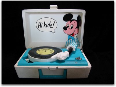

Maybe I should get a Mickey Mouse player?
Does it play 33RPM vinyl?
