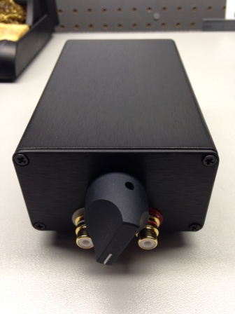

In the meantime, I installed a Panasonic EVJ 50kohm volume pot into my TPA3110D2 amp. As I mentioned before, I carefully soldered the wires using a third hand tool. in the photo, you can see that I wrapped the jaws of one of the alligator clips to keep the alligator teeth from biting into the wire insulation. After soldering each wire in place, I slid a short segment of 14AWG Teflon tubing over each soldered joint to avoid possible shorts. It also serves as a strain relief.
Here is the volume pot installed next to the RCA inputs to keep the signal path as short as possible to minimize any RFI effects. Using my DMM and my ears, this volume pot is very well balanced, even at very low volumes. Interestingly, I have absolutely no noise coming through my speakers with my Sony ES SACD/DVD/CD player connected directly to the inputs of the amp integrated amp mode. The starting volume position is about 7 o'clock, and pushing it to 10 o'clock is plenty loud for my man cave. This little amp never ceases to amaze me.
Next, I am going to build a second unit. Both the new amp and this prototype will be encased in a couple Context Engineering extruded Aluminum enclosures.

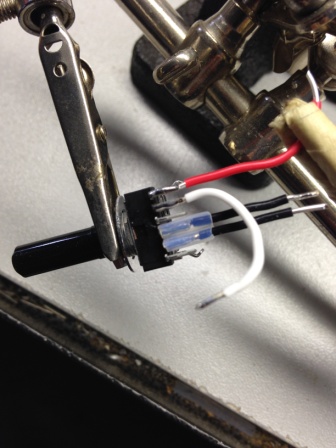

Rhing,
 Thanks for the wiring drawing and the third hand pic. I do have a third hand, actually mine is so old it was made in USA :thumb: I assume you use one clip to hold the shaft and another to hold the wire close to the pin? I will definitely give it a try.
rhing
Re: TPA3110 and TPS3116 amps
« Reply #149 on: 4 Jan 2014, 03:59 pm »
Rhing,
In the photo, the third hand alligator jaws without the masking tape wrap is holding the nut that is on the shaft of the volume pot. The other alligator jaws wrapped in beige-colored masking tape are holding the red insulated wire.
  • I strip off a length of insulation off each wire that is the same length as each lead on the volume pot.
  • It really helps if every wire you solder on the volume pot is straight, especially the stripped end that gets soldered to the lead.
  • Then I position and line-up the wire to the lead to maximize the contact area.
  • I touch the lead with my soldering iron tip and allow enough solder to flow and encapsulate the wire and lead.
  • After it cools, I clean any rosin flux off with an alcohol-soaked cotton swab and slide the small segment of Teflon tubing over it.
It looks daunting, but you just solder all your wires to the pot leads first before installing it. The tinned leads on the Panasonic pots are soft and bendable, so be careful not to bend the leads back and forth repeatedly, or they'll snap off. This is probably something you wouldn't want to do after a few coffees or Mountain Dews. :icon_lol:

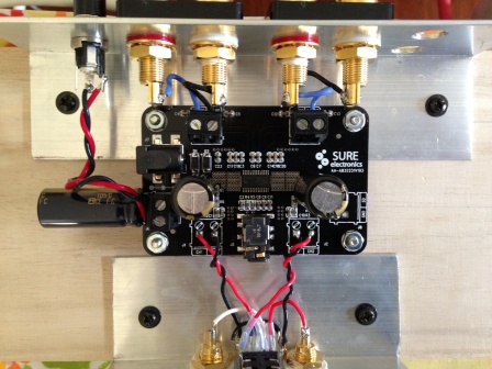

I also added a Panasonic FC 1,800uF / 25V across J8 as Taterworks did, and just as he described, the soundstage became significantly more three-dimensional, and the bass gained some muscle. This was a nice change once I ran this amp standalone. Without the ARC LS7 line stage preamp in front of this amp, the sound thinned out and the bass weight disappeared. With the off board cap in place, the bass, the warm tonality and rich detail came back to life.
I have two more Sure TPA3110D2 boards coming soon. One of them will end up in this Context Engineering chassis, which I drilled out and assembled last weekend. For scale, this enclosure has a slightly larger footprint than my iPhone 5. It has the Pomona 3770-x Gold-plated Copper binding posts, Vampire CM1F RCA connectors, Switchcraft 722A 2.1mm x 5.5mm DC power connector and Panasonic EVJ 50k log volume pot. To mount the additional cap, I'll remove the 2-pole terminal block from J8 and solder in a Panasonic FC cap along with the power supply wires.

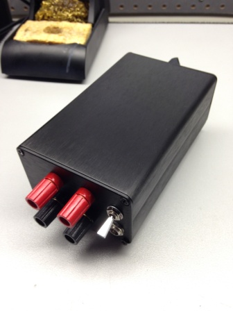

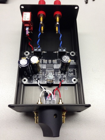

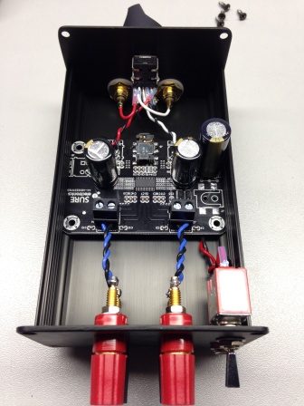

I received my second Sure Electronics TPA3110D2 amp today and installed it in the chassis.
Since this chassis has slots for mounting a 3 inch wide PCB, I didn't have to use stand-offs for mounting the board in place. However, I did have to remove the built-in DC power connector to be able to slide the amp into the chassis. Sounds great!

« Reply #158 on: 11 Jan 2014, 01:44 pm »
rhing
What is that third larger cap?
Scott
rhing
« Reply #159 on: 11 Jan 2014, 02:03 pm »
It is a Panasonic FC 1800uF / 25V electrolytic cap soldered into the J8 thru-holes where the power supply is connected to Vcc. The twisted wires from the power connector are routed beneath the board and soldered to the cap and thru-holes for Vcc (+) and Ground (0V). Taterworks had tried this and so I gave it a try too and obtained the same improvements in bass response, a larger soundstage and improved tonality. This was really apparent when using this amp as a standalone integrated amp in my system. I would have preferred a 2200uF / 25V Panasonic FC/FM cap, but the height would not fit in the compact chassis.
