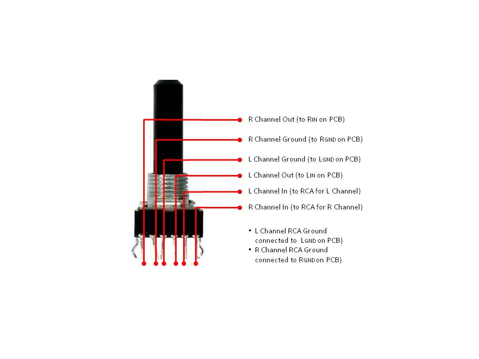

I've been using my Sure TPA3110D2 amp with my Audio Research LS7 line stage and PH5 phono stage with no problems. Even though I have an SMD soldering station, swapping in new resistors is a real pain.
I assume it's best to get these little amp boards without volume and or tone controls. My question is what is everybody recommending for controlling volume? My current set-up is PC based, and I am using the PC's volume control which I know isn't the best method.
Soo.... What is the best "Cheap-N-Cheerful" pre-amp addition to my current PC based TPA3110 set-up to control volume?
This whole pre-amp thing has me thoroughly confused. Active; passive; stepped attenuator; buffer; optocoupler; tube; solid state, etc, etc. What things do I need to consider before introducing a pre-amp ahead these little amp boards?
Section 2.6 of the Sure Electronics manual recommends that if a volume control (potentiometer or stepped attenuator) is used, it should be 50kohm. For a "Cheap and Cheerful" (i.e., low cost, good performing) volume pot, I recommend Panasonic EVJ-Y10F03A54, 50kohm log taper with metal bushing. These are transparent, good-balanced volume pots, and they only cost $1.70 at Digikey. The issue that most people have with using them is the 2mm spacing between pins and the irregular pin-out. Soldering wires to these pins can be challenging, but it is possible with patience. I recommend tinning the pins first and removing any excess solder with a solder sucking tool. You will need a "third hand" tool to properly position the wire on each pin to make good physical contact before soldering.
Lol, and now for the wushuliu butterfinger/lazy ebay rec for pots:
http://www.ebay.com/itm/SMT-Resistor-Step-Attenuator-50K-Volume-Control-/220975033985?pt=Vintage_Electronics_R2&hash=item3373236e81
You are a far better solder slinger than I. I got those Panasonics a few years and they were a PITA to work with due to tight pin spacing. But they do sound terrific. High quality, especially for the cost. I've gotten better since then. I should give them another go. Can't beat the price/performance ratio.
I usually use Teflon tubing to insulate the joint and serve as a strain relief on the soldered joints, but heat shrink is also good for this too.
Thanks for the suggestion...
I guess that is truly Cheap and Cheerful :thumb: I was looking for a pre-amp solution, but I should give this a try as well. If this pot sounds pretty good, I do need more soldering experience. I wasn't thinking about getting it with 2mm spacing :roll: However, it's cheap enough to get a couple, and try it! What size wire is needed? Could I strip out the wires from Cat 5 cable? Are the 2 outside pins not used?
