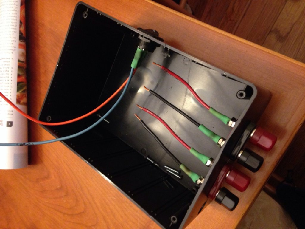

Okay, now if my 3116 would just show up! I think I should add an LED so I know when the power is on too. I've lost two SLA's by accidentally leaving them on.
lacro
  • Posts: 602
Re: TPA3110 and TPS3116 amps
« Reply #44 on: 24 Dec 2013, 12:02 am »
It looks like you are using the same type of rocker switch I am, but the one I have has an LED "on" light. Mine is blue, but other colors are available. Got it at PE.
Mr. Oczka
  • Posts: 81
  • Audiophile in training
« Reply #45 on: 24 Dec 2013, 04:16 am »
Those cases look like they were made for the amp!  Where did you guys get them?  I'd like to pick one or two up for myself.  Were the holes for the connectors already cut?  I'm going to guess "no".
raysracing
« Reply #46 on: 24 Dec 2013, 05:44 am »
This is a radio shack special "Project Box." $7.99 I think. I bought a step drill as the rocker switch required a 3/4" hole. I couldn't wait to start so I got what I could locally.
Ray
Mr. Oczka
  • Posts: 81
« Reply #47 on: 24 Dec 2013, 11:53 am »
Thank you for the info!  I think I will be visiting Radio Shack this morning for a last minute present for myself. :P

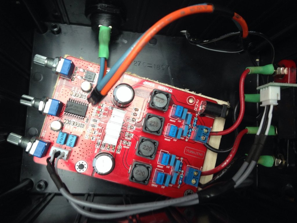

I was able to reduce and almost eliminate the noise problem with my Sure TPA3110 amp. I inserted 33kohm resistors between the signal inputs and signal grounds. My preference would have been to try 47kohm resistors or place a 50k log pot between the RCA inputs and board inputs. Nonetheless, this amp sounds awesome connected to my ARC LS7 line stage preamp and Klipsch Forte II speakers. With the hiss and high frequency glare gone, I can really hear what this amp is capable of delivering. This amp has really good tonality and a large soundstage. It's amazing that I am getting this level of volume from a low powered Class D amp without clipping or any soundstage collapse. I need to do more listening to really assess this amp.

Question for folks who have or used Sure 3110 board.  On the board on the right side of the power connector there is a gnd/vcc connection is that another power connection?  I was wondering if we can use 12V battery on that.  If yes, assuming that the negative connection from battery needs to go to gnd input while positive needs to go to vcc end.
thx
EDIT: Happy Holidays to everyone
Don't have one, but I'd say yes to both.  Here's a link to a page to download the manual for the amp, if that will help.

rhing
« Reply #53 on: 25 Dec 2013, 05:52 am »
thx
Happy Holidays to all.
You are correct. The optional power terminal block is for those who want to use a DC power connection other than the 2.1mm x 5.5mm DC power connector.

Merry Christmas. You can use either power connection, but not both at the same time.
For my amp, I am going to install a pair of Panasonic FR 680uF / 25V low ESR electrolytic caps on the power supply rails to enhance dynamic and bass response. These two caps couple the amp to the power supply and provide additional filtering and instantaneous, on-demand current. I am also considering replacing the 1uF SMD coupling caps with either 2.2uF or 3.3uF ceramic SMD coupling caps. A friend gave me a really nice Metcal soldering station with the heated tweezer tips for soldering and desoldering those tiny SMD components without frying them.
I may also use some Belden 88641 plenum cable for connecting the RCA inputs with the board inputs to minimize RFI. The Belden cable is foil-shielded, Teflon-insulated OFC that Jim McShane sells by the foot. I used it in rebuilding a Dynaco SCA-35 integrated amp where I needed it for the phono stage.

rhing
« Reply #57 on: 25 Dec 2013, 08:27 pm »
rhing,
pictures of the modification please  :thumb:
Merry Christmas shadowlight!
In the photo below, I used 33kohm resistors, because that's all I had in my stash. Since they are not the optimal value of 47kohms, I only wrapped the leads to hold them in place temporarily, but the best place to solder them into place would be on the circuit board between thru-holes labeled:
CH1 - GND
CH2 - GND
I'm getting some Vishay-Dale 47kohm RN60 metal film resistors along with Panasonic FR 680uF / 25V low ESR electrolytic caps for the power supply rails (Panasonic PN EEU-FR1E681L). These parts are available through Digikey and Mouser.
On my makeshift chassis, I will fabricate a front plate using Aluminum angle stock to mount the RCA connectors up front and closer to the PCB inputs to keep the signal wires as short as possible to minimize noise.

OK, I'll be the slow kid on the back row... what do these resistors do exactly?  What is the function of having a high resistance short across the signal path?  :scratch:
