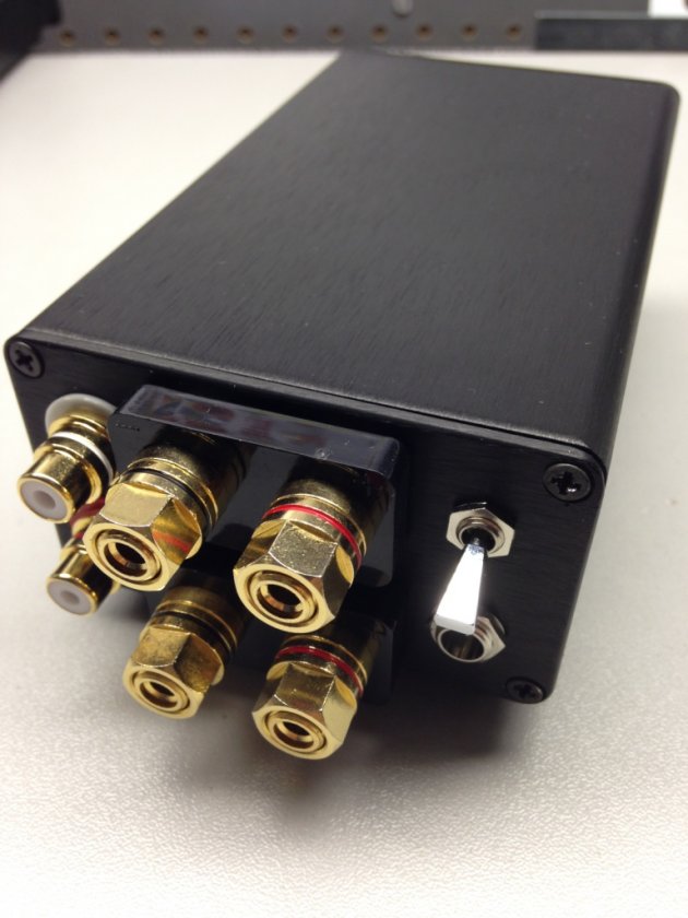

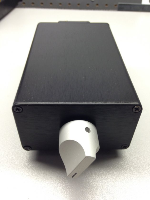

I just finished this build today, and the unit is playing now. It will take some time before everything settles in, but so far it sounds very promising.
It has the following components:
  • 2X 1,000uF / 25V Elna Silmic II electrolytic caps
  • 1X 2,200uF / 25V Panasonic FM electrolytic cap on thru-holes where the power supply is connected to the board
  • 4X Bourns 43-Type Ferrite beads from Digikey
  • 1X Panasonic EVJ 50kohm audio taper volume pot
  • 2X custom-made shielded hook-up wires using twisted pairs of 0.5mm Mundorf Silver-Gold solid core wire in Teflon tubing, next wrapped in Teflon tape, inserted into 12AWG Teflon thin wall tubing, covered with Tinned Copper braided shielding and finished in Techflex cable sleeving.
  • Vampire CM1F RCA connectors
  • Vampire CM-HEX 5-way binding posts
  • NKK SPST 6A power switch
  • Switchcraft 722A DC power connector, 2.1mm x 5.5mm
  • Context Engineering split Aluminum enclosure, black anodized, brushed surface finish
  • Kilo Silver-finish machined Aluminum knob from Digikey
The shielded wiring is pretty stiff after building it up, but I have no noise issues.
My next project is this Yuan Jing TPA3116D2 amp. I just ordered it yesterday.
http://www.yuan-jing.com/tpa3116-class-d-2-0-stereo-amplifier-board-50w-50w
The fun never ends.

I only share these photos and experiences, because I used to wonder how people got into DIY audio. Hopefully, this will help others as they try to extract the best performance from these bargain-priced amps. The parts including the amp board cost about $100. I bought the Mundorf Silver-Gold wire in bulk a while ago to make my own interconnect cables, and I still have a few feet left. The Tinned Copper braided shielding car from a local surplus electronics store along with the Techflex sleeving and some of the Teflon tubing. The most expensive parts are the binding posts and RCA connectors. I usually buy stuff like this when sellers like Parts Connexion and Sonic Craft have their sales. I did score on a bunch of Vampire CM1F RCA connectors from some guy on eBay.
If anyone wants to know the recipe for the shielded hookup wire, just PM me. I might use the same recipe to make shielded interconnects between my phono stage and line stage.
Anyway, I highly doubt that I could find an amp for $100 to $150 new that sounds this good. After learning DIY audio through modding Sonic Impact T-amps and Magnavox console tube amps, I can hardly bring myself to go into audio dealerships knowing how much their goods are marked up.
« Last Edit: 10 Feb 2014, 01:01 pm by rhing »

I only share these photos and experiences, because I used to wonder how people got into DIY audio. Hopefully, this will help others as they try to extract the best performance from these bargain-priced amps. The parts including the amp board cost about $100. I bought the Mundorf Silver-Gold wire in bulk a while ago to make my own interconnect cables, and I still have a few feet left. The Tinned Copper braided shielding car from a local surplus electronics store along with the Techflex sleeving and some of the Teflon tubing. The most expensive parts are the binding posts and RCA connectors. I usually buy stuff like this when sellers like Parts Connexion and Sonic Craft have their sales. I did score on a bunch if Vampire CM1F RCA connectors from some guy on eBay.
I highly doubt that I could find an amp for $100 new that sounds this good. After learning DIY audio through modding Sonic Impact T-amps and Magnavox console tube amps, I can hardly bring myself to go into audio dealerships knowing how much their goods are marked up.
 Is that a different (larger) box than you used previously? I know you mentioned you couldn't fit the Panasonic 2200uf cap in a previous build because it was too tall.
rhing
Re: TPA3110 and TPS3116 amps
« Reply #219 on: 10 Feb 2014, 01:23 pm »
Actually, it is the same Context Engineering P/N 3008 split body enclosure I used in my previous TPA3110 build. I had to use my Dremel tool to grind out some of the extruded ribs in the upper corner of the top half of the box to accommodate the height of the 2,200uF Panasonic FM. I lined the surrounding areas with plenty of masking tape to avoid scratching anything. A Dremel tool works wonders until you slip up and damage something else nearby. After I ground away a nice rounded clearance, I touched it up with a black Sharpie marker. My Dremel tool is actually a Chinese clone I bought from Harbor Freight for $20. For this DIY hobby, Harbor Freight is a great resource for very affordable power tools like a desktop drill press or table saw and hand tools like center punches.
I should also mention that Morgan Jones' "Building Valve Amplifiers" is an excellent and practical book for DIY construction techniques. Even though the book is about building tube audio amplifiers, many of the construction techniques and tools covered in the book can be used for all things audio electronics. His other book "Valve Amplifiers" has plenty of math for EE wannabes (like me), but it also has some great information about selecting capacitors and resistors, and other components.
BTW, thanks for sharing photos of your projects, even in raw form. I wish more people would share photos of their projects no matter what they look like. It helps others learn and inspires people to jump into DIY audio and try new things.
