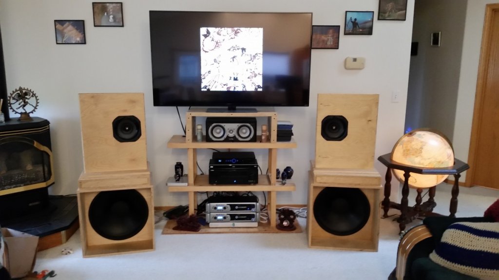

Oktyabr
  • Posts: 19
Re: Lets see your O.B. speakers....!
« Reply #175 on: 9 Dec 2015, 07:05 am »
My ugly (compared to some in this thread anyway!) 2-ways...  Based on MJK's work, these are Goldwood GW-1858's in H-Frames with Audio Nirvana Super 8's on top.  Between the two are thin ply boxes containing 50lbs of concrete patio block in each.  All the construction is 3/4" baltic birch ply (11 ply).  I used a miniDSP for quite awhile but the added hiss in the high end drove me crazy.  I recently picked up a pair of Crown XLS 1500 amps on close out sale and now run their internal 24db LR crossovers between the H-Frames and the Super 8's.  I've experimented a bit but tend to think the combo sounds best XO'd around 125Hz...  No sub is required in this room :)
They seem to blend pretty well.  According to the RTA plugin I run in Foobar2000, these kettle drums have significant energy into the 20Hz region (and probably lower).  Sorry for video and sound recording quality of my cell phone:
https://youtu.be/AIXetGn0x4Q
You dont walk in the room to show the sound nuance and room acoustics, this fixed camera looks like a direct recording from CD, not your speakers.
Nice cat BTW.
Nice cat BTW.
House was (is) a mess with the holidays going on.  Forgot to turn on the auto-video stabilization (don't really shoot much video with my phone) but here you go ;)
https://youtu.be/2IFg2BkSn-o
And that cat?!?!  "Go with a single big port", she said, "not some skinny pipe.", she said...
And I was just about to follow her advice trying cat litter in the bottom as a quick and easy way to add some mass...
Now its OK, thanks for posting.
The woffer is nice integrated seems.
