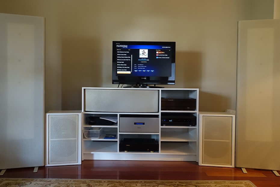

« Reply #238 on: 9 Dec 2016, 08:31 pm »
I choose to build the W-Frame OB for reduced height and appearance.
I doubled 3/4" maple ply on the sides per Danny's suggestion.
I added Magnepan light fabric to unify the appearance.
Still need to build european frameless doors.
Frameless cabinet is over 26" deep and has a recessed back for wire storage and ventilation.
LG OLED 65B6P is on backorder
  • Posts: 21486
Re: Lets see your O.B. speakers....!
« Reply #239 on: 10 Dec 2016, 05:31 am »
Superb room, very suited to OB speakers.
Congratulations
« Last Edit: 10 Dec 2016, 06:43 am by FullRangeMan »
