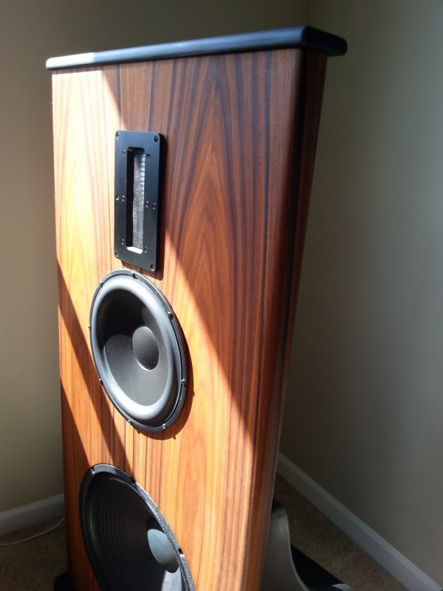

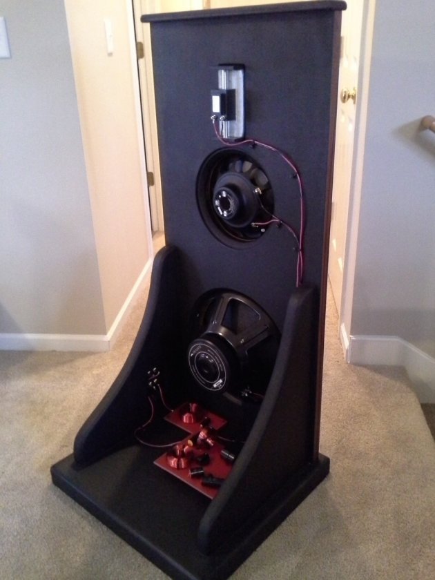

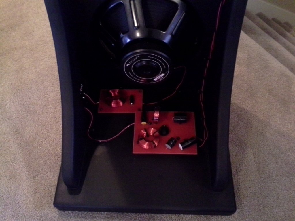

This is a pair a I made, simple 1.5" MDF, sprayed with automotive flat black and the fronts are veneered with Rosewood and finished with Linseed Oil. So everything is very soft. They are heavy. The base is 2.25" thick, the wings/braces are 1.5" thick. I only put the wings/braces on for support, I think it helps in sound improvement, by improving the structures weight a stability.
nickd
Re: Lets see your O.B. speakers....!
« Reply #110 on: 29 May 2015, 09:30 pm »
Those are NICE Bladesmith!
I imagine the wings are functional and also help support the lower bass (Cancellation loss). Almost 1/2 of an "H frame"

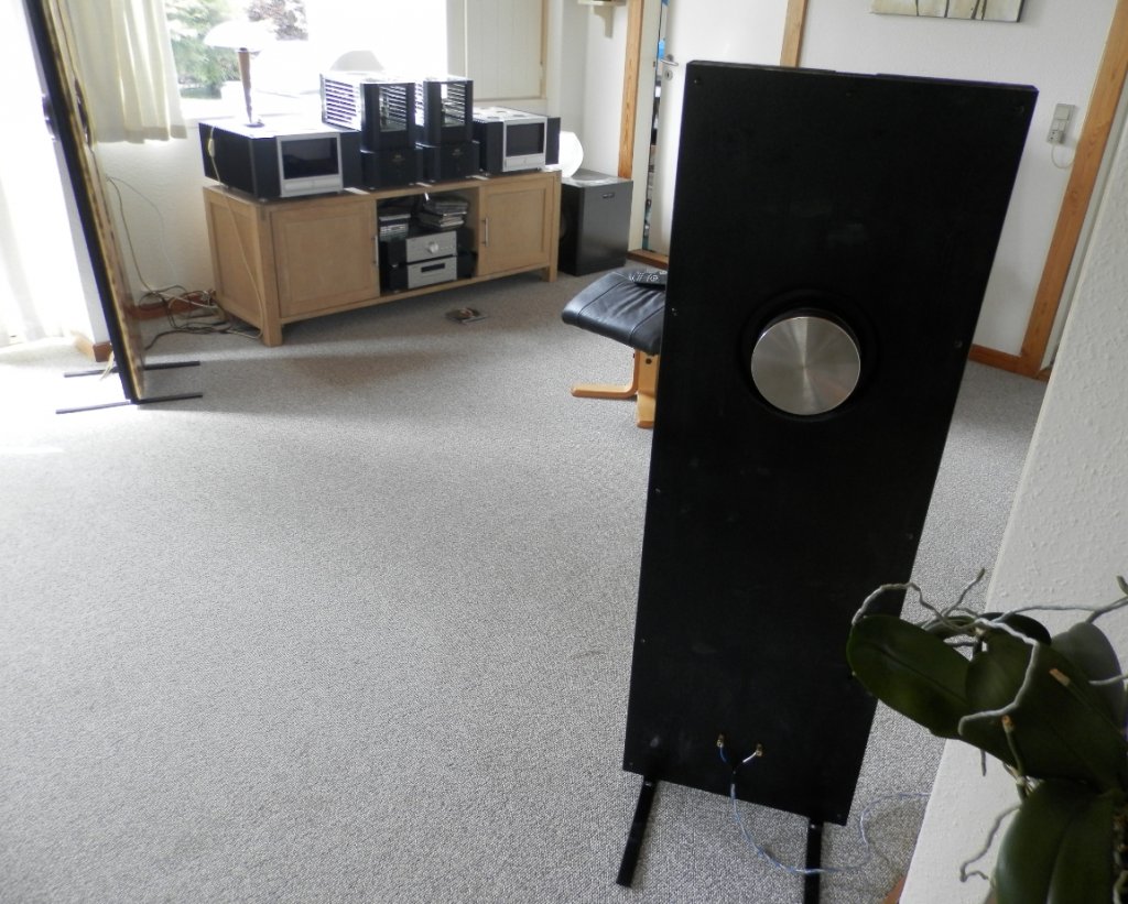

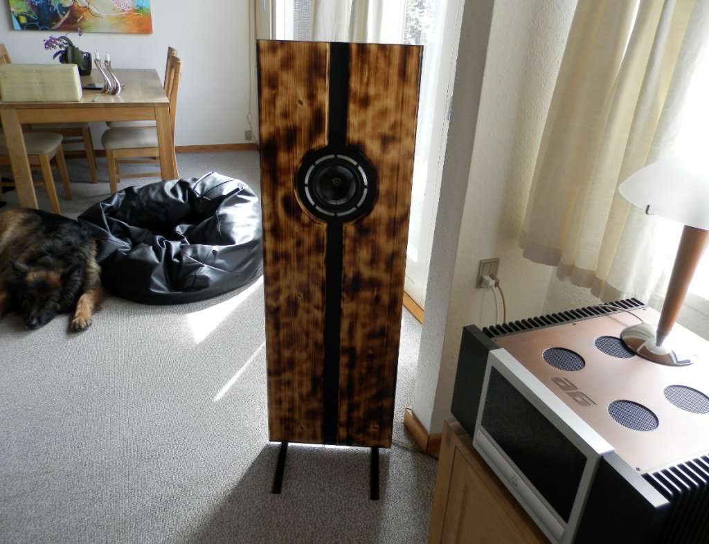

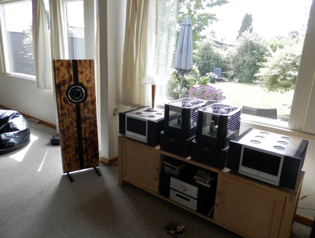

Hi there,
These are my OB, I am using a full range unit of my own design, special designed for OB.. I use a sub for frequency’s below 80 Hz.
  • Posts: 21831
« Reply #113 on: 30 Jul 2015, 01:12 pm »
 :dunno:
Bob in St. Louis
  • Posts: 13276
« Reply #114 on: 30 Jul 2015, 01:18 pm »
They don't sound good like that. ^^^^
Mmaxed
  • Posts: 52
« Reply #115 on: 4 Aug 2015, 07:07 pm »
A little flat sounding?

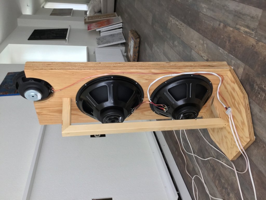

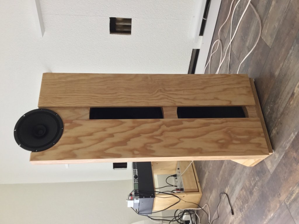

Betsy and Alphas
Sorry for the pics being sideways.....
