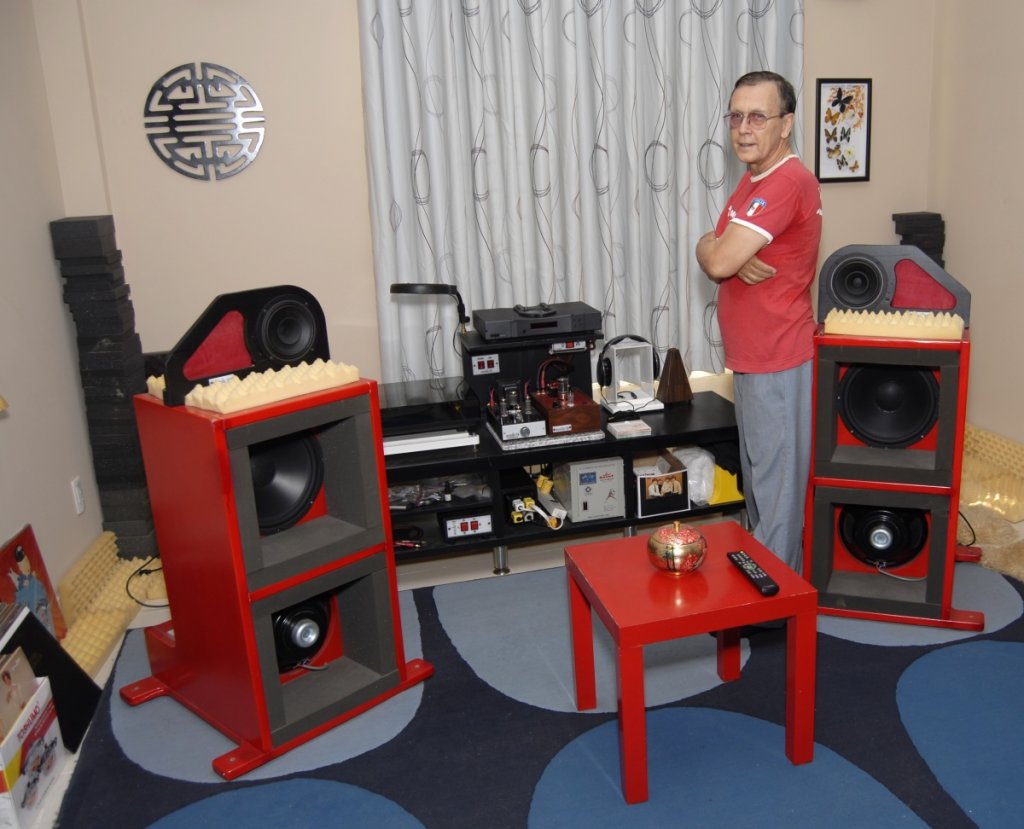

Guy 13
Re: Lets see your O.B. speakers....!
« Reply #121 on: 30 Oct 2015, 01:34 am »
Hi zimmer64,
here they are in the right position.
By the way, I like the configuration of your Open Baffle.
I wonder of your way is better than my mine ?
Cannot post a picture of mine,
maybe later, the Internet connection is too slow right now.
Guy 13

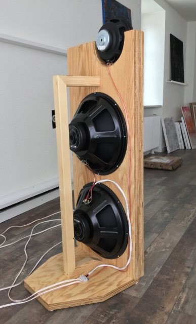

zimmer64
  • Posts: 12
    • My blog
« Reply #122 on: 30 Oct 2015, 07:37 am »
@Guy 13: Thanks for turning the pictures. I could not do this on the iPad
@ebag4: They sound pretty good.
The slot loading lowers the FS a bit. They produce lots of bass output, no sub woofers required. I am using a Behringer DCX 2496 as crossover and 2 gain clones for active amplification. I crossed over at 200Hz 6dB Butterworth high pass and 24 dB LR low pass. Betsy needs quite some EQ in the treble region. I will either add a dipole tweeter crossed between 3-4 Khz and make it a 3 way design or replace Betsy with the Tangband W8-1772.

Guy 13
« Reply #128 on: 3 Nov 2015, 09:52 pm »
Hi all,
maybe next year,
I will be reunited with my beloved sound system
and if I can find a few boards of MDF
I will do some experimenting
with the four extra 12 inches Eminence Acoustinator woofers
driven by my GR Research 250 watts plate amplifiers.
I might try the U frame configuration and compare them side by side
with my H frame enclosures ????
I wonder if any AudioCircle members did that side by side comparaison.
Guy 13
Guy 13
« Reply #129 on: 3 Nov 2015, 09:54 pm »
Hi zimmer64,
it's too bad Omega does not sell anymore his Omega 7F.  :(
I wonder how it would compare to the Betsy or TangBand W8-1772 ?????
Guy 13
zimmer64
  • Posts: 12
    • My blog
« Reply #130 on: 4 Nov 2015, 06:31 pm »
Hi zimmer64,
Guy 13
Hi,
I now ordered a tweeter (BG Neo-3) and will report back as soon as it is installed.
Michael
