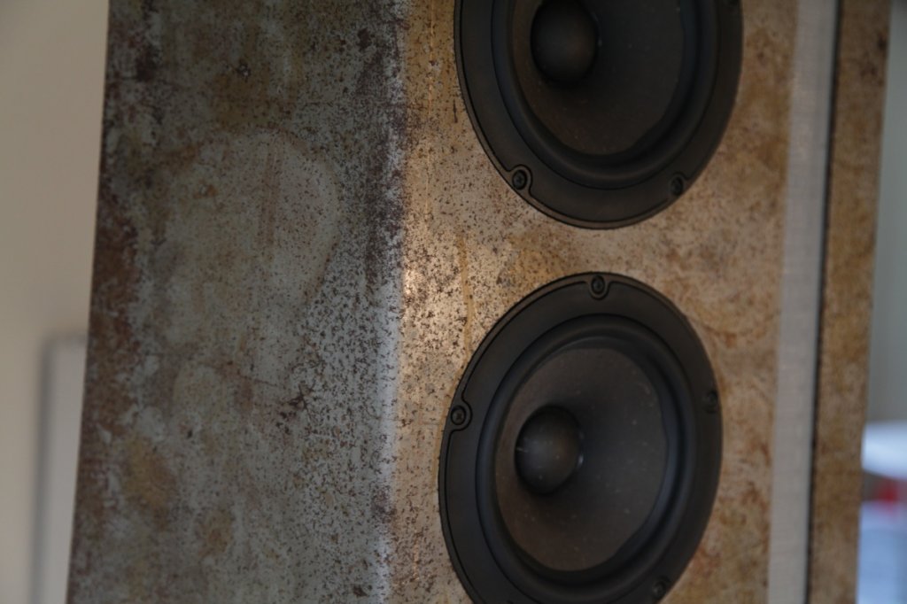

Great looking arrays. Any chance we could see some close-ups of the metal finishing? I've played around with chemical patinas and am always curious to see what others have done.
Hi Peter.
I managed to shoot a few pic the other day.
I used acetic acid mixed in sand and spread it over the surface of the (non-stainless) steel.
The Priest
Don_S
Re: Lets see your O.B. speakers....!
« Reply #141 on: 7 Nov 2015, 01:28 am »
Acetic acid and sand.  :thumb: I had never heard of that treatment. What strength acetic acid did you use?
I have to say I like the results.  The lack of nasty inorganic acids (sulfuric, nitric, or hydrochloric) to dispose of is also a big bonus.
ThePriest
  • Posts: 54
  • 101010 = 2A
« Reply #142 on: 7 Nov 2015, 08:45 am »
I used normal consumer strenght 32% acid, bought in the local super market.
I poured sand on to the steel, acid in the sand, and mixed the two things with a gloved hand.
After two or three days, it had some beautiful orange colours in the top rusted layer (flakes).
Unfortunately, these came off when brushed.
I had to brush the surface to keep it the rust from falling off in doors, and on top of it, I have given it a layer of bees wax.
The Priest

Don_S
« Reply #145 on: 7 Nov 2015, 03:27 pm »
The Priest,
Did you have to neutralize the acid or just rinse thoroughly.  I would think rinsing would be adequate.
Did brushing off the rust leave a textured surface?  I can't quite tell from the pictures but the darker spots look like pits.
ThePriest
  • Posts: 54
  • 101010 = 2A
« Reply #146 on: 7 Nov 2015, 03:56 pm »
I don't think I neutralized it, the acid was not that strong.
I rinsed it with water and let it dry before I added the bees wax.
The surface is slightly textured, but whether it is pits or 'bubbles' from the rust is difficult to tell.
If they are pits, they are not very deep at least.
Maybe a Braille reader will be able to tell   :D
