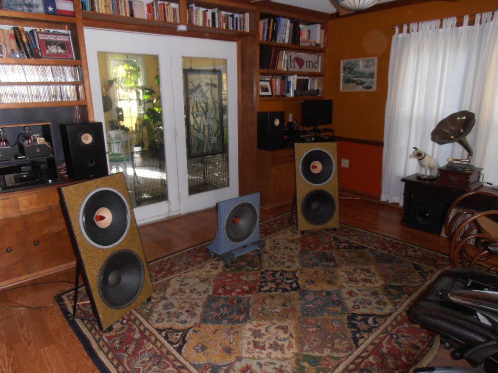

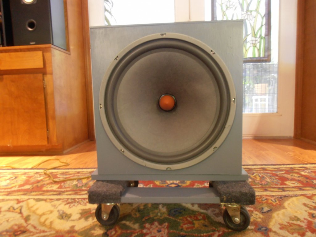

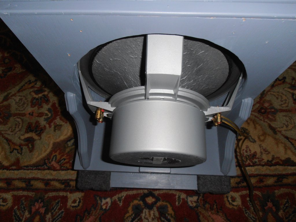

Poultrygeist
Re: Lets see your O.B. speakers....!
« Reply #628 on: 9 Nov 2025, 09:46 am »
I recently added a single Lii Audio W-15 to augment the bass and couldn't be happier with the results. The W-15 is so heavy it requires its own baffle as well as wheels to move it around.

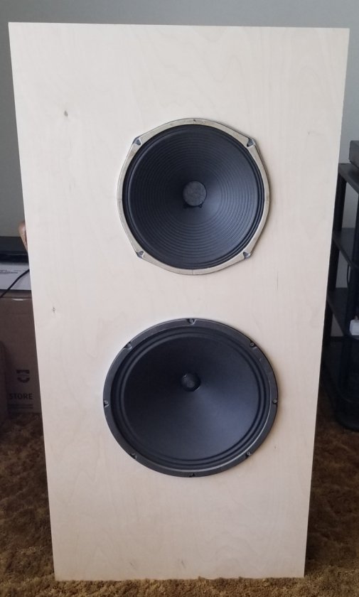

« Reply #634 on: 13 Feb 2026, 04:43 pm »
4' x 2' x 3/4" birch plywood baffles - mounting holes cut yesterday evening - no bracing yet - no legs/support - held up by an ottoman (L) and a DR table chair (R) so I can listen/evaluate.
So far I am impressed with the bass from these Zenith 49CZ903's (FS is @ 52Hz - some 30+ Hz lower than the popular 852's) with the music I mostly listen to (Brubeck, Petersen, Webster, etc, Mozart, Paganini, etc).
I was listening to a Focal demo disc at louder SPL's than I realized (louder than I normally listen) when a choral piece (Verdi track #14) made these drivers fall apart*, everything before it was pretty good, and the choral piece was much better after lowering the volume control some.
If you like complex music fairly loud these are not for you. Hopefully you already knew that.
* part of the problem may have been the 1~2 watt inexpensive triode strapped JBH 6P14P tube amplifier I was using was past its limit.
* Edit: A 7 watt SET did much better playing the track mentioned above.

« Reply #635 on: 8 Mar 2026, 10:13 pm »
A pair of Jensen P15RJ alnico drivers have joined the fun.

« Reply #636 on: 9 Mar 2026, 06:03 pm »
My Zenith 49CZ852 are basically sitting on similar area of similar baffle, and I do have 15" woofers in house but have been hesitant to add the woofers to same baffle due to the worry the woofer vibrations will detract from the famous midrange purity.
How do you have the two drivers crossed over and any diminishment of midrange qualities?
opnly bafld
« Reply #637 on: 10 Mar 2026, 01:48 pm »
The Jensen's are excellent also and play fairly high, enough so that I was listening to them just sitting on the floor when I first got them and started thinking about using them separately with a tweeter.
I just cut the baffles late Sunday afternoon (writing this early Tuesday morning) and added the 15's so I need more free time to evaluate, but will likely just use a coil and another amplifier for the Jensen's.
The Zenith's will be used connected directly to the amplifier. Lots of bracing and legs/feet and finish yet to be done. Listening at what most I know call loud is not something I do, never did even when young.
 :nono: I was eager to listen Sunday evening and because I was curious what the paralleled DRC would be I just hooked them up paralleled/no filter (something I would normally smh at  :duh: ) and also they have the same sensitivity. They actually sound pretty good fullrange together and when I put my head by the baffle between the drivers the treble sounds like it's coming from the Zenith. Unfortunately using them in parallel with a coil on the Jensen will likely lower it's sensitivity too much (-2 dBs?) to be effective and will require bi-amping. Surprisingly siting here listening and posting it sounds like the Zenith are playing alone with a little bass boost added.
The Jensen (advertised as 5.7 DCR by seller - actually 4  :( ) and the Zenith in parallel are a nominal load of @3 ohms, my tube amplifier isn't concerned.
« Last Edit: 11 Mar 2026, 02:54 pm by opnly bafld »
« Reply #639 on: 10 Mar 2026, 06:00 pm »
Mine are R with J, meaning special design, they came out of a Magnavox console (many had 4 ohm loads and OPTs to match).
'61 date code, Alnico - P first letter, ~6 ohms, Fs ~60 Hz, ~95 dB sensitivity
What little info I could find on P15R and RJ they are great drivers for open back and OB 2 ways.
