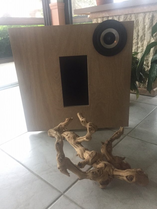

Jordan Eikona 2 plus slot loaded bass driver in compact 20" baffle. Purpose built all passive crossover with low frequency equalization, BSC, and notch filter on the low frequency driver only.

Ouch equalization, BSC, and notch filter all in one speaker is too much for me.

On the helper woofer only. The full range driver has no crossover.

There is any advantage on the usual Alpha or Beta?

By slot loading the woofer, the front & rear waves become less symmetrical as frequencies rise. This affects cancellation and, at least in my design, is an integral part of the woofer's crossover.

Looks interesting, I remembered Karlsonator.

I know you guys are anti-crossover for your full range drivers, but I have yet to measure one that didn't need a corrective circuit for either baffle step loss, a rising response, or notching out peaks up top. And those problems typically present a far worse response and listening experience any any effects that the filters may have, especially when using high quality parts.
