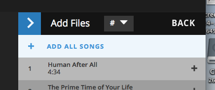

Hi all,
A few questions regarding Manic Moose:
1. not all of my album covers are showing in album view - how do I rectify this ?
2. how do I add radio stations to the playlist ?
3. within Media, it appears that the mouse arrow needs to be at the top of the file selection and not in general box areas - can this be changed,
Thanks all...

« Reply #425 on: 28 Mar 2014, 08:09 pm »
Hi all,
Thanks all...
Hello,
We have yet to implement any method to directly select cover art to use; something is coming eventually.  I'm the mean time you can clear the .albums folder on your scratch drive and before building the album view again, enter settings (in media player) and you can prioritize 3 file names to use.
It's a little tricky because we also have a button for
Adding everything within the folder (the plus symbol) as well.  I can take another look it.
Cheers
Chris

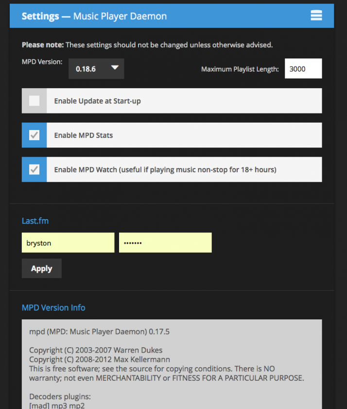

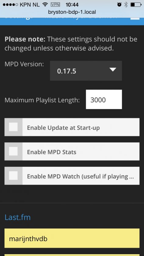

Re: Manic Moose (S2) - BDP's third major firmware release
« Reply #426 on: 29 Mar 2014, 10:28 am »
HI Chris,
i see a top40 in the playlist list, but clicking it does nothing.
your terminal command gives this:
with the 2 screendump i wanted to show that MM on desktop and Mobile have different result and feedback for  the same BDP status. Might have a look why this occurs, and correct?
btw, MM user feedback tends to be oriented on Pop/song oriented users. (top40, songs, etc etc) while many users, and i am one of them, have other libraries as well. Why not try to look for some terms that come close to those too? If you'd use the word track instead of song, it would come closer to the classical library of many a user. Add full album, instead of add all songs,  while the majority of these recordings is not song oriented at all
etc etc.. just a thought, no big deal, would be great  :thumb:
Marius

Marius
« Reply #427 on: 29 Mar 2014, 06:34 pm »

Marius
« Reply #430 on: 29 Mar 2014, 10:40 pm »
Great,
have a good show in Montreal. Looking forward to your fix and change of the DNS option.
the screenshot was not an inconsistency, only an example of the 'Song' oriented interface.
o wait, i now realise you're replying to several posts...
the inconsistency in the post before is clear:
it shows
mod 18.6 vs 17.5,
enable mpd watch and mpd stats, vs none selected,
last.fm is still on bryston, vs the other with  my login displayed correctly . All at the same time connected to the BDP.
they both are right and wrong on some.....
Marius
